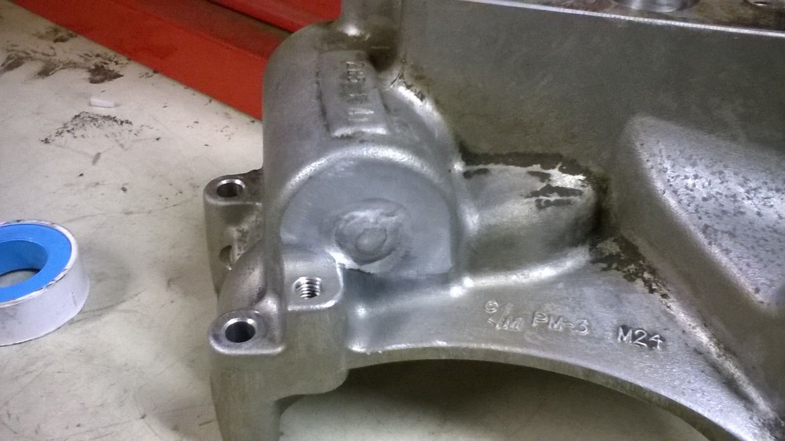

Night time / Westcoat audience.... Gutted ebpv
Butterfly gone
WW1

Ready for loctite, then hit hose co. for braided lines, once bowl is installed Ready for 4x fuel felivery
No spaghetti factory
Cleaning ur up
Be gone oil
Purdy

plenum inserts(clay had box to me within 2 days)
gutted pedestal
ww1 wheel
gutted exhaust outlet

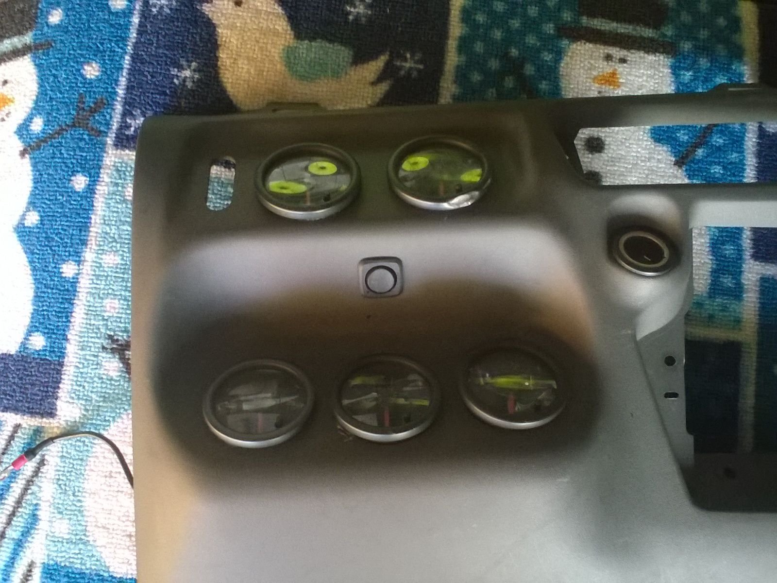

Here's progress and parts waiting for install. Minus the VSM b.s. that I was hit with, its coming along New WP and billet tstat
CCV mod
New fan, clutch, idler and tensioner
Double din AND black vents..the grey looked horrible
