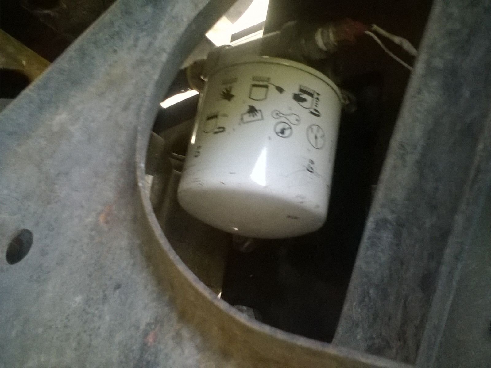

Dropped the pan, installed new filter, by pass filter in bumper, 6.0 cooler and few other goodies.. Hidden zoodad
Straight shot
Jumper wire
Tah-dah

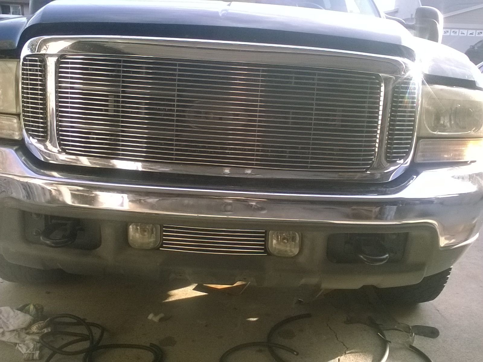

Thanks medic 👍...its my therapy 😜. 6.0 installed, trans bypass installed, grille and about 1ft of 3/8 tubing off cooler, all hardlines👍 Lines off filter Flow filter 6.oh Facelift

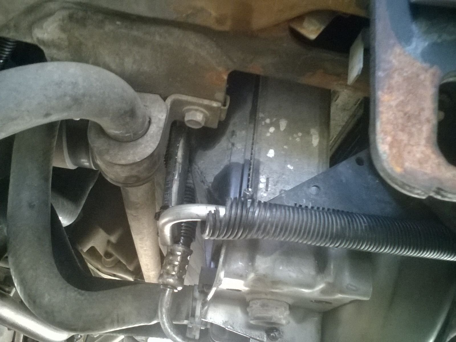

rd#2 pics from above
Viewing pleasure...😊 now, Tim to fill/flush Say something about this photo
Going to filter
Leaving filter
Connected at return line

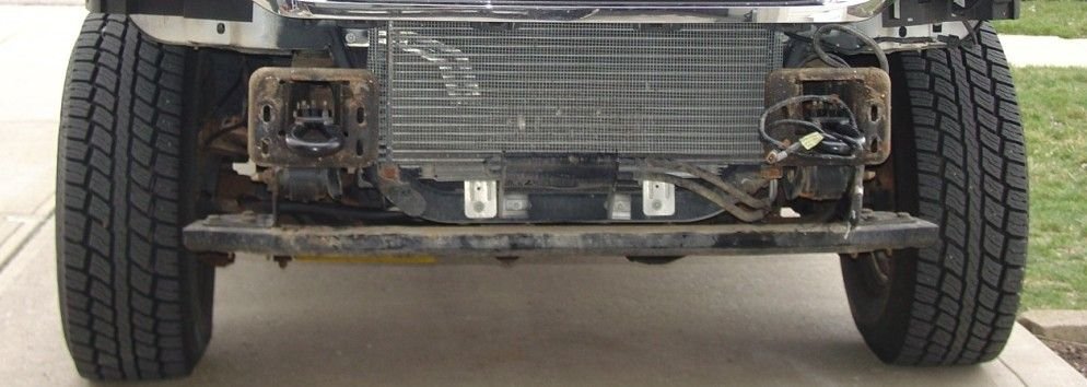

valance/crash bar
Here ya go... That bar, below cooler
Hidden by this valance

Viewing pleasure...😊 Say something about this photo
OK, you should have cut the zip tie down after the install.

I call that the Critter catcher, but you can also call it the Honda bar. It was installed to grab the lower elevation bumper or car parts and keep the truck from riding up and over another (smaller) vehicle during a collision.
