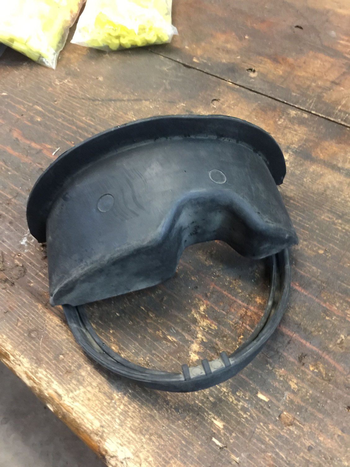

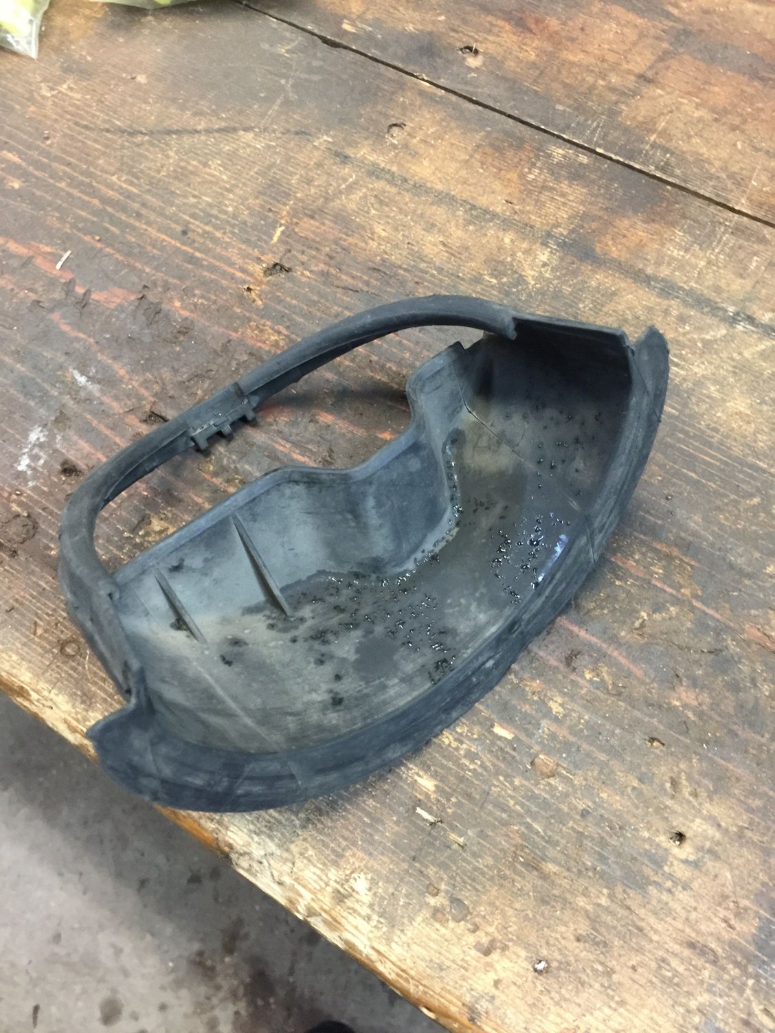

Where does this fit?
I know it goes in the air box. But I must have not put it in right last time and keep getting the check air filter warning. Can somebody tell me how it's supposed to be positioned in the air box?

thats part of the air filter system.
you put the flter into the lower shell, then that piece goes on the end closer to you, then the top piece of the shell.

That makes since. Does it like attach on the top lip off the bottom half then? Or does it just fit in there somewhere?

lip of the bottom half
