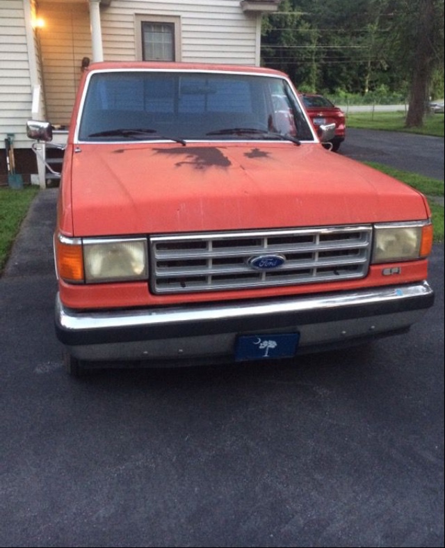

I picked this truck up at the beginning of the year in SC, and have been having trouble deciding what to do with it. After blowing the headgasket a couple weeks ago I decided I better keep it and fix it up
I bought it from the original owner's son, and he could tell me all the work they had done to it. And all the abuse the truck took from the son growing up. From burning up clutches to spring break beer runs it somehow survived! It was pretty neat to have some history on the truck.
Anyway It's a 1987 F150 XLT Lariat 2wd with a 300 and a 4spd (4th is OD) and 204k miles. It's in awesome condition. 99% rust free and has cruise control (works perfect) and A/C that needs work.
I've had quite a few 60's-70's Ford trucks, but this was my first older Ford with a computer. So with apprehension and excitement I dived in headfirst.

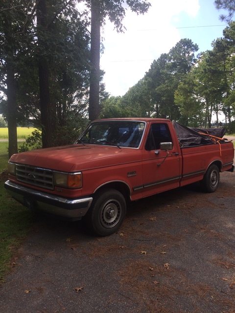

When I picked the truck up it had an interesting rim/tire choice....My buddy and I somehow crammed those big tires on my tow dolly and dragged it home.
After I got it in running condition I put a set of stock tires on and started to drive it everyday.

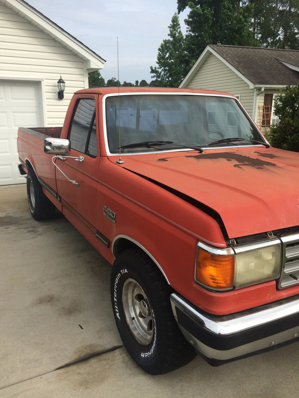

My wife and I decided to move back to NY from SC so I loaded up the 87 for the trek north and it didn't skip a beat...
Here's a few more pics of it.
Missing some trim...

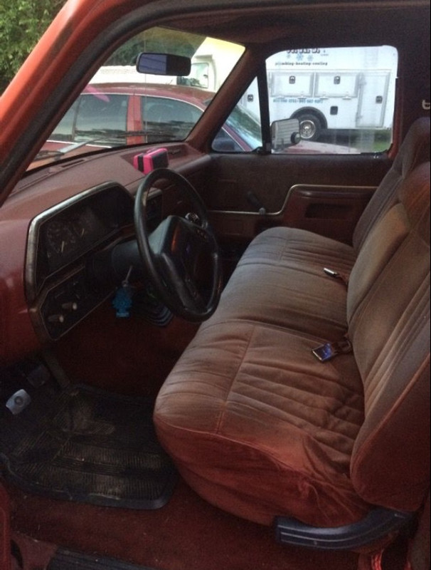

Interior...nice stylish red...o and what were they thinking with those cupholders in the arm rest? They're pretty much just for show.
It was for back when pop cans were "normal" sized. Not SUPERSIZED big gulps....... I used to have a couple of those old plastic door hanging style pop can holders. Only problem is pop cans aren't that size anymore. They are like 1/4" bigger in diameter and won't fit. Why? Just because.

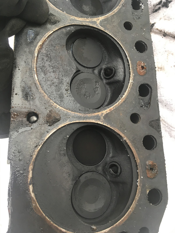

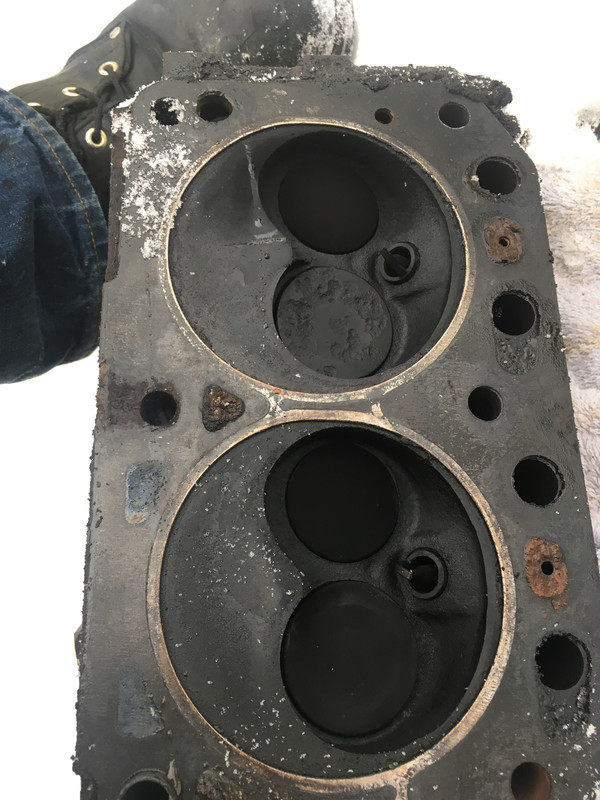

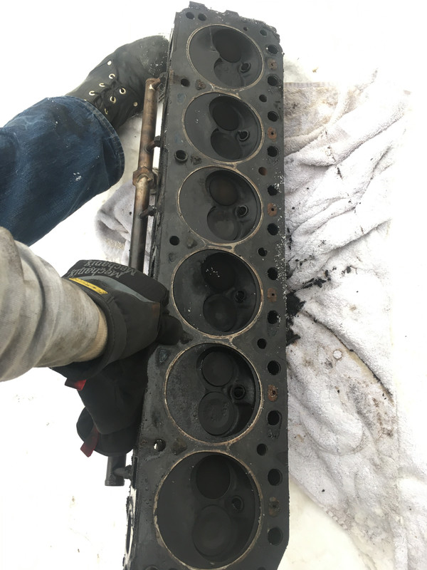

Got the head pulled today on a nice cool NY winter day. Sure made me wish it was carbureted
Anyway as you can see the head was not that great. Cylinders 2 and 5 need new intake valves, although it has been 204k. Not sure why those are the only ones with detonation...
5+6
1+2
After all those miles the cylinders don’t look bad. Can’t even feel any ridges on the metal. Nothing like a 300
The injectors need to be cleaned up. Truck definitely needed a new valve cover; oil was leaking everywhere.
Plan is to drop the head off at a machine shop, make sure it’s flat, and have it cleaned. Put it back in and keep on trucking

Well my cylinder head is shot. Upon closer inspection I noticed 3 cracks. It got cooked pretty good. Now I gotta check out the pistons closer to make sure they aren't shot now too. Might be getting a new engine now instead of just a head....

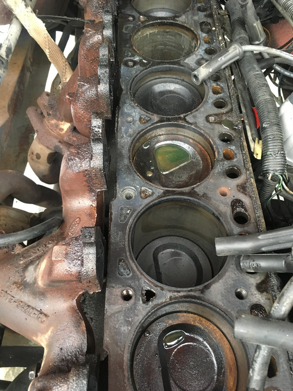

Picked up a 300 out of a wrecked 94 F150. Popped the head off and got it ready for reassembly in my ‘87. In my brilliance I decided to do the head gasket job on a nice 5 degree day
The coolant in my oil had gelled up and took forever to heat up and drain. Once I finally got it out and put new oil and coolant in, the truck wouldn’t turn over because the start was frozen. So looks like I’ll be waiting for a warmer day to see if I got it fixed...
