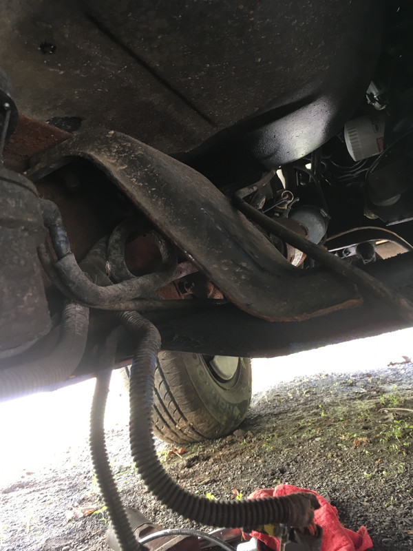

#1 Transmission support gussets. I had to unbolt the transmission support for the gussets then pry up on them to knock to support out of the way. Once the support was out of the way then I was able to get at the bolts on the top of the gussets so that I could remove the gussets. The gussets bolts stayed in my frame because the cab didn't allot me to get them out. I also did not reuse the gussets.
#2 Relocating the transmission support. The supports on the Mazda transmission are approx 6" farther back than the ones on the T170. Drilling holes in the frame and making sure they lined up was difficult for me. But that may have mostly been due to the fact that I was doing this job in a gravel driveway with the truck on the ground.

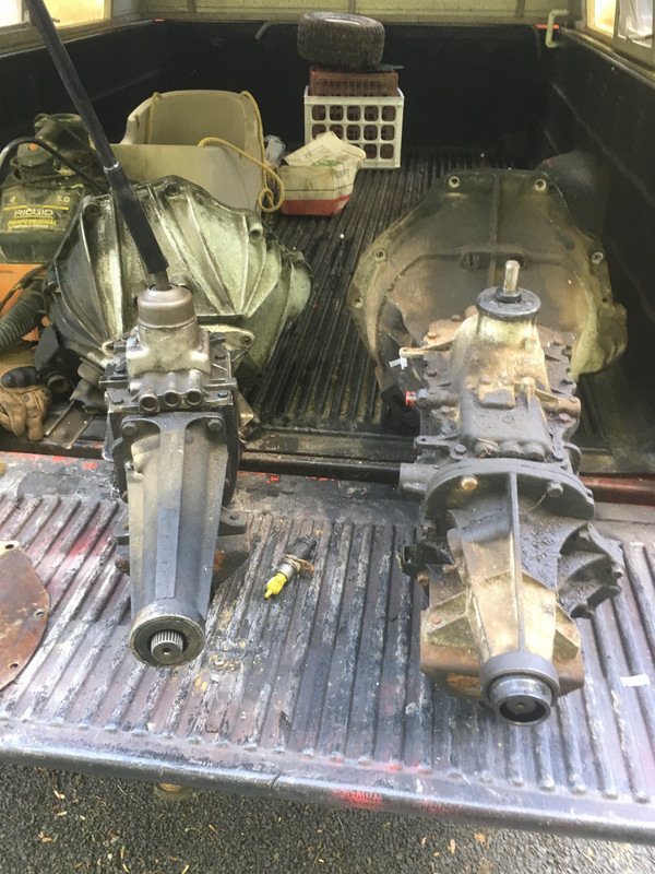

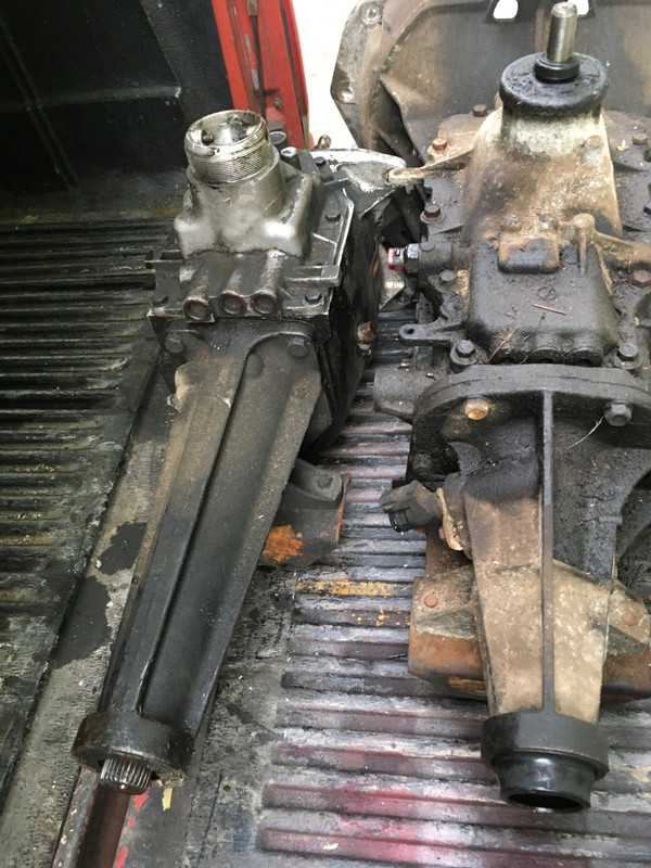

Other than those two issues it was a pretty standard transmission replacement. Here's some other pics I took.
Transmissions next to each other

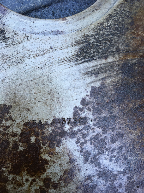

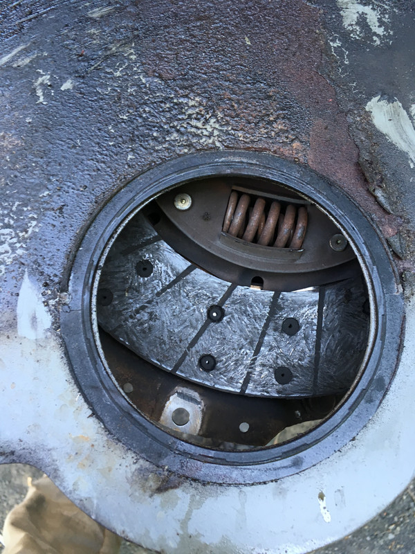

My original flexplate had the '65 part number on it which I thought was interesting, but the flexplate that came with the Mazda had the '88 part number. The '88 flexplate also had a gasket in the flexplate (second pic).

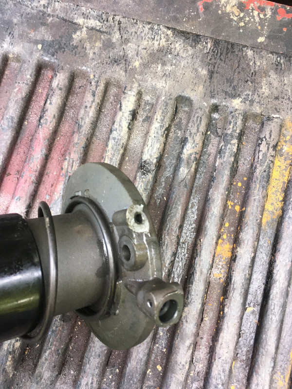

Finally got around to putting another slave in. Luckily I was able to slide the trans back a bit and swap the cylinder out rather easily.
You can see where the 1st slave sheared.
