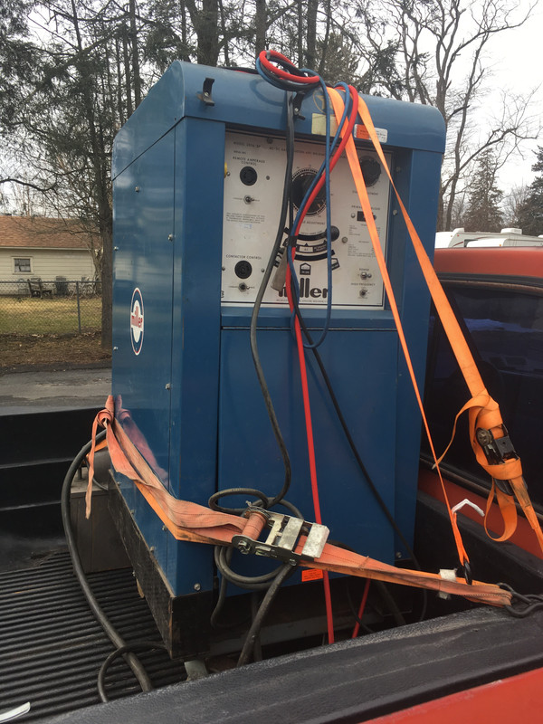

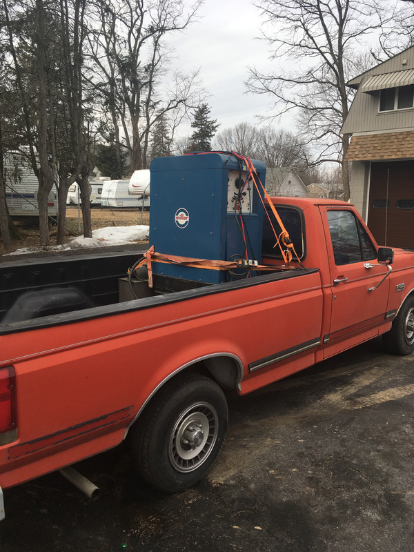

The tuck had its first big test today since the head gasket. 300 miles trip to go get this old behemoth of a welder. Truck ran great and I gained about 1.5 mpgs since I changed back to stock exhaust over the straight pipe.

Yea I hear that. Most of the welders I saw were 3 phase old clunkers that people wanted modern welder pricing for and expected you to load (this welder weighs 750 pounds).
I picked up this Miller 330 for about $800. Came with cooler, pedal, 25 ft tig torch, is single phase and it does AC/DC. The guy even loaded it for me. It’s more welder than I’ll ever need. Took me a while to find it.
