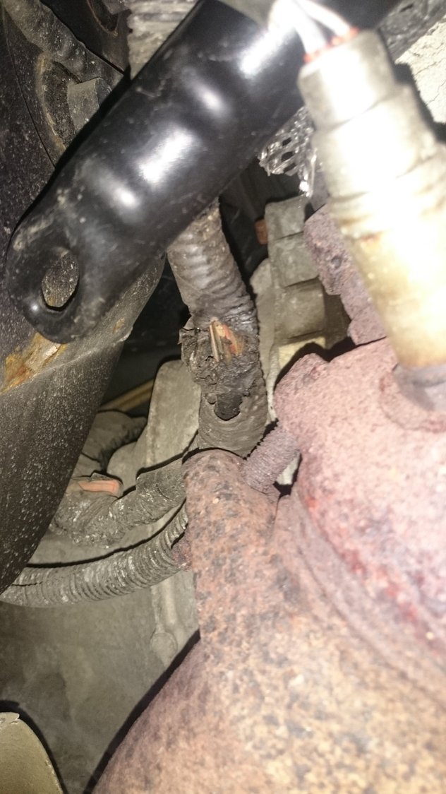

Originally Posted by Bluegrass 7
My bet is a harness has come apart or burnt on exhaust,
Simple as that.
Good luck.
How right you are...
now what? That's not easy to even see in there... Off to search forum...
Good deal.
I was a little concerned you was not getting on board with the logic according to your next reply..
Good luck.
that portion of the wiring harness comes from a large Grey plug at the firewall, and goes over to the manual transmission, and then farther back. I fixed the problem in the picture. But I fear that is not all that is wrong with it, it has a section full of taped wire nuts.
I would like to replace this wiring harness. can these be purchased online or do I need to go to a Ford dealer? How do I find a part#? What's it called?
