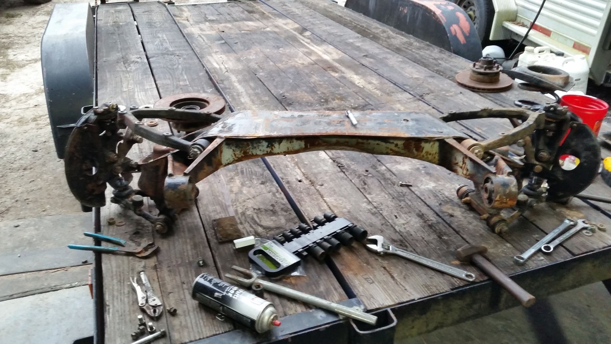

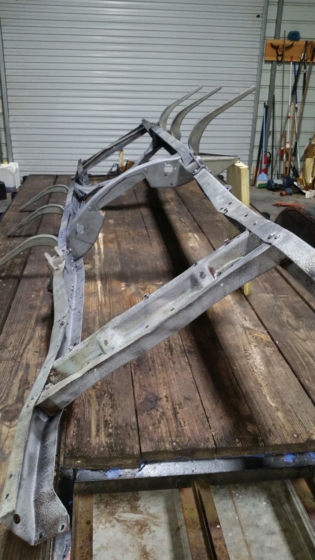

Well, I finally got the frame back from blasting. Their blaster broke so it took a little longer. I also got the Jag IFS torn completely apart and started cleanup. I am not starting a build thread yet because I have no idea when I will get back on the project with enough time to actually accomplish something.
After a quick clean I wiped the frame down with phosphoric acid to hopefully delay flash rust for a while. I didn't see the need to paint the frame only to have to grind it back off in areas where I will need to do some welding.
phosphoric acid treated
This is completely torn apart now.
