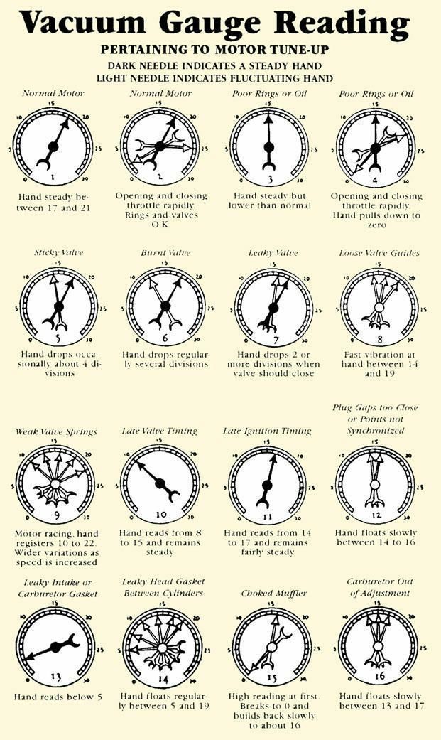

Vacuum gauges are invaluable. You can fine tune carburetor settings and ignition timing, check for vacuum leaks, and check for burned valves and valve lash that's too tight. And they are cheap. Some even have a fuel pump pressure scale. Don't get the type for dash mounting because they are dampened, get the large 3" hand-held dial type with various hose connections included.

A vacuum gauge is very useful in diagnosing problems on these old trucks. Here is a great old school chart.
