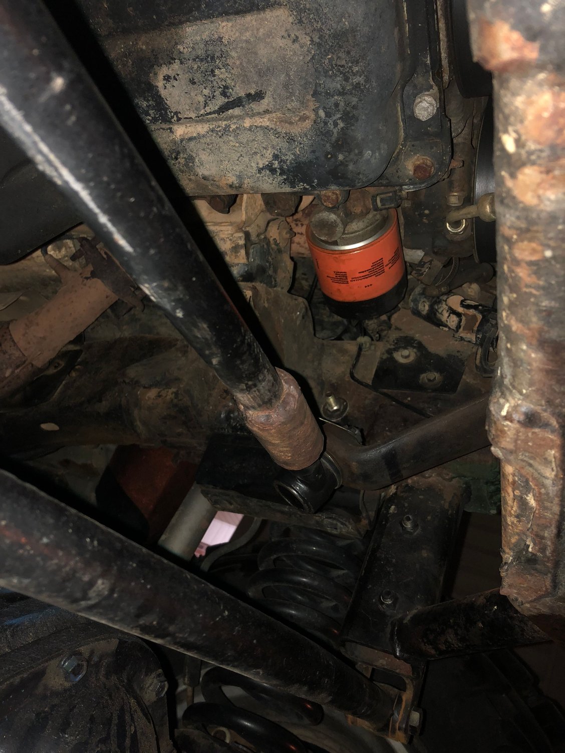

i have a 03 f150 solid axle swapped with a axle from a 78 150. Has death wobble very bad. When I turn the steering wheel my drag link makes the tie rod rotate back and fourth. Is there anyway to solve this issue? I’ll post pictures of my setup. Thanks

solid axle and lifted... It looks like the axle hangs on the two coil springs.. Maybe im missing something, but the wheels / tie rods / axle all seem to be tied together, but look like a lot of "FLOAT" between the axle and the frame. I realize you LIFTED the original 1978 axle and had to make mods, but im not sure I see enough restraint between the axle and the frame, especially when you turn and get body roll, side torque... ?

how much is the front end LIFT ?

Yes it does when I turn the truck lifts up. What should it looks like. What do I need lol

All together around 12
