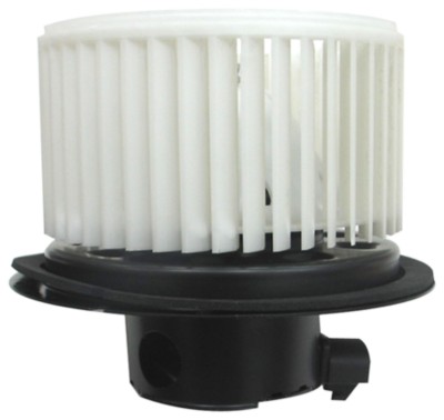

My Ex was doing the same thing. I replaced the AC blower motor with a new one from NAPA auto parts and it works like a champ now. The swap out was fairly simple. There is a few youtube videos that explain how to do it.
Blower Motor - AC / Heater
PART #:BK 6552470
PRODUCT LINE:Balkamp
VEHICLE: 2001 Ford Truck Excursion
RESERVATION
$62.99 /Each
