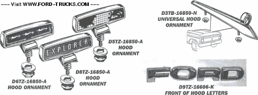

"So-called" D3TB-16850-N (there is no such number or hood ornament, it's a figment of a repro parts sellers imagination) is actually C2DZ-16178-A .. Front Fender Emblem for 1962/63 Falcon!
Pic: Scroll down to 16850.
Parts catalog doesn't say, but O-S-I (Obsolete-Supercede-Interchange) Catalog does:
D3AZ-16850-A
& B were replaced by D7OZ-15850-A that you can see was replaced by D8BZ-16850-A
Edit: D8BZ-16850-A was replaced in 1982 with E2BZ-16850-A and in 1983 with E3TZ-16850-A
D5TZ-16850-A was replaced by D6TZ-16850-B that you can see was replaced by D8TZ-16850-A

The so called D3TB-16850-N is not a hood ornament and never was. It's actually the front fender emblem for a 1962/63 Falcon.
An enterprising repro parts seller discovered it fits the contour of the 1973/79 F100/350 & 1978/79 Bronco hood. It's actually illegal to install it on a hood, because it's not "spring loaded."
What year truck do you want the D8BZ-16850-A hood ornament for?
The reason I ask is, this number was replaced in 1982 and again in 1983.
I edited post #33 to reflect this.
FoMoCo is infamous for replacing/updating part numbers almost as often as women change their minds!

D8BZ-16850-A .. Hood Ornament 'squarish' shaped with Wreath & 3 Lions / Replaced
1978/81 F100/350 & Bronco / 1978/81 Fairmont.
1982: D8BZ-16850-A was replaced by E2BZ-16850-A = 1982 F100/350, Bronco & Fairmont and previous year vehicles.
1983: E2BZ-16850-A was replaced by E3TZ-16850-A = 1983 Fairmont / 1983/86 F100/350 & Bronco / 1984/88 Ranger & Bronco II and previous year vehicles.
Note: D6TZ-16850-A rectangular shape with Wreath & 3 Lions was also used on 1976/79 F100/350 & Bronco (pic in post #31).
Which one of these puppies would you like?

I'll bet it came with something like the D6TZ-16850-A, with the three lions or whatever they are, but you never know. Sounds like it didn't come with the C2DZ-16178-A, and if you see no evidence of there having been two holes, it probably didn't.
