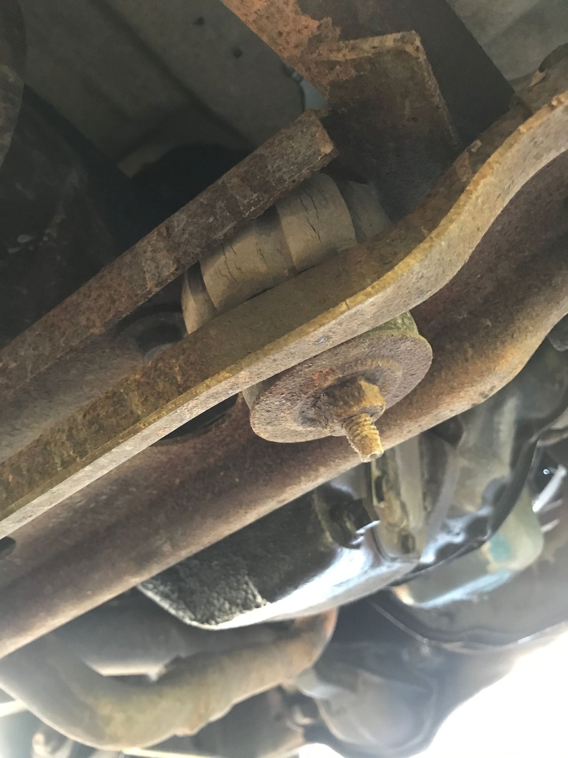

I have a 1982 f-150 and I went to get a new tranny mount the ones they show at the parts store don't match at all can someone please point me in the right direction to get the ?bushings? I need?

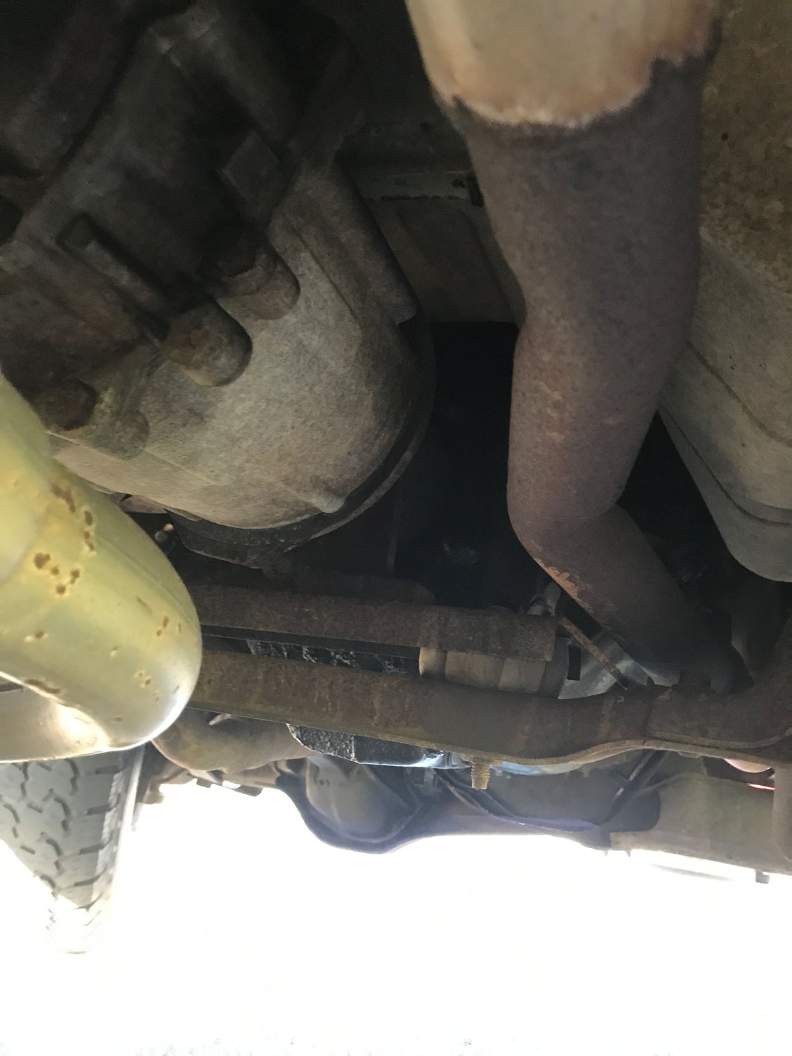

Could you take that picture back a little bit to see just where that rubber is.

It's a four speed manual transfer case is a 208f

I'm pretty sure the '83 Bronco I had with the 3-Speed OD and NP208 had the same weird "body mount-style" tranny mount. If your crossmember has another pair of slots about 3" apart near the middle, you can just replace it with the "normal" tranny mount. Otherwise I was never able to find those mounts at a parts store, so if it were me it would be worth it to swap for a crossmember that accepts the "normal" mount

If worse comes to worse, measure the height of the upper bushing and then check it against a regular body mount bushing to see if they are the same.

I had an '83 F-150 stepside 4x4 with NP435 and NP208 that had the same style mount. I still have the crossmember under my bench, with those mounts.

The body mount bushing is a little larger but the bolt looks the same probably could use them didn't even think about that. They have a part number but I couldn't find anything on google

When I swapped my '84 engine/trans/transfer case I was able to locate the upper portion (E1TZ-6E039-A .. Upper Insulator) but the lower (E1TZ-6E039-B ...Lower Insulator) were "unobtaniun". 3 years ago quite a few uppers were available; don't know about now.
If you find the uppers, sit down before you look at the price. I got mine for $18.00 each but believe someone left out a "1" after the dollar sign when they entered the price in their computer. List price was supposed to be something like $118 each.

Makes a half hour of work and $20 at the U-pull wrecking yard to get the normal crossmemeber seem like a bargain!

1982 F150 4WD: No engine size listed, so I had to look at all the possibles. Fortunately, the parts are the same 300/302/351W
2) E1TZ-6A039-A (replaced EOTZ-6A039-A) .. Rear Support Upper Insulator / Obsolete
2) E1TZ-6A039-B (replaced EOTZ-6A039-B) .. Rear Support Lower Insulator / Obsolete
1980/91: F150/350 4WD & Bronco 300 1-6 & F150 4WD & Bronco 302 // 1981/91 F150/350 4WD & Bronco 351W
No Ford dealer or obsolete parts vendor has any of these 4 part numbers.
