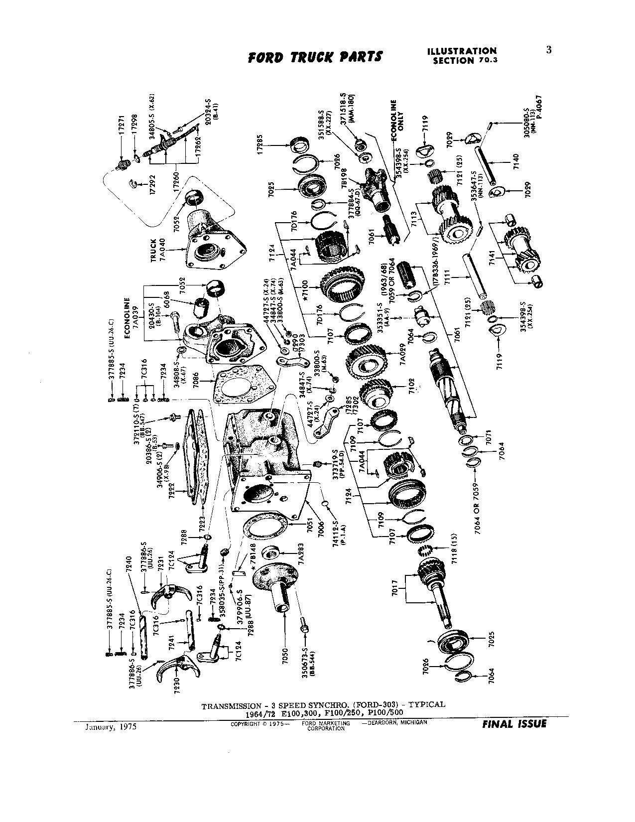

All the Ford type 3.03 3 speed manual all syncromesh trans parts should be available from NAPA, indie auto parts stores and are the same 1963/87.
Pic: The usual parts that should be replaced: 7025 front and rear bearings (they're different); (6) 7A044 syncro shoes (3 & 3).
(15) 7118 & (50) 7121 needle bearings; 7052 rear seal, 7A283 front seal; 7107 syncro blocker rings (1) 1st, (2) 2nd/3rd; 7B331 small parts kit (washers/snap rings).
These are the Ford 'basic' part numbers, not the complete part numbers. Auto parts stores do not go by these numbers.
