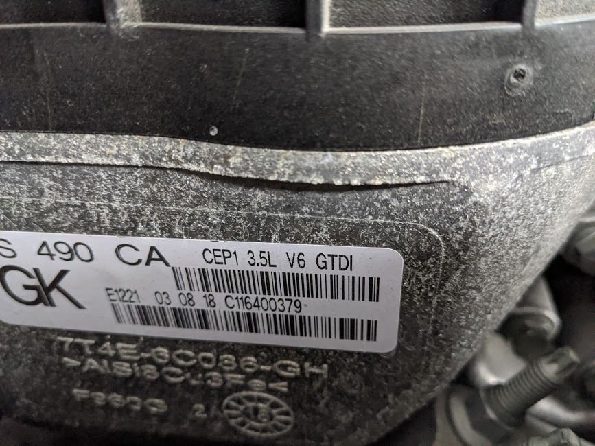

Further to your request, I have taken the liberty to post a picture of the decal affixed to the engine front cover of a 2019 model year Explorer to illustrate what the engine identification tag should look like:
So in the picture above, the engine ID tag would be GS 490 CA (you can't see the G). The trace serial number illustrated above would be E1221 030818C116400379GS 490 CA. Of those digits, the portion highlighted in bold in this example would be 18C116400379. Hopefully this helps.
