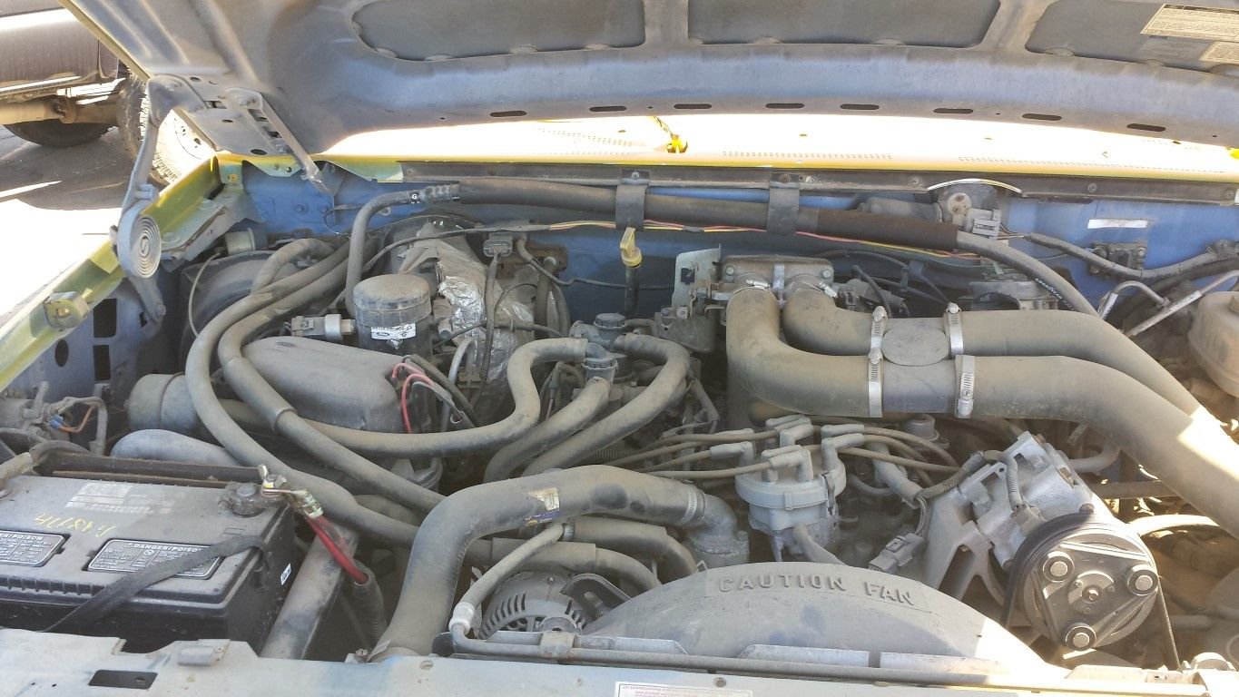

Did it look like this under the hood? If so that is a 460 not a 351.

Conanski,
I don't remember what it looked like per se. I noted the cover for the throttle body was up near the front like on my 5.8. It had the flattened plastic cover on the top with some cables routed from it to the firewall. There were two snorkels going over to the air cleaner. I seem to remember being able to see more of the motor than what is evident in your picture.
I remember being able to clearly see a valve cover on the drivers side and it was quite rounded. I am going to look under my hood tomorrow to see if mine is the same shape. I'm pretty sure it didn't have air conditioning so that may be why I could see the valve cover easier.
I thought it might be an FE as the valve cover reminded me of my old 360 I had in my '72 F250. Then again, 30 od year old memories are not that reliable.
