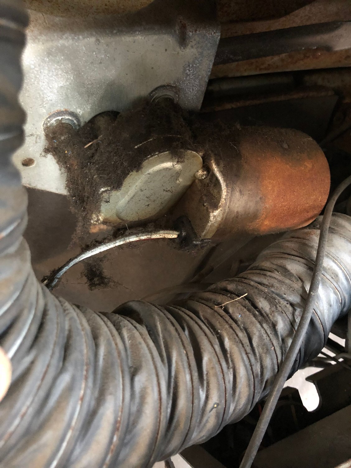

Now that I think about it swaping the wiper motors and their wiring might do the trick to get me the switch plug I need.
This is my 65 F100 4x4 wiper motor.
And this is the donor 66 2wd

I like your idea of bringing the wiring and cluster over from the 2WD cab - also grab the wiper motor. I would hope it has the correct connector for the delay switch.
Mine does and it is as easy as unplugging the older
And plugging in the newer
Chad
