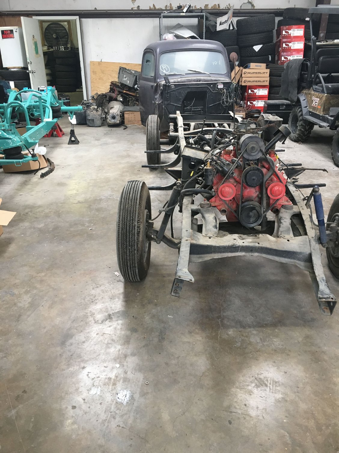

We have one that was rebuilt about 7 years ago, truck was wrecked and has been stored for 6 years. I can get some better pictures. It turns over but didn’t try starting it.
I can get a price for you if interested. Located near Dallas Texas.
We just took the truck apart last week. Points look good as well.

Sorry. Forgot to post that the passenger side water pump/ mount to frame is broken but I have an extra one that needs to be cleaned.

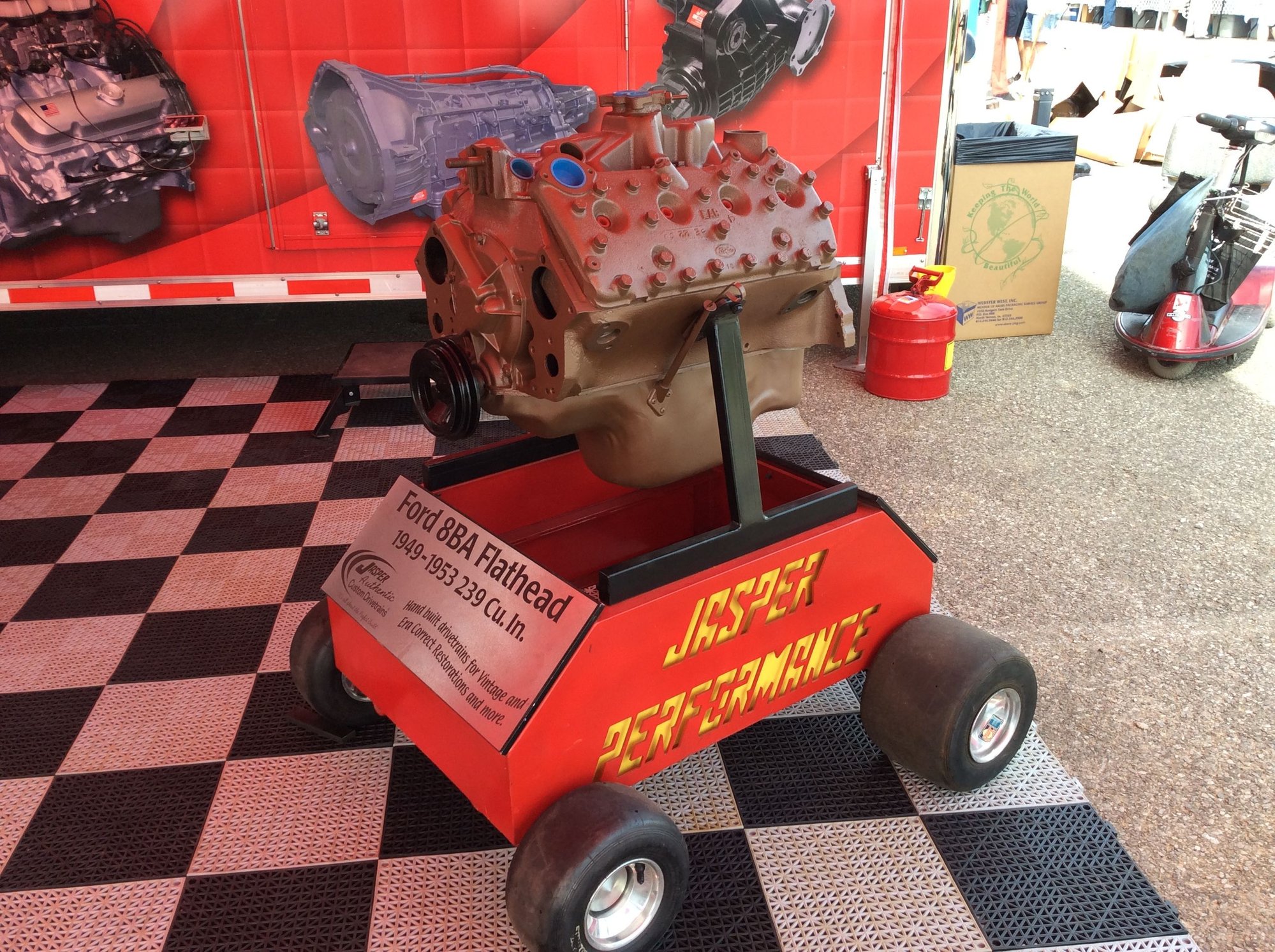

This was on display at the Frog Follies car show. Sold by Jasper Engines located just up the road from me, I don’t know the price.

Philip, that is interesting. Was talking to someone here the other day, and he was telling me that Jasper was doing flathead rebuilds. Guy owns a repair shop, so he would likely know.
