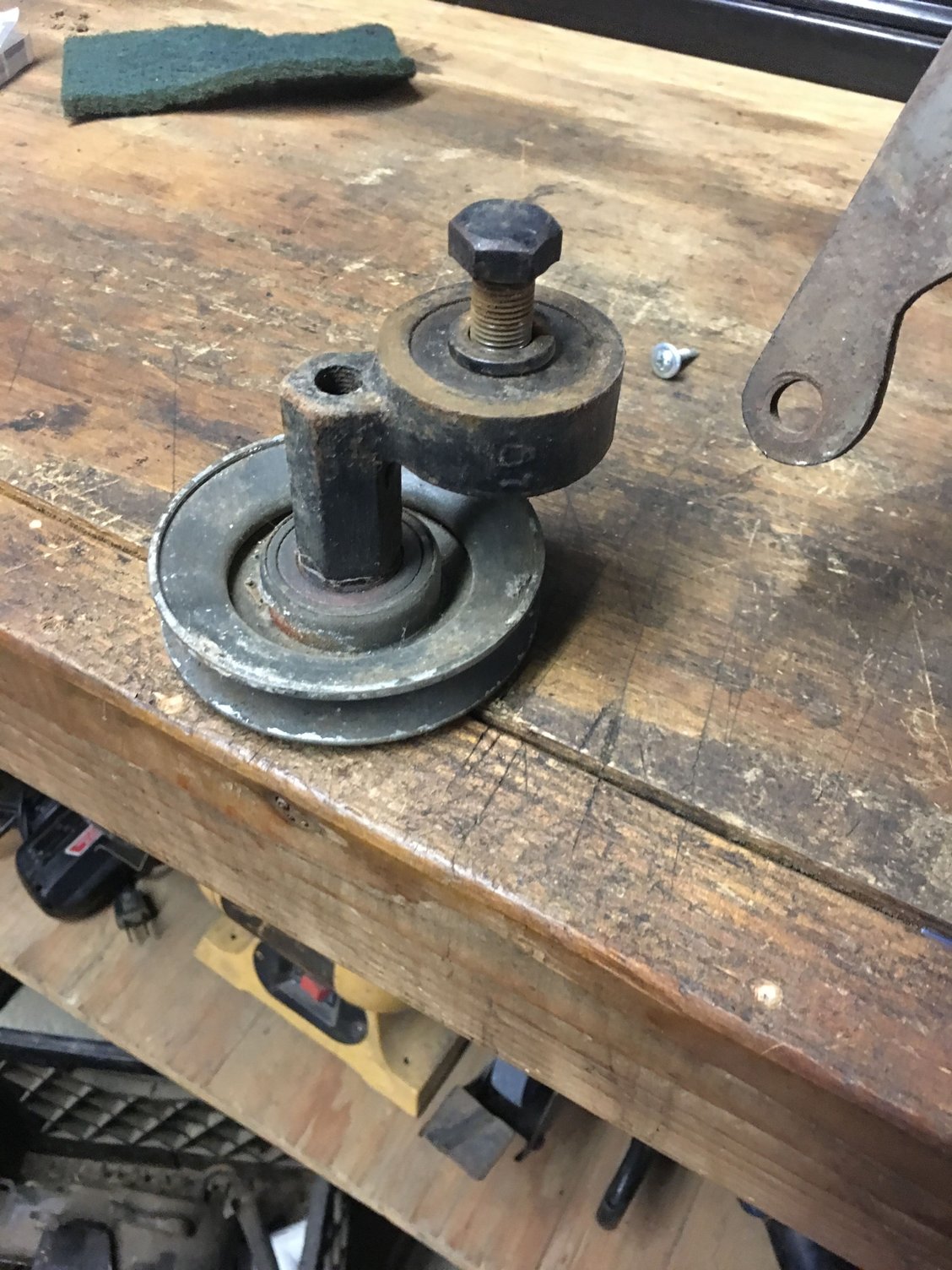

its a pretty simply pulley set up I’m sure if you can’t find one someone could fab one up for you fairly easily. I’m in the opposite boat I have the brackets and the pump but I don’t have the in cab parts somewhere along the line they were removed and I have no idea what it even looks like

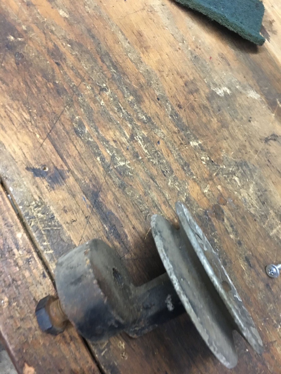

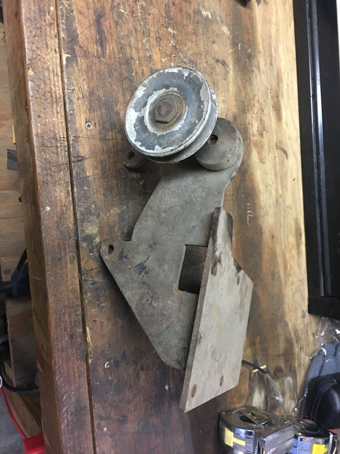

For some reason photobucket won’t let me share the pictures publicly anymore. So I’ll repost them directly
