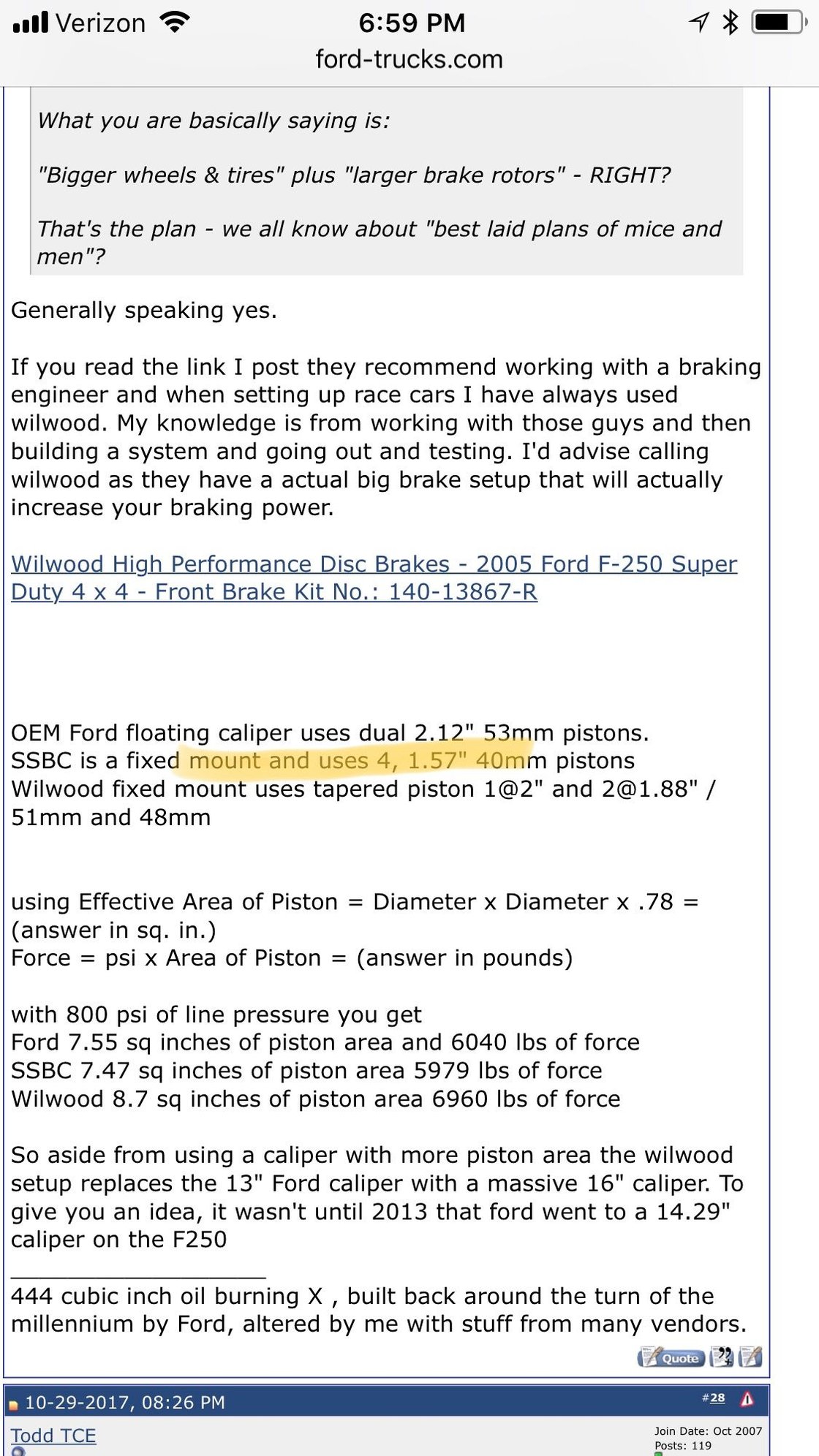

Piston sizes and brake torque calculations on OEM, SSBC and wilwood already done .

Only one issue. In this post the guy says the SSBC system has 4 pistons but the one on looking at has 8. So it’s not the same.

Nevermind I feel dumb he’s only counting one side of the caliper.

DeltaV didn’t you need the tire diameter to calculate the correct numbers?

Not to calculate brake torque.

Ya, That was my post and all 3 calipers are calculated using one side so the comparisons are equal.
