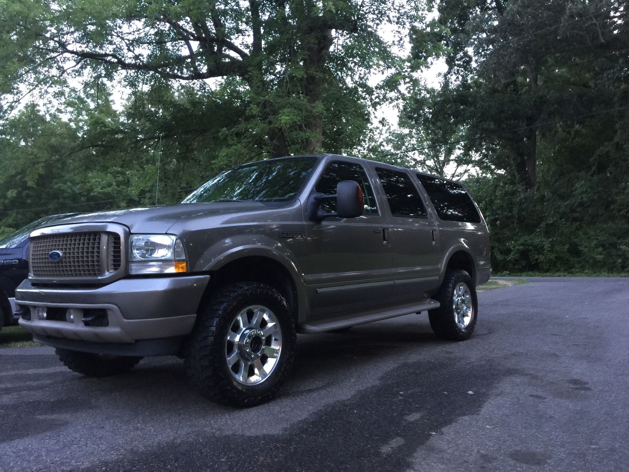

I installed the ATS V/C springs on my Ex 6.0. Gained about 1.5" in the front and around 2" in the back. Sits with the perfect rake.
Old Sep 11, 2017 | 08:13 PM
Jesse Walter's Avatar
Jesse Walter
Joined: May 2017
Posts: 52
35/12.50 tires rubbed a bit in the front. Switched to 275/65/20.
That combo looks perfect to me. Nice work
