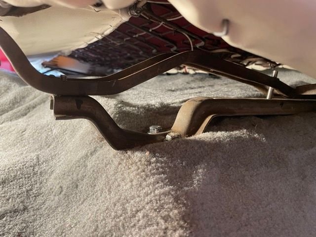

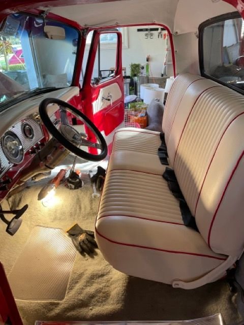

I'm 6'2" and had the exact same issue. Was excited to get the interior re-upholstered (I bought the truck from someone who had put in some hideous after market bucket seats and center console). Got it back from the shop and the seat was so high and forward it was almost undriveable.
I came up with a pretty good solution. Took off the seat and removed the sliding rails. Drilled out the rivets in the rails and removed the sliding mechanism all together. Kept the floor mount bracket from the assembly, and bolted that to the bottom of the seat while it was out so I could line up a new bolt hold midway down the bracket. Drilled it out. Installed the mount bracket back in the cab (easy with the seat out) but threaded a bolt up through the bottom first. Set the seat back on the bracket and lined up the holes I had drilled. Four bolts will keep the seat in place (the seatbelts are bolted to the floor, so the bolts just need to keep the seat in one spot in a crash).
I also moved the brake pedal back a few inches, and now it's way more driveable. Not roomy, but driveable. Hope this helps!
