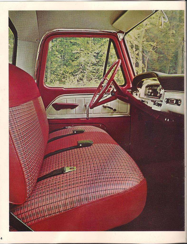

Kinda of hard to tell from the angle but how does it compare to this? I noticed your steering column bracket under the dash edge doesn't seem original. Did someone add power steering?
Name:  66 Ford Trucks Brochure - Page 4.jpg
Attachment 248962
Chad
using the top of the door pockets (or access panel depending on which is present) shows a drastic difference in how high the seating surface is in the OPs pic. His is actually hiding the trim around the pocket while in Chads pic, you can see some of the panel. OPs seat is much thicker. It reminds me of a seat from a bumpside I was swapping into a 66 a few years back and it too was much thicker and didn't leave enough room under the wheel...ended up reverting back to a 65/66 seat.

Looks like they did a nice job covering your seat. But looking at your pictures, "unless they stuffed a lot of extra foam in it" it looks like it came from a much newer truck. My seat measures about 3 3/4 inches to the door at the forward corner and about 15 inches off the floor at the highest point at the front.
Old Nov 3, 2017 | 01:52 PM
Darrellt's Avatar
Darrellt
Joined: Mar 2017
Posts: 86
Crap. That could be the problem. I've no way of knowing other than it doesn't seem to fit quite right. Ugh.
