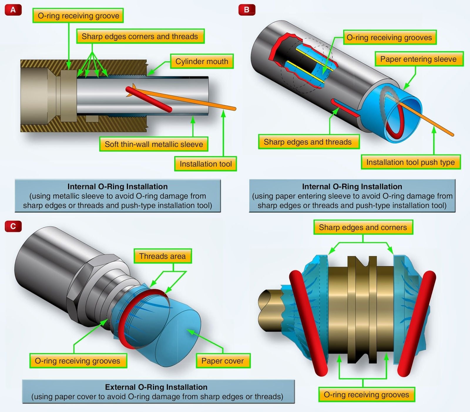

Rector seal #2 in emergencies but other wise O-rings.
One way to get an O-ring over threads is cut up a plastic
milk carton and roll a tube in a slight cone shape around
the threads. Place a lubed O-ring on and slide it down into
place. This way you skip the threads doing any damage.
Here are some examples. The bottom left one is what I am talking about.

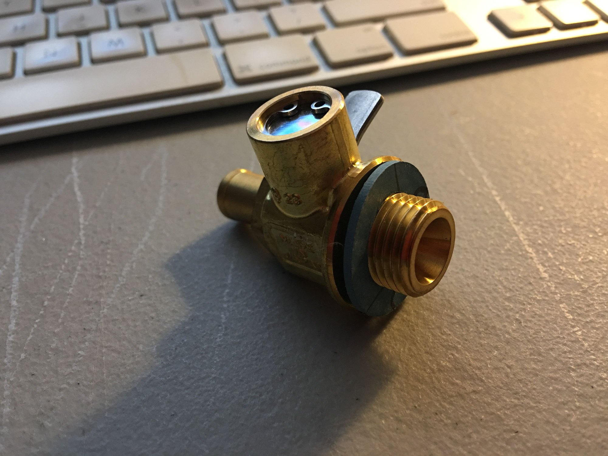

The one's I purchased buy never installed, and don't know that I ever will, came with a hard fiber gasket. It's the stock plugs as I showed above that have the o-ring.

...... One of the surfaces will be cut for ring retention too. ......
Originally Posted by diesel_dan
..... The Fumotos came with gaskets back then, so I'm not sure if they had a machined o-ring groove.........
Scott
The engine block has a counterbore on it to capture the o-ring and not let it squirt out sideways. Because of that if you use the hard fiber gasket it needs to get distorted somewhat to seal better, and ideally you should clean the surface outside of the counterbore for that seal. If you pull the fiber gasket and use an O-Ring it will fit as designed. So it is better engineering wise to use the O-Ring.
