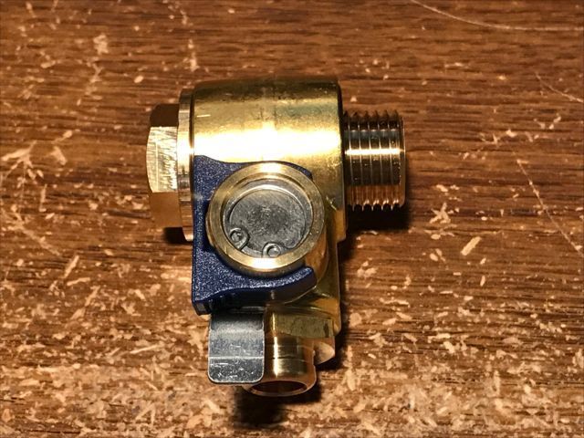

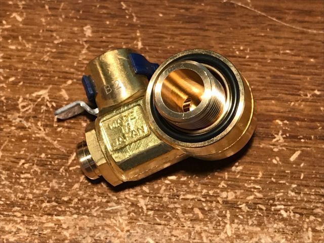

I’m going to get picky here, even though maybe no one has failures. The Fumoto valves are set up for the fiber gaskets. If you look at the original plugs they include the washer and a not round sealing o-ring. This is how any ORB fittings are designed. You could add a thin washer so the o-ring is not stretched and abraided when installed, and maybe why your mechanic stated he had failures. Then add the correct what-ever-shape-they-want-to-call-it or x-ring.

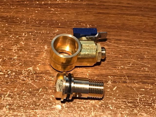

So, just to make sure I understand: you are saying the Ford Block Plugs had BOTH an o-ring and a backing washer? Like when the 6.0 1st came out, or every one produced?
I mailed all of mine off to Jeff, but I saw when I pulled the o-rings off the stock plugs, there is also a machined relief for the o-ring to sit in, above the threads and below the shoulder (head surface) of the plug. So it has that and the counter bore in the block to snug into...

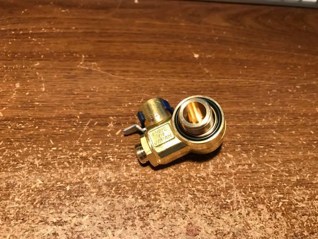

All threaded fitting designed for an O-Ring will have that land for the ID of the ring to seal against. If it's against a thread the crest of the thread can knife edge the ring which can propagate into a full separation.
All I have is an example of one, from a 2010 Ford rebuild. I don't know if they said, "Hey, we just gave this guy some crappy lifters, lets upgrade his block plugs, here's this prototype". But it follows the traditional design of these type of fittings. At least it looks like it does.
The traditional straight Fumoto valve was machined for the fiber washer, but I would guess if you used a small diameter o-ring it would not be touched by the thread. But then you don't have the compressibility to index the valve as much.
The SX version was designed around o-rings with a different capturing structure.

Jack, you crack me up! Conspiracy theory noted... I compared my plugs to your pic, and they do have the groove all around the bottom of the plug head - made me think I had missed the washer, but no, it is just a groove. Yours has that groove too, but it definitely looks like there is a washer below that.
Perhaps this is one of those: put into production after the F series run of 6.0s? (blue spring, STC replacement, etc.) I'd probably chalk it up to that versus the: "let's give the boy something nice since we screwed him so badly on the internals", line...
