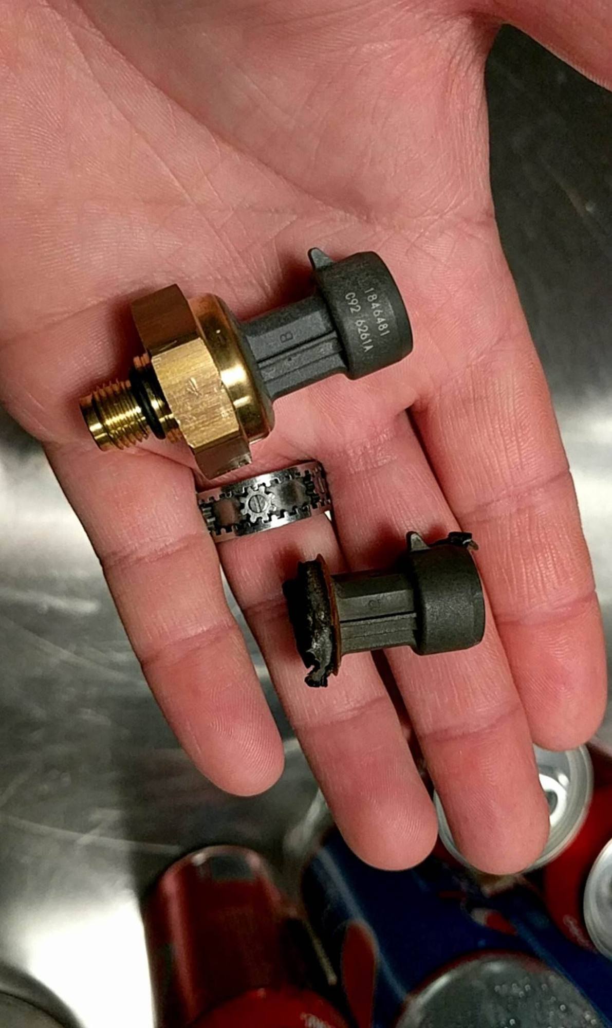

Given that I found a sensor partially melted and missing its threaded metal end, I was under the impression that I needed a new Exhaust Back Pressure Sensor [EBP], which the P0472 Engine Code that came up on the scan also supported this theory. The trouble is, having watched a few videos on You tube, the location for this component on the 2008 is different to where I thought it was going to be fitted (i.e the hole where I have exhaust gases comes from). On my truck the Sensor wiring, and tubing was all zip tied where it is shown in the picture. The tubing isn't even connected which might be standard for an EGR/DPF/Tuned Truck?. Secondly, the sensor wiring was zip tied in such a way that it seems like that it was intended to connect to an EBP sensor that would install into the Exhuast down pipe hole, but since I don't have a picture from before this issue I cannot say for sure. (The slack in the cable and zip tie locations definitely suggests it though)
Anyway, I ordered the 2008 EBP Sensor (pictured next to my burnt, missing a bit, destroyed one) and thought this was going to be easy.. NOPE. This Sensor doesn't fit. The thread is way too small for the Exhaust fitting. I'm also not convinced that a Metal ended, Plastic Sensor will stand up to the temps its going to be subjected too here.

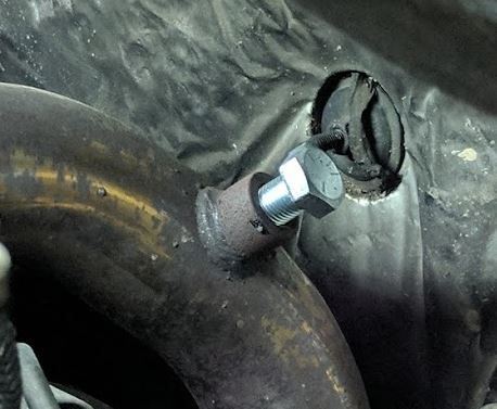

I tried to photograph the thread in the Exhaust, and carried out a few more searches for Ford EBP sensors. The result is that "I THINK" the 6.0L EBP Sensor which uses a 1/2 – 20 UNF-2B Thread will fit perfectly. To test the theory, I bought a 1/2 – 20 UNF-2B Threaded Bolt and it goes in nicely even if it is too long but it does stop Exhaust gases getting out so I can at least get it to a shop now without burning a hole in the fire wall. But why would they use a 6.0L EBP Sensor on an 2008 Truck? Maybe it's down to being a custom install again?

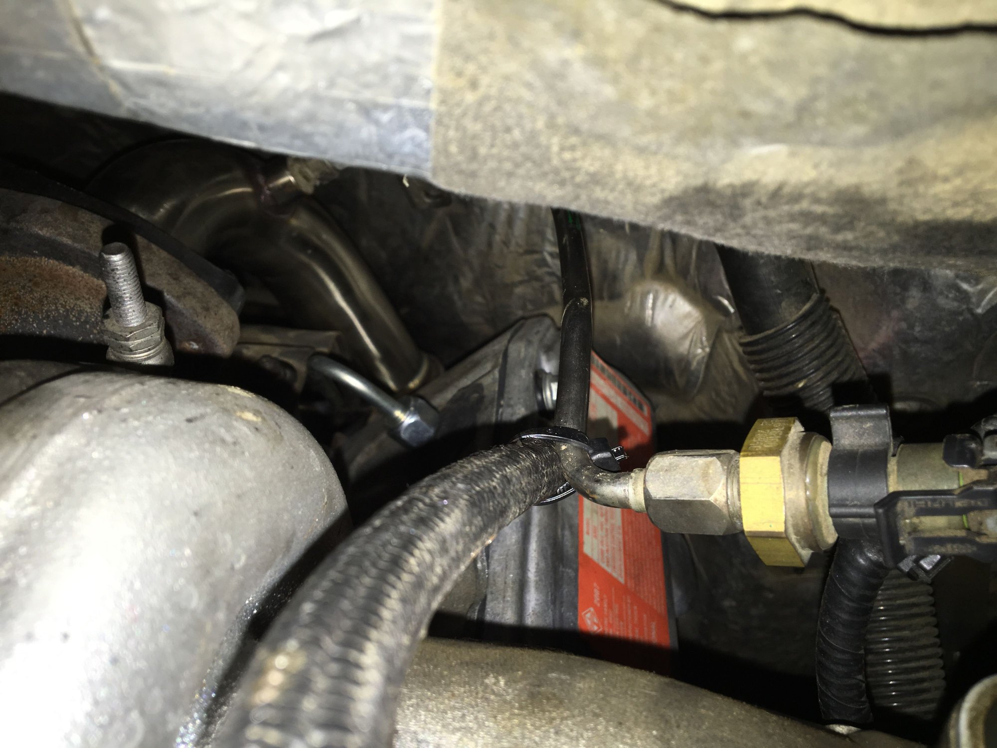

That is where the EBP sensor goes. There is supposed to be a pipe thread to flare fiting that screws into that hole, the tube that is laying there screws onto that fitting, and the sensor screws onto the tube. Originally the tube would have went down behind the head close to the EGR cooler. My truck is also deleted, i will try to get a picture for you

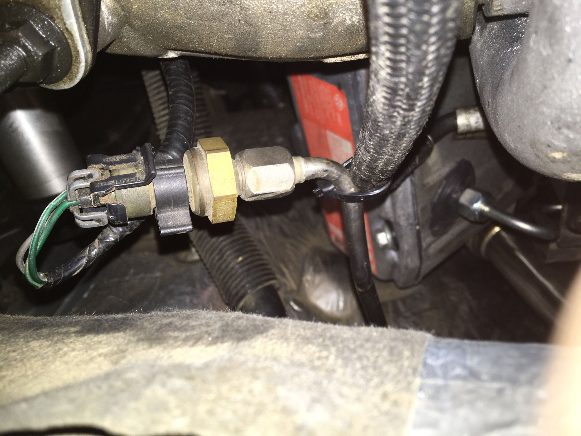

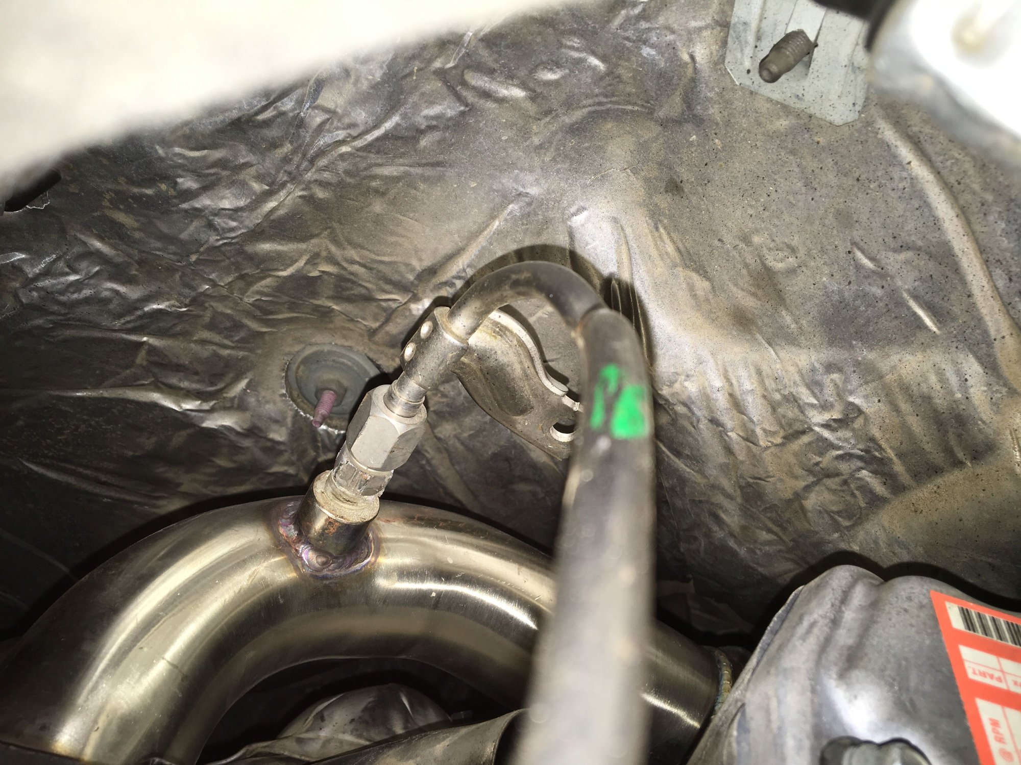

From: Albertville, AL
I think you can see what it’s supposed to be like...I just have mine tied to the fuel line right beside the fuel cooler...my tube is actually upside down from what it was originally, the bends were closer to what i wanted when i moved the sensor. But screwing the ebp sensor straight into the downpipe will most certainly IMO melt the plastic part of it off

Herbiemin. Thank you thank you thank you for posting those pictures. Now I know what I need to do. I’m still curious as to how mine was set up before the “pop” but I should be able to make this work provided the threads all match up. If not I will get an adaptor fitting made to make it work.
