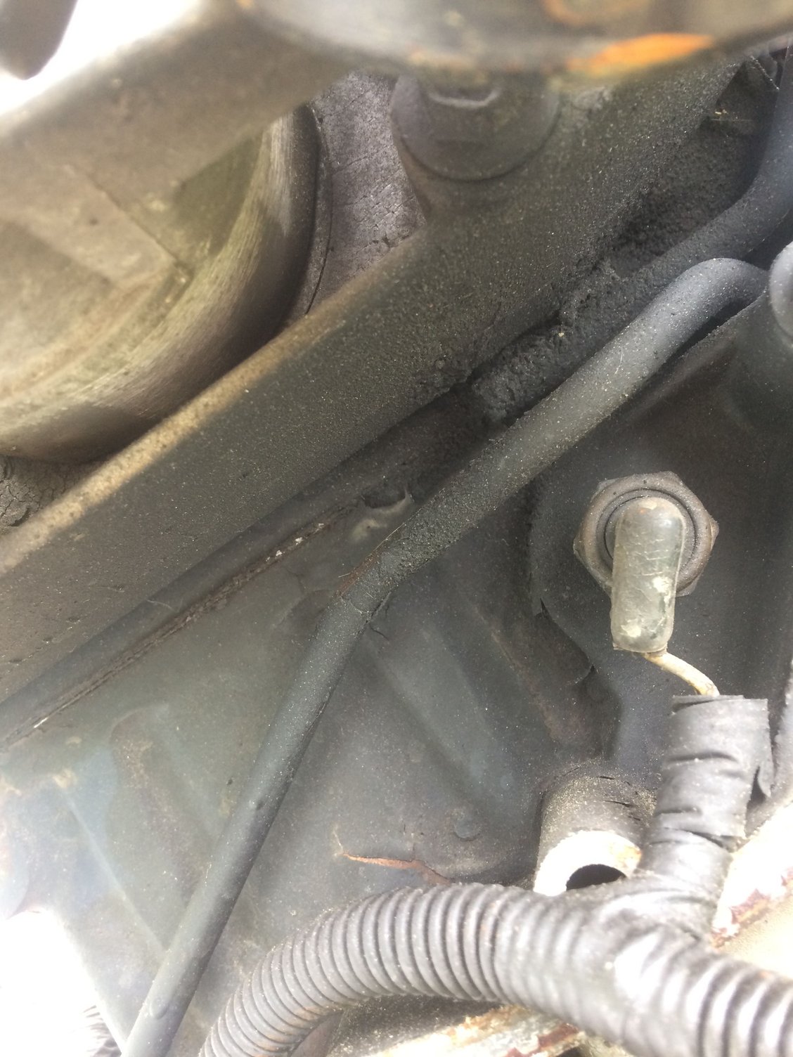

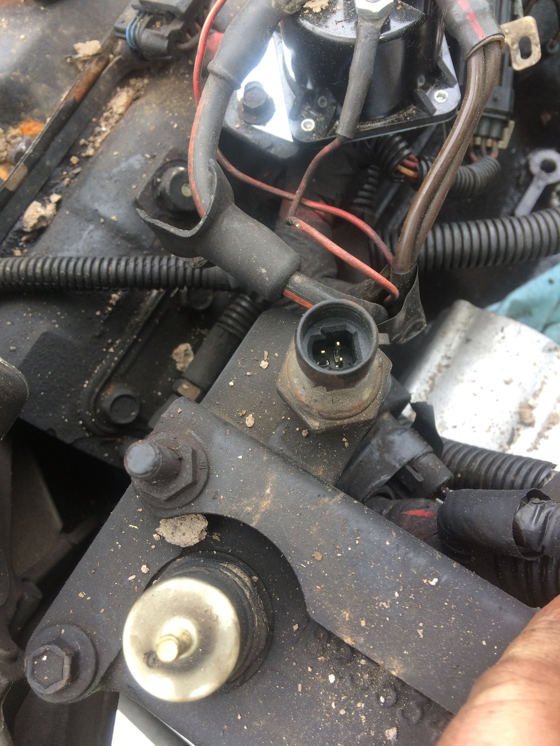

I'm working on rebuilding my engine and was taking the exhaust manifolds off when I noticed that a tube on the front of the left manifold was completely cut in half. It leads up to a sensor on the top of the engine. I want to know what it's called so I can order a new one. It looks like it's been that way for years.
Front of the manifold
Sensor it leads to

That would be the EBPS (exhaust back pressure sensor tube and sensor fix it or buy new. The truck needs this sensor.

http://www.riffraffdiesel.com/ford-ebp-exhaust-back-pressure-tube-94-5-early-97/
Tube is $30 from RiffRaff. My sensor was bad when I bought the truck. Had a noticeable improvement in fuel economy when I replaced it.
The sensor is $87 from RiffRaff.
