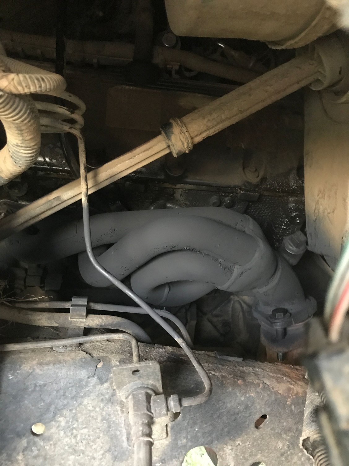

Most of you know I posted asking if the f150 headers summit offers for the 5.4l where the same as the superduty version from Gibson or jab that cost 4-5 times as much. Well it turns out they bolt up with literally no modifications what so ever besides plugging the egr with a pipe plug.
quality of the headers seemed ok, welds looked strong just sloppy. Had to re paint with VHT header paint but that's holding up fine for now.
Install was pretty difficult and very time consuming. None of my studs broke off but 3 stayed in the head on the passenger and 2 on the driver and I left them and re installed the nuts nut used new supplied boos in the other holes.
Sound and performance seems not to much different. Sounds is quiter to me and much smoother sounding. Not as crackly or raspy. Performance seems the same I did notice a more snappy throttle and it revs much easier. But seems the same when actually driving.
One thing I noticed was much hotter floors. I can feel the heat coming through the carpet. Just a little but I never noticed it befor.
Ill do do an update after winter seeing how the hold up. For $200 new you can't beat it.

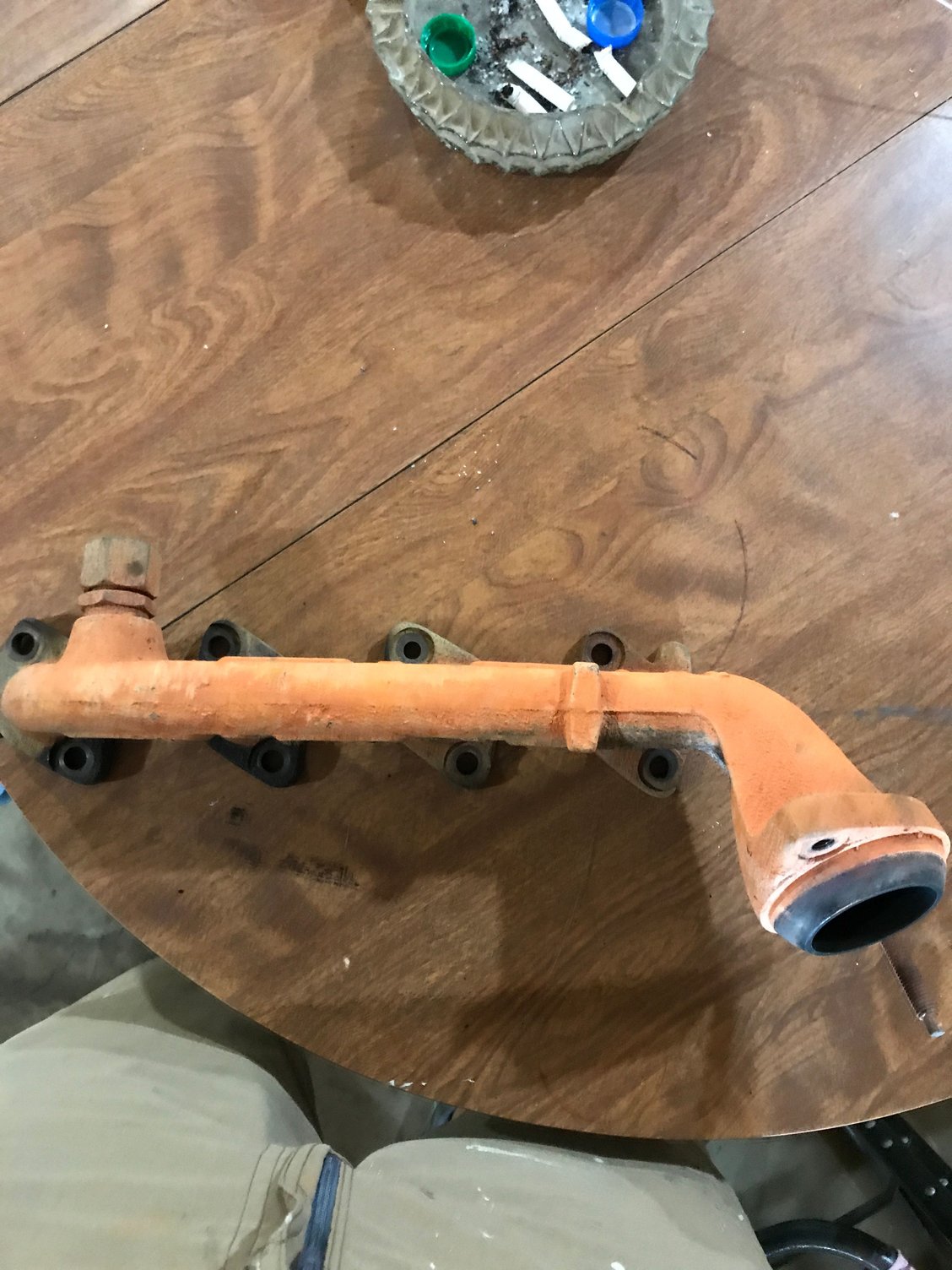

This is a pretty good shot of how bad the drivers manifold bends to the collector, it's almost a 90 degree angle and about 1 inch by 2 3/4 on the inside. The headers should flow much better especially for later mods like a cam or intake and some injectors
