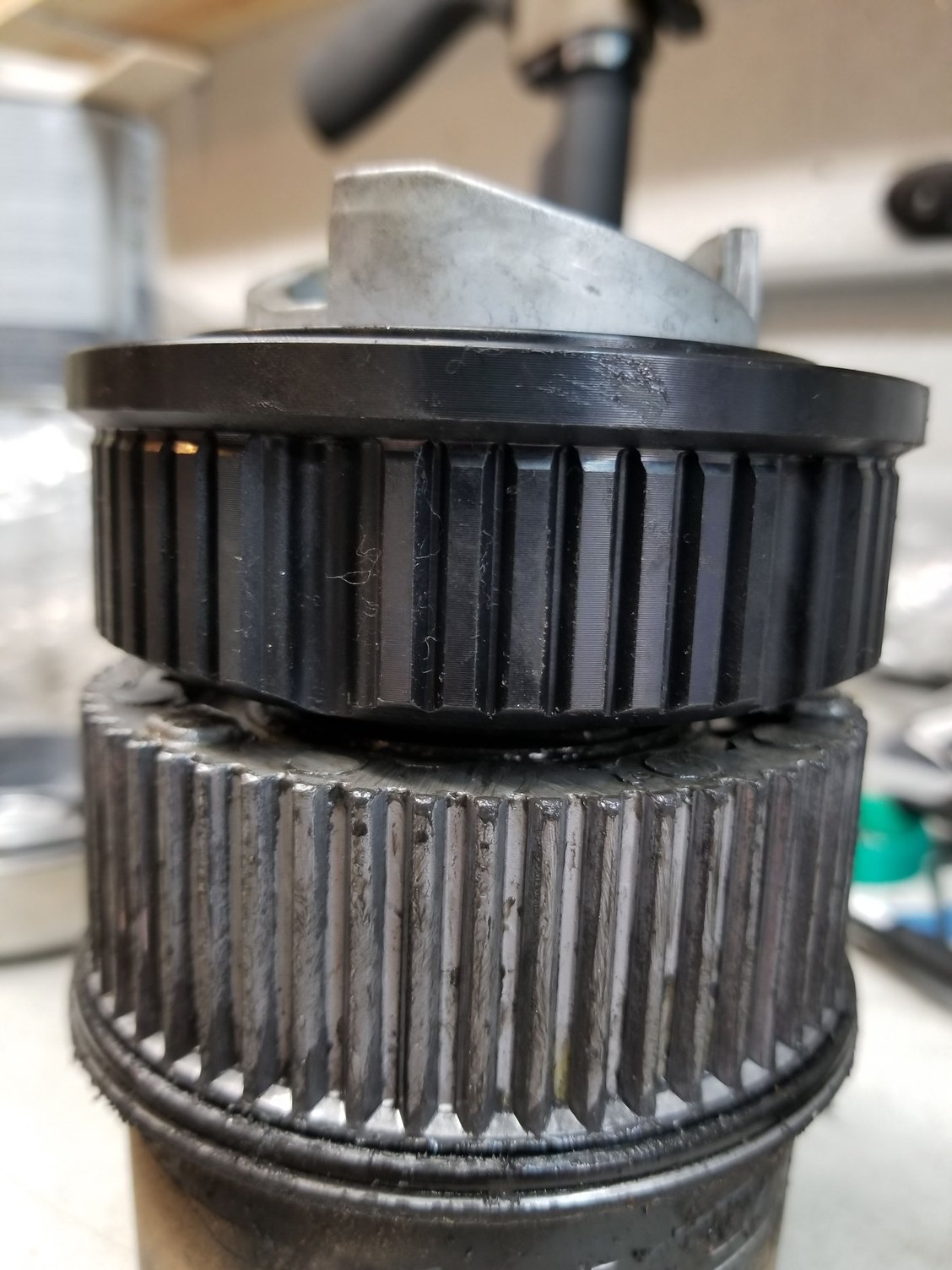

I have an 05. ordered in the MileMarker 449SS hubs
The inner splines for the stub axle fit. The outer splines on my hub are more fine than the mile marker hub.
Now that is a problem......

Here is my auto hub and the MM hub. splines are different??? Any idea why?

If they gave you a part that is compatible with 2005 F250, then you have the wrong part. It should be compatible with 99-04 f250 and 2000 to 2005

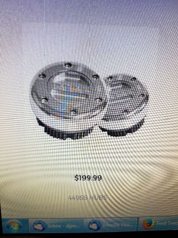

This is the model for 99-04 on Mile Markers web site. (they do not list 05 but shouldn't be an issue right?)
And this is the box.
IT all should be correct.....

Have you tried clocking them to different positions in the hub. I do remember mine were tight going in but weren't too bad. There should be a sweet spot where it slides together.

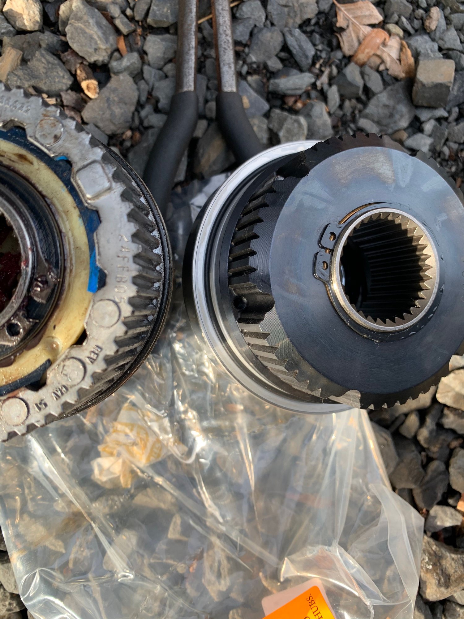

Bringing this back up because I ordered the MM 449SS locking hubs for my 2005, thinking they would work. The splines apprear different as pictured above. I didn't go crazy trying to install, but it certainly didn;t slide right in.

As stated, the correct hub for an 05 Ex is the same hub as an 99-04 Super Duty truck. This is the standard 30 spline Dana 60 hub that fits all Ford/Chevy/Dodge Dana 60 front axles from at least 1978 on. The 05-up Super Duty style is shallower/different spline, etc as pictured above...

Yes, I understand that. MM has the 449SS listed for 2000-2004 Excursion, which is what I ordered and received. It should fit my 2005 by your logic. The OEM splines appear different than what I received.
Are you implying that the wrong part is in the box? See below for image of box part number and compatibility.

UPDATE- The 449SS WILL fit a 2005, despite the appearance of the splines. It takes an abundance of patience to get them to slide in.
