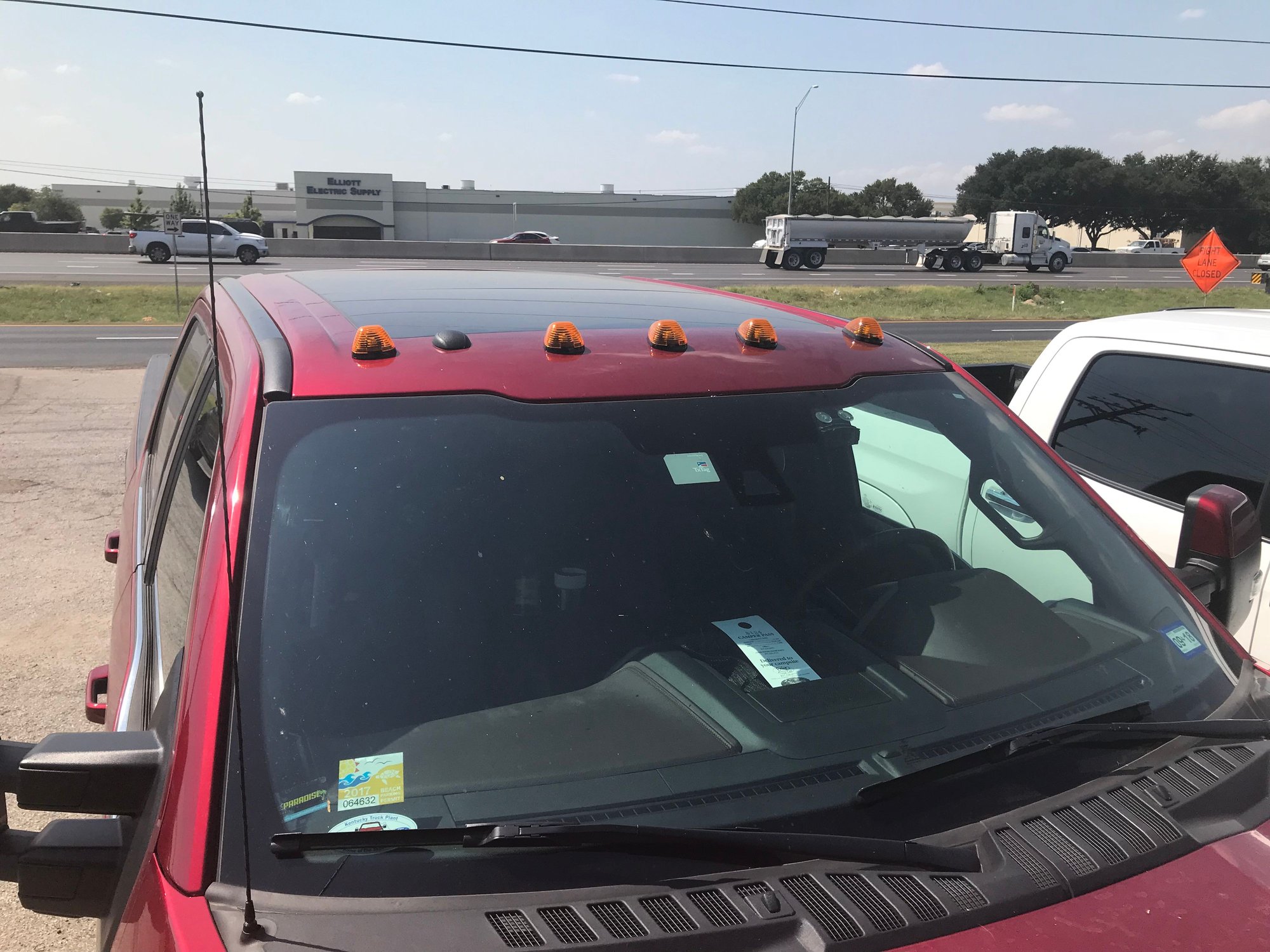

Finally got my cab lights added, $430 bucks, took them about 2 hrs. Truck Toys of Tx, Farmers Branch, Tx http://www.trucktoystx.com
Added OEM badging

After talking to the installer, he laughed when I said Ford dealers don't want to do it because of the moon roof.
He said its a EZ job, maybe 2 hrs MAX, and all you have to do is move the lights just a bit forward on the cab to clear the internal bar. I BET there are some places in Houston that can do it...

Jeep, yes incl the lights, not a bad deal at all considering one Ford dealer wanted $1200, another dealer wanted $450 but would only do the lights on a non moon roof, telling me they could not be added to moon roof trucks.
These folks had it in and out by the time I went to lunch and got back, less than 2 hrs...

Those lights are a simple install. They use round holes not square like the oem lights.

They are aftermarket. The OE requires a square hole to be punched thru and that is very difficult to do in a finished truck. I know one guy on here IIRC did it with a Dremel and used the OE, but no really needed as after market just uses a round hole and has the plug in connection to the Ford wiring harness...

These are LED's. The OE '17 I guess could be put on but at a much greater cost to make the square hole.

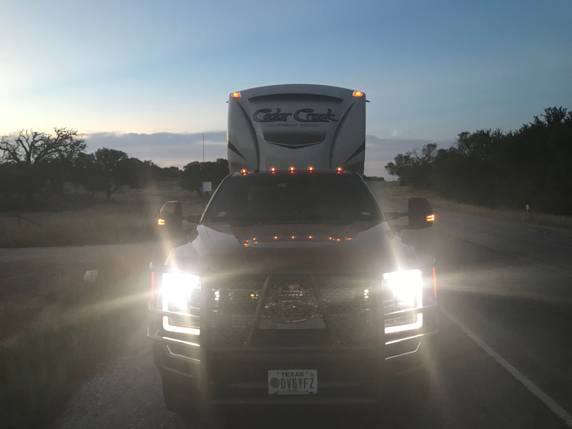

The reason I put them on is I travel in my business and often works is not done past darkness, so strange city, big parking lot, where did I leave that truck. Raise arm, hit the button and cab lights come on and there is my truck.
