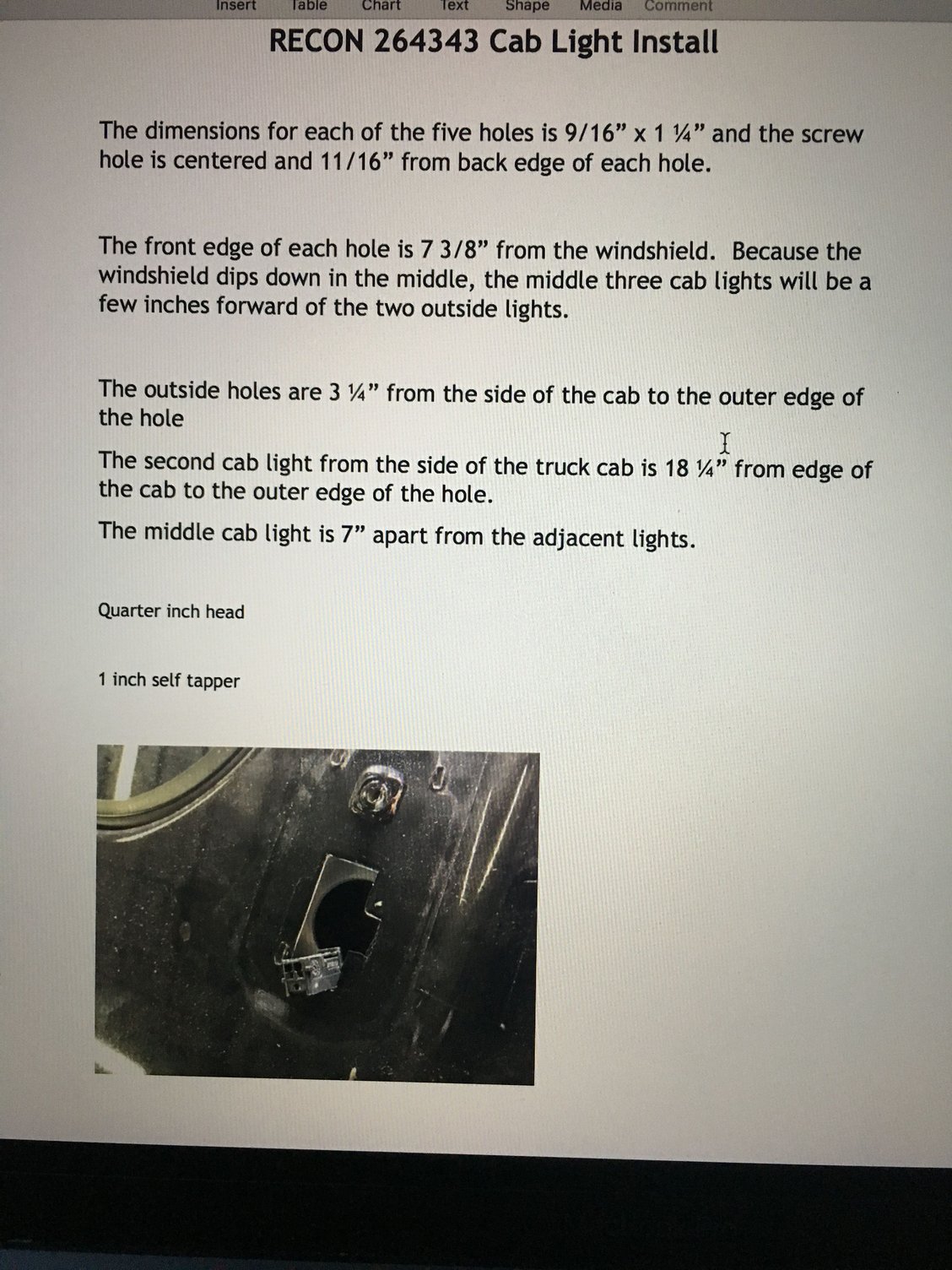

Originally Posted by FDNYL136
I just put the recons on my truck not bad to do
You have any pics?
Mine are getting installed a week from this Saturday.
Thank you for that!
Mine are getting installed this Saturday!
