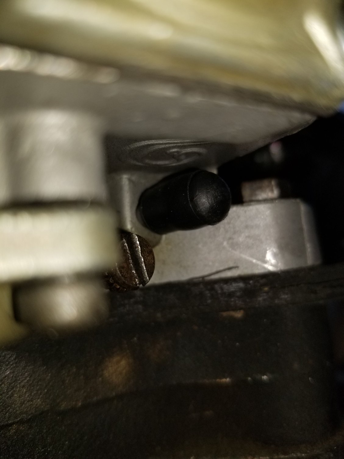

1Ton pointed this out. See the nipple on mine? No vacuum leak.
This is yours. No nipple, a vacuum leak 100%.

Originally Posted by Jklnhyd
Have you done any of the suggestions so far? Or are you still looking for answers?
It has a cap, from inspection it seems to be working.
