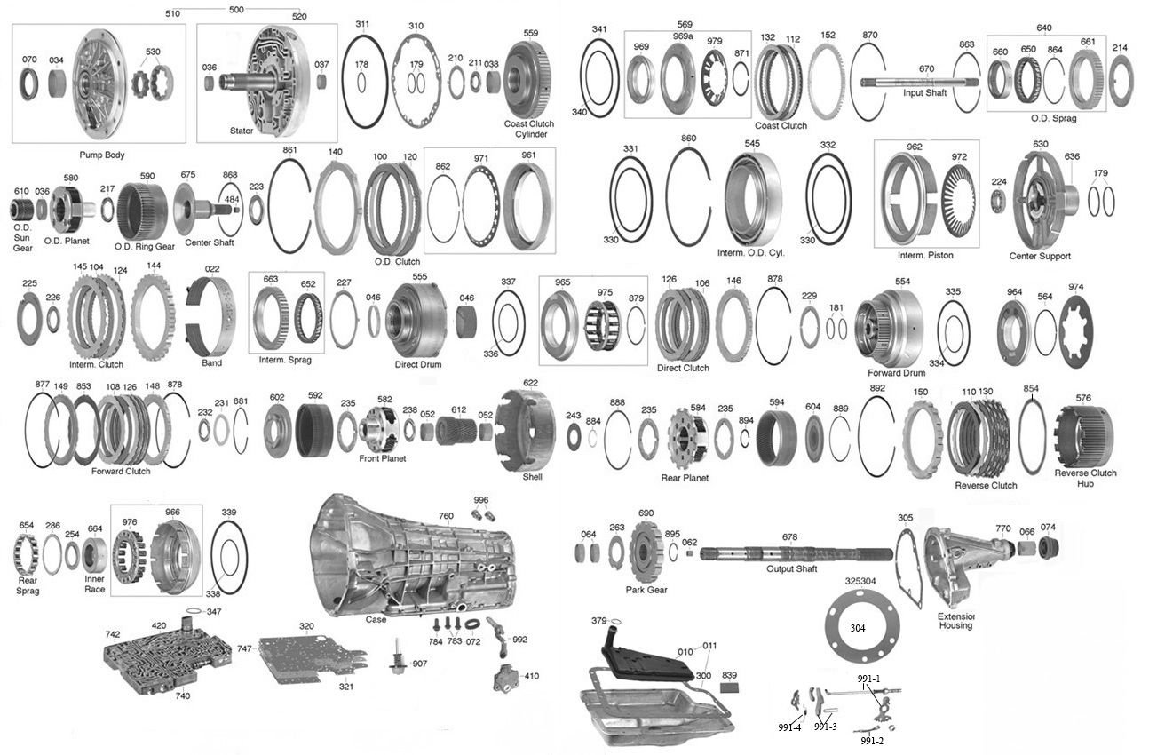

I thought that looked familiar as I also remember. I think I posted a pic of it's location. That was awhile ago.
part 991-4 at the bottom right of the picture below.

So to fix the OOPs here is that PDF.
