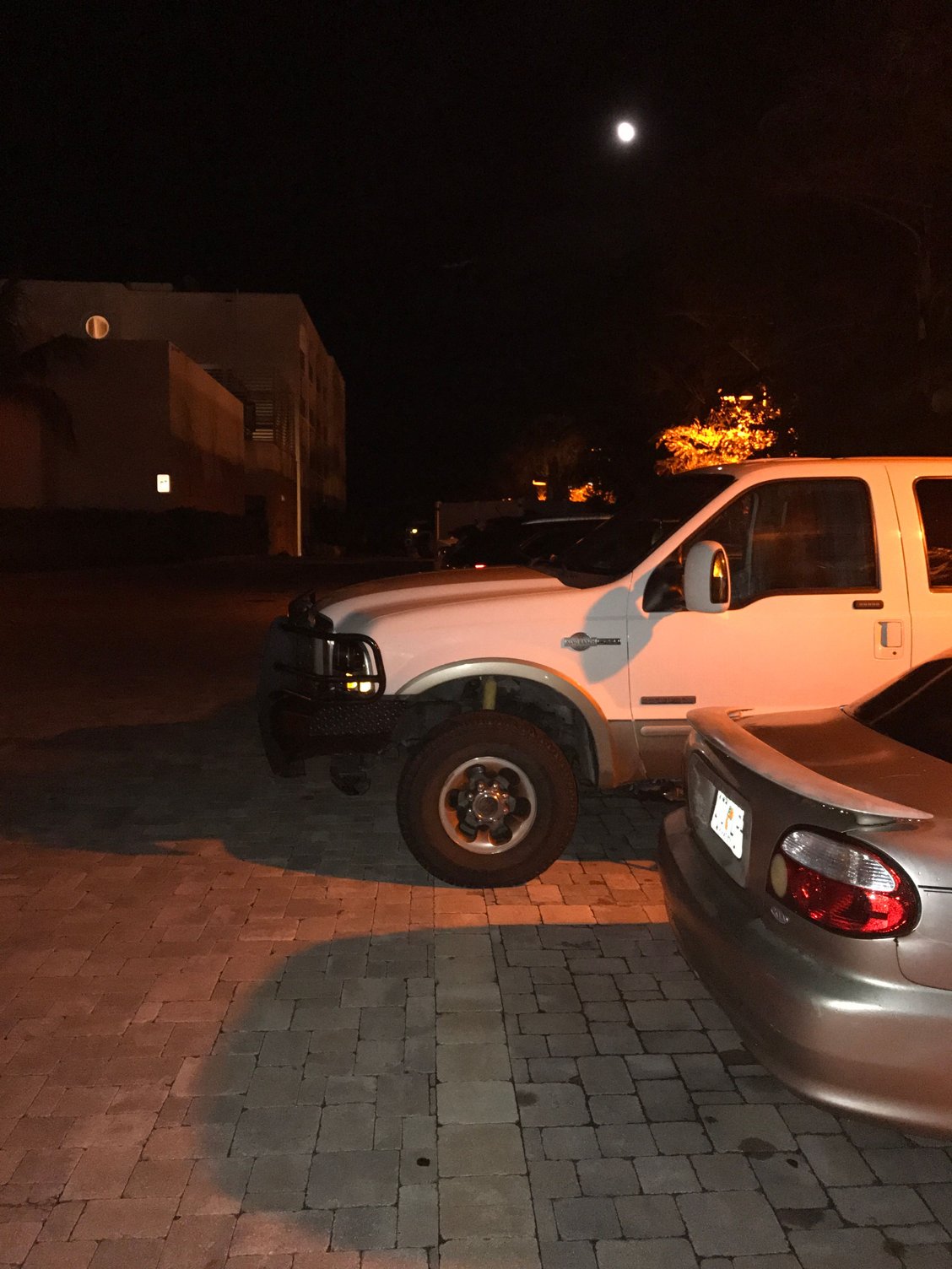

I have a 2003 f250 with a frontier truck gear bumper on the front, and I was wondering if anyone could tell me the biggest tire I could put on my truck with this bumper with no lift kit added and also without having to get spacers at the momment. I attached a pic that shows how much more room there is.

305 or 315/70 will most likely be the biggest w/o lift. However it may rub against the well close to the door at turn. I have 285/75 with mud flaps and had to trim the flap mount to keep from rubbing at well close to door.
