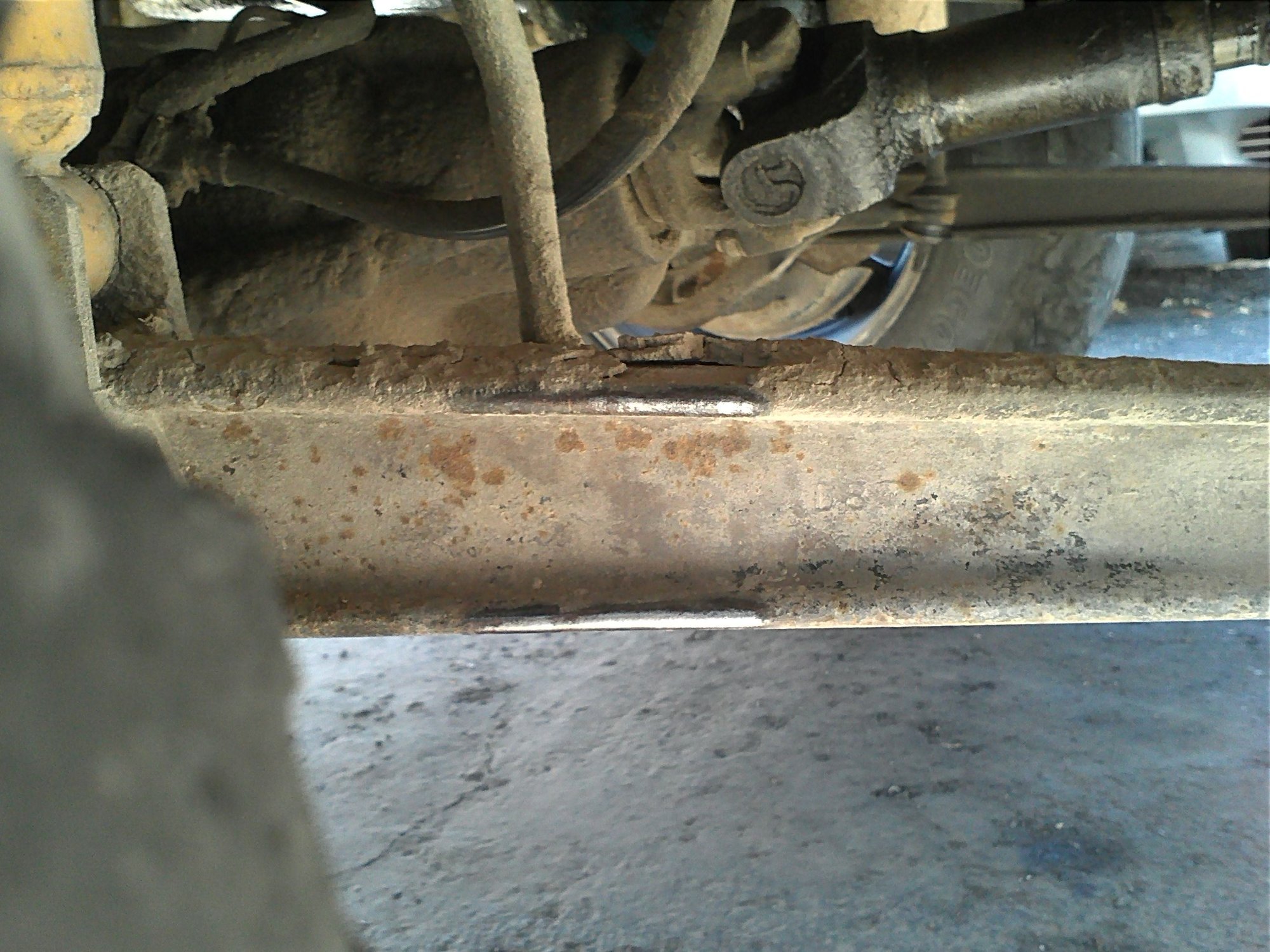

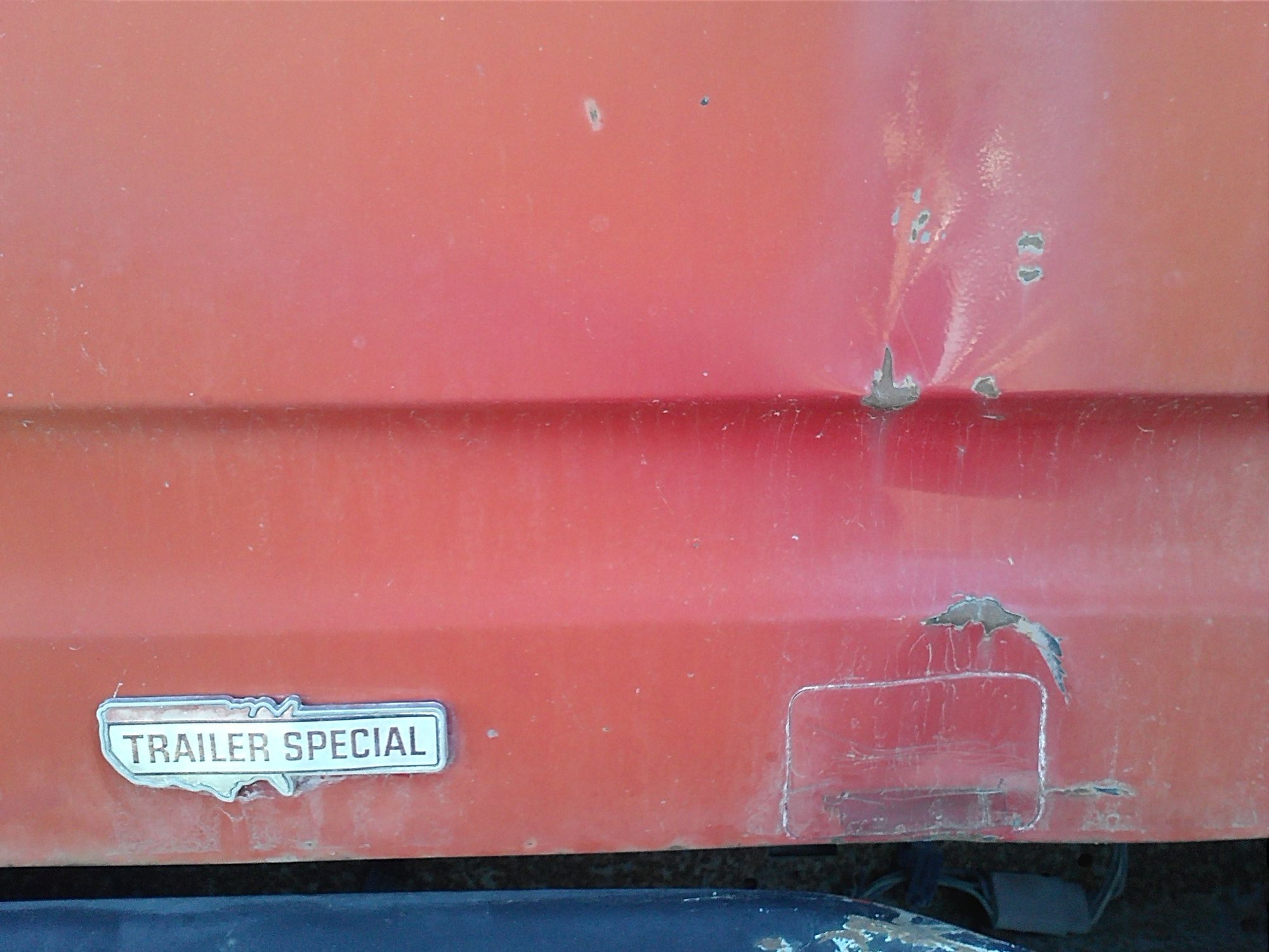

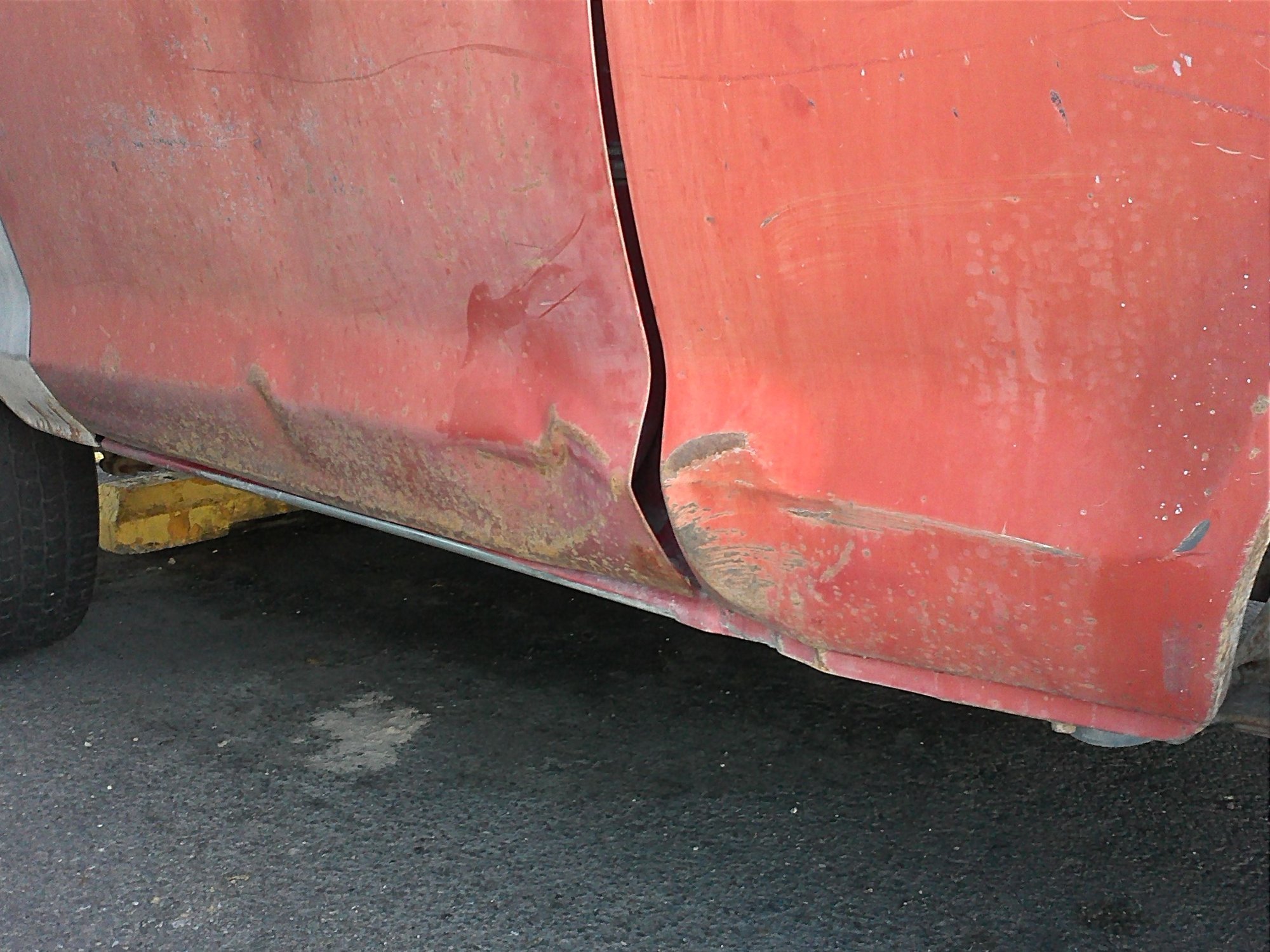

This is probably the most significant body damage on the Bronco besides the floor pan rust.

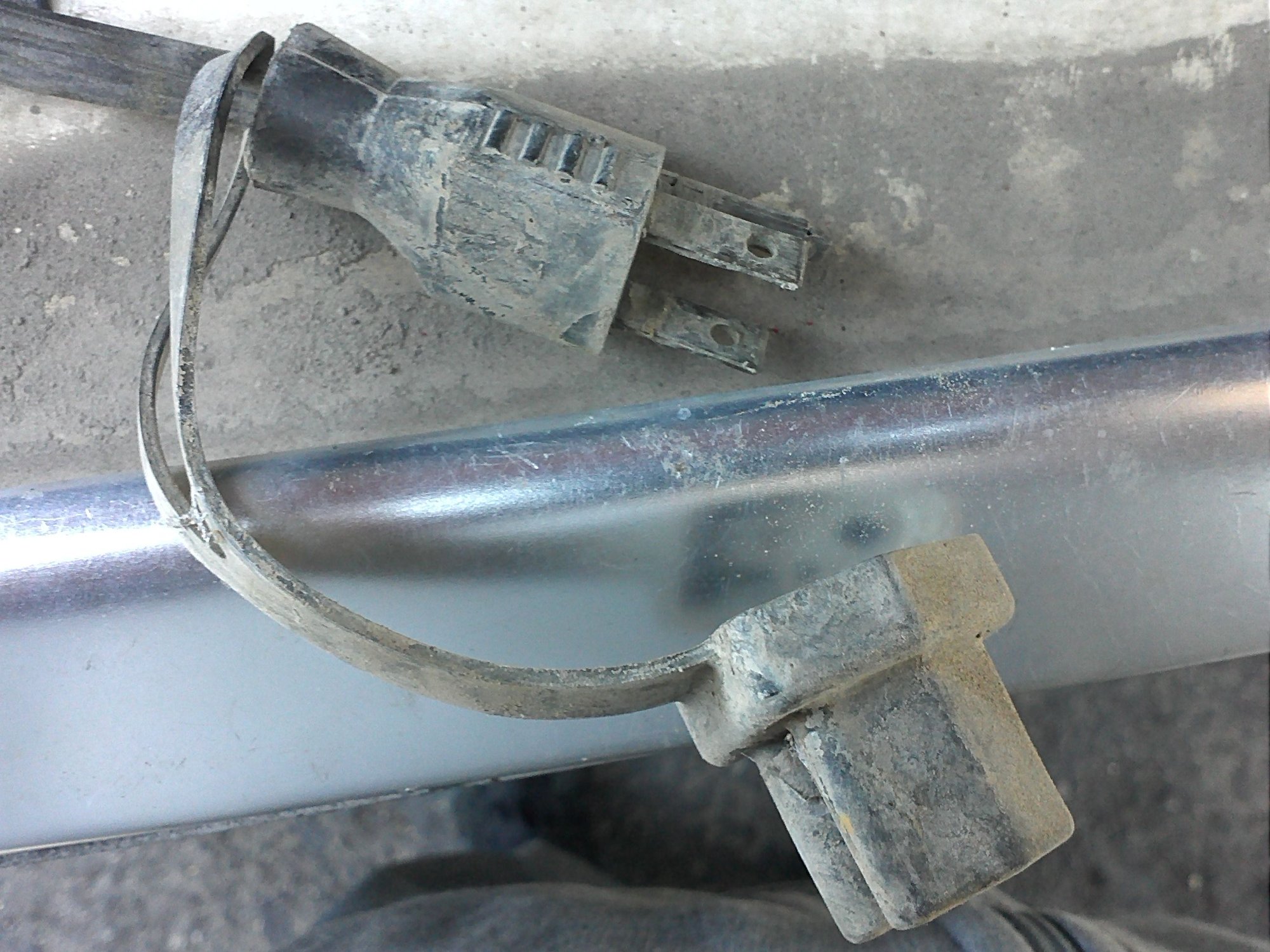

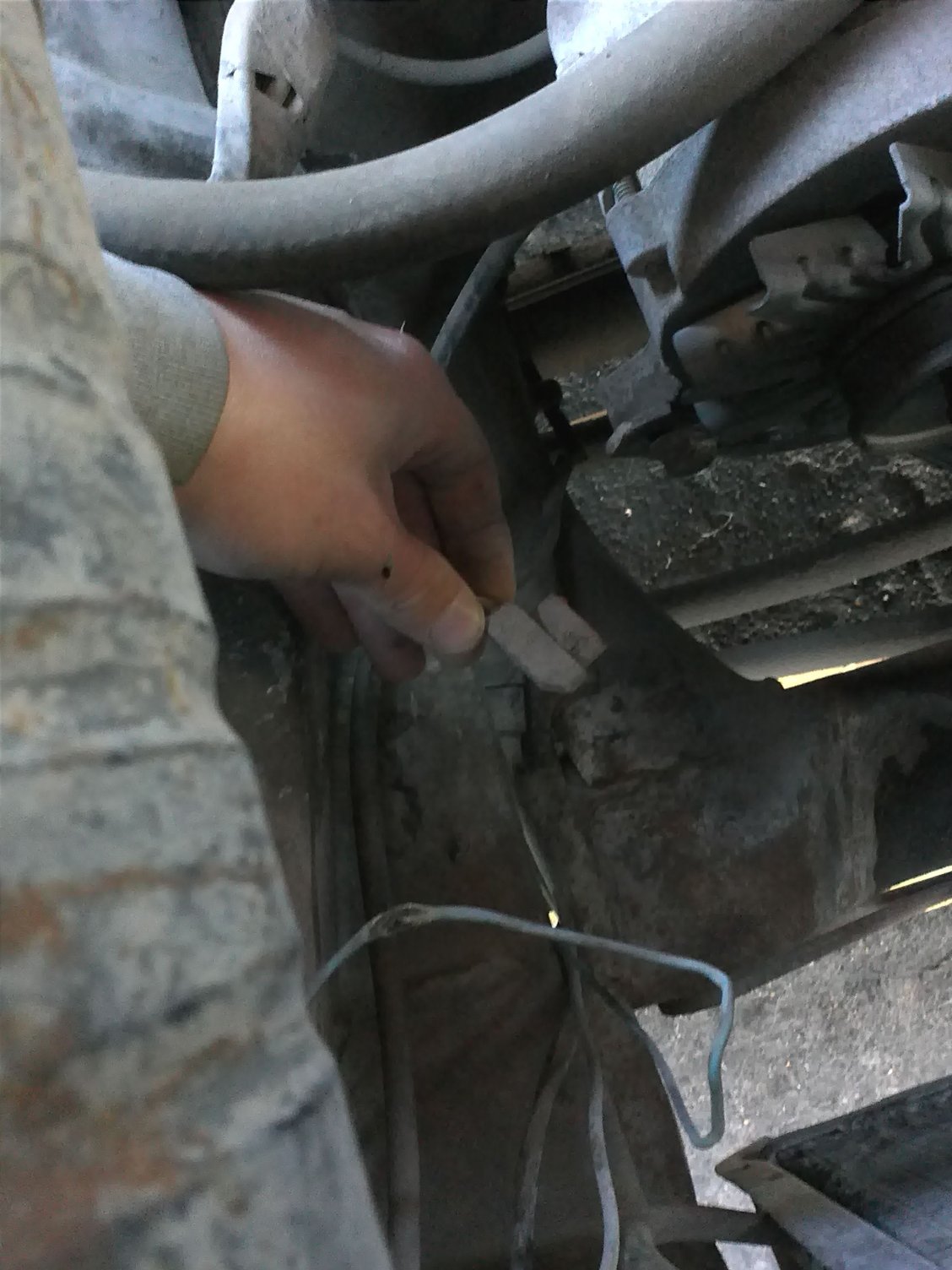

I'm assuming this is a block heater.

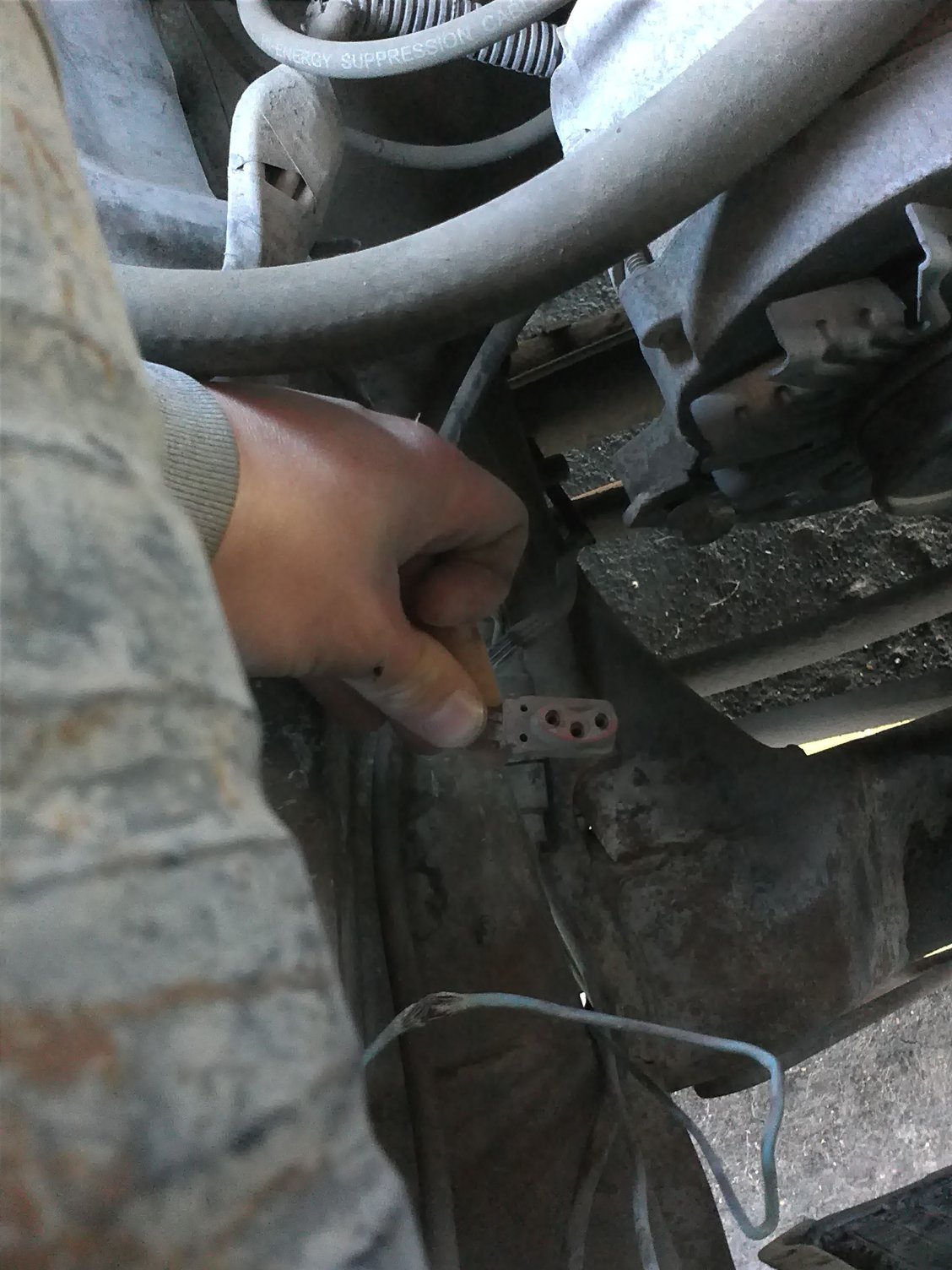

This plug is a lot further down in the engine compartment. I'm not sure what it is or was.

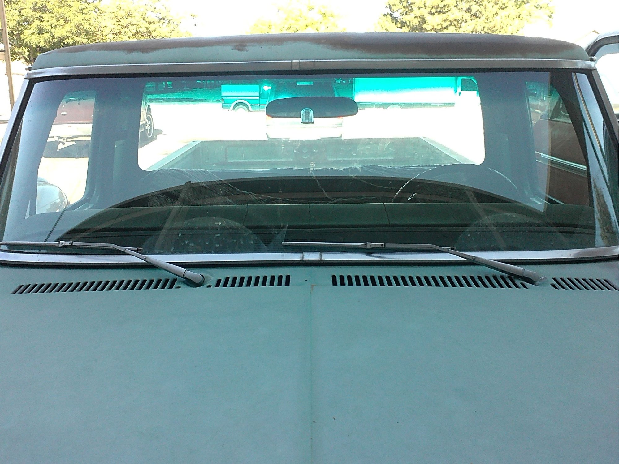

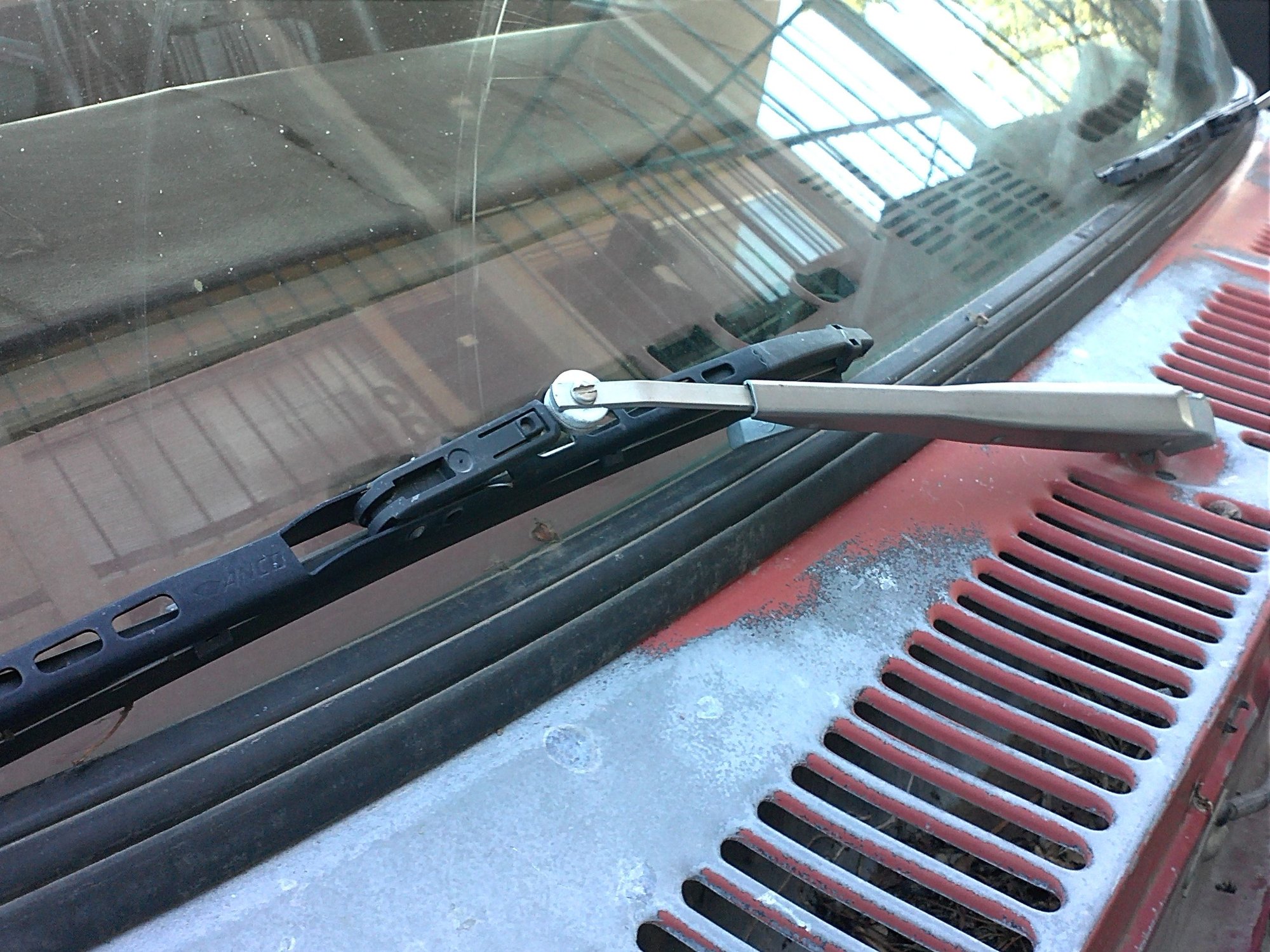

I don't think this passenger wiper arm is factory. I've never seen them adjustable like that before. I personally don't like the black wiper blade holder. I purposely kept the OEM arms/holders on my 77 and just bought some wiper blade refills like I used to when I was 15. Parts stores don't carry them anymore I've noticed. I'm gonna take an arm off my 75 and switch out this adjustable one. I'll have to hit the JY and see if I can find a set of OEM wiper blade holders since my 75 doesn't have them anymore. I hate the black plastic! I really like the OEM look my 77 has with the original arms. Also, make sure your wiper arms are level and in the same spot! I always shake my head when I see these trucks with one blade level with the bottom of the windshield and the other is like 6 inches higher. Gotta keep it lookin' clean!

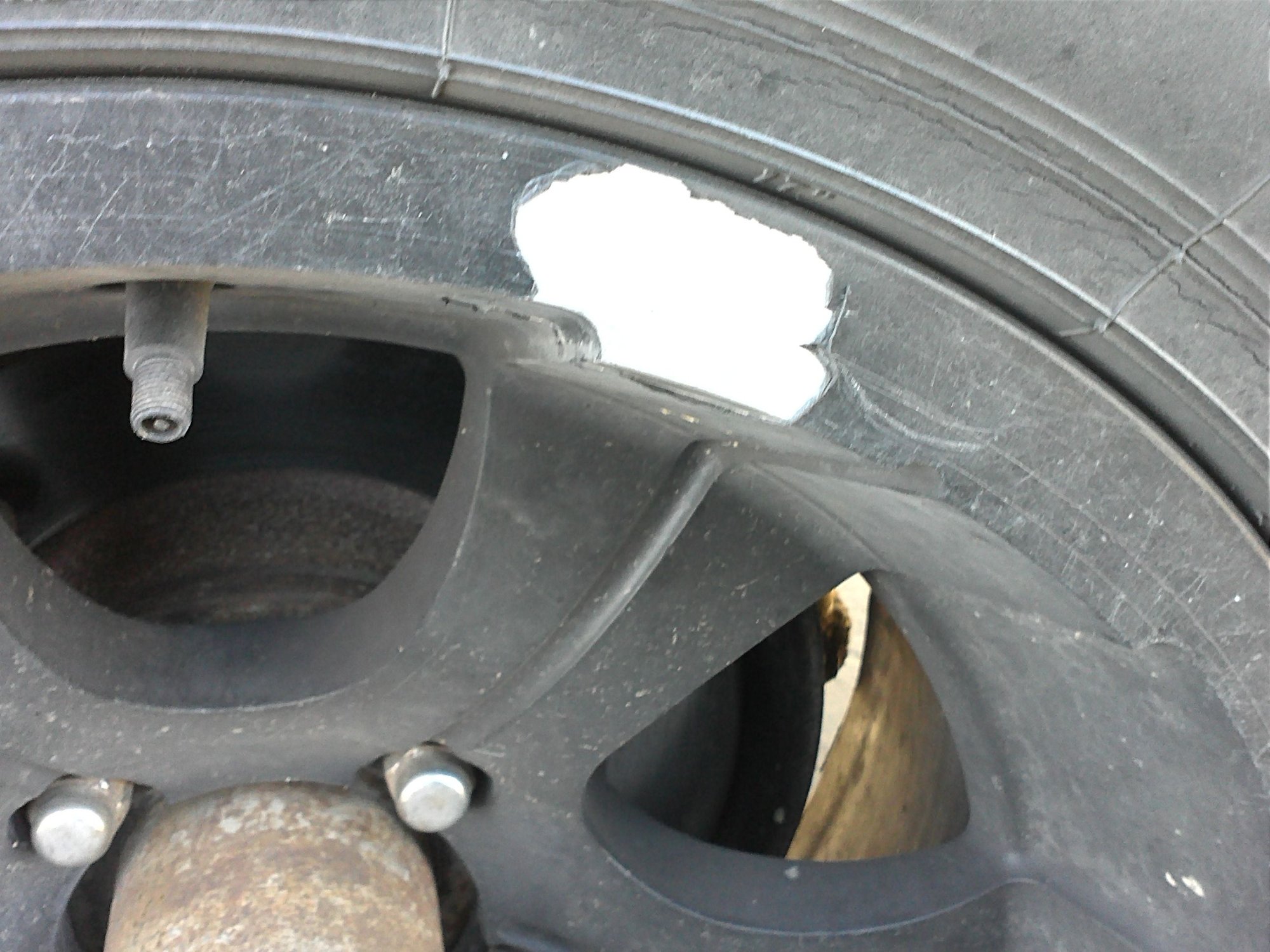

I'm gonna pull off the wheels and paint them up. What do you think, go with a fresh coat of white or something else?

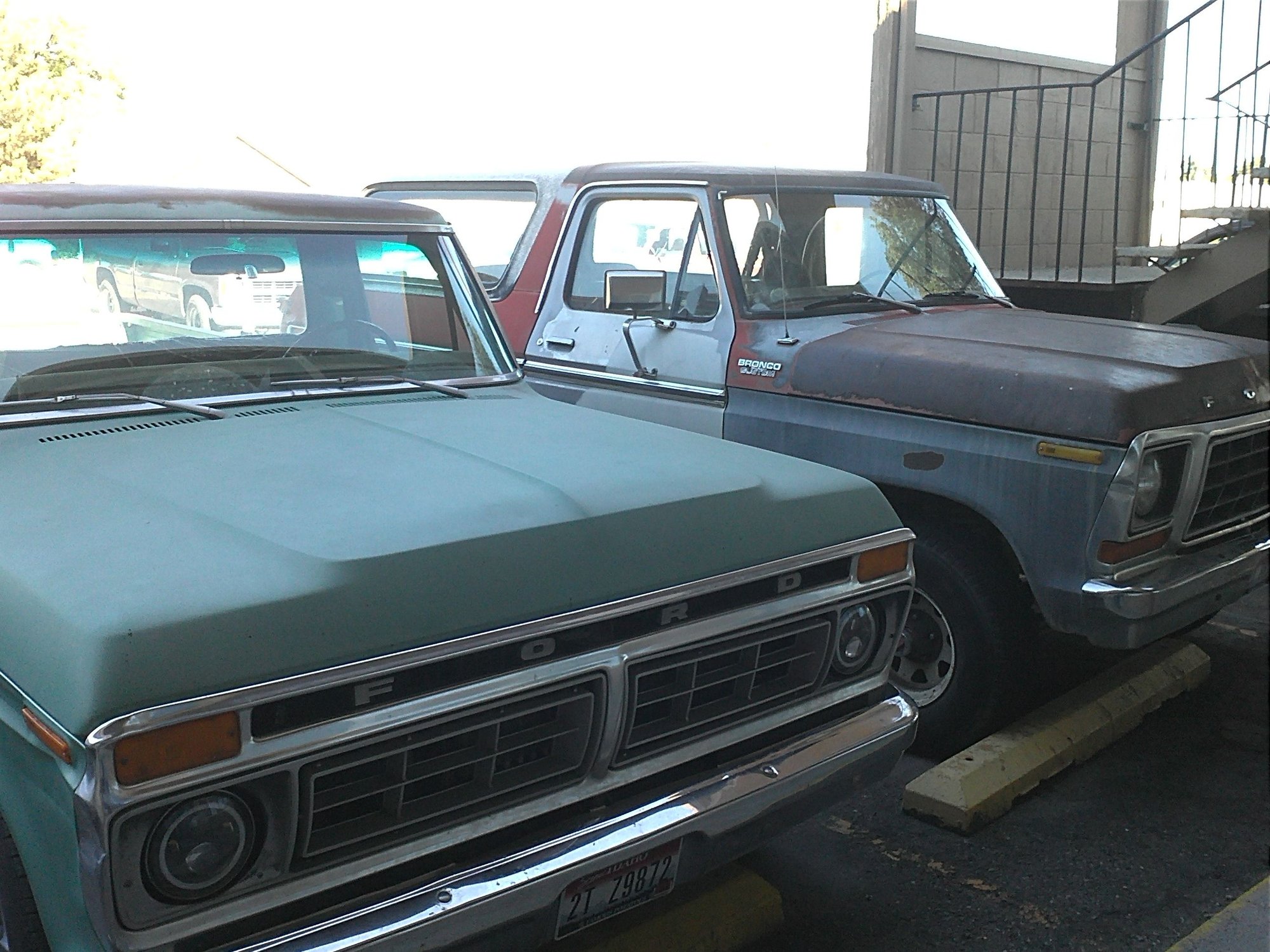

I'm considering replacing the grill shell and grill with the ones off my 75. I'm a bigger fan of the front end of 73-77 F-Series. I'm not sure if I'd have to switch radiator supports or headlight buckets or whatever is needed. It already has round headlights, but they appear to be a little higher up in the grill area than my 77. Maybe the 78/79 front end will grow on me before I get around to do anything to it.

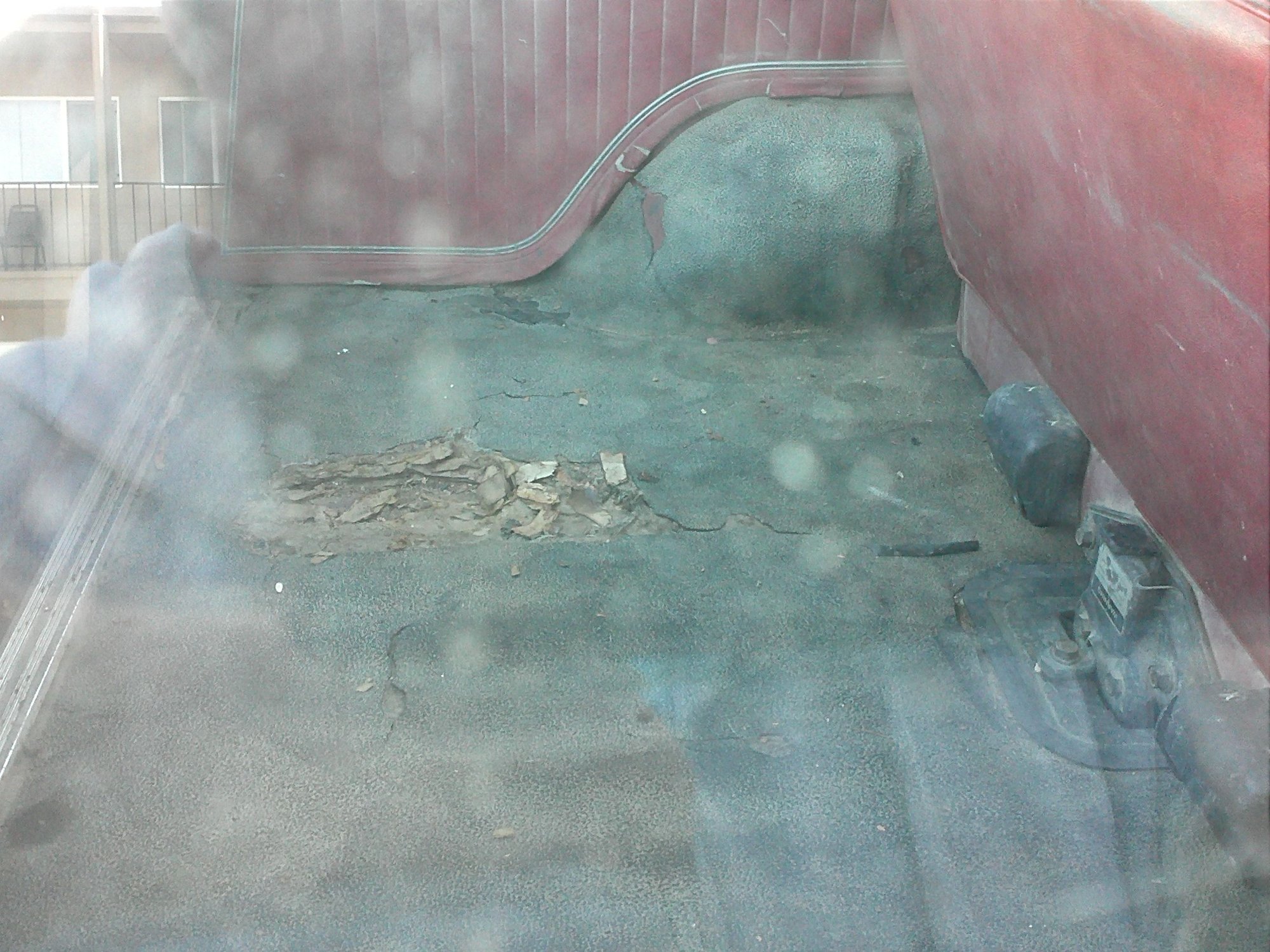

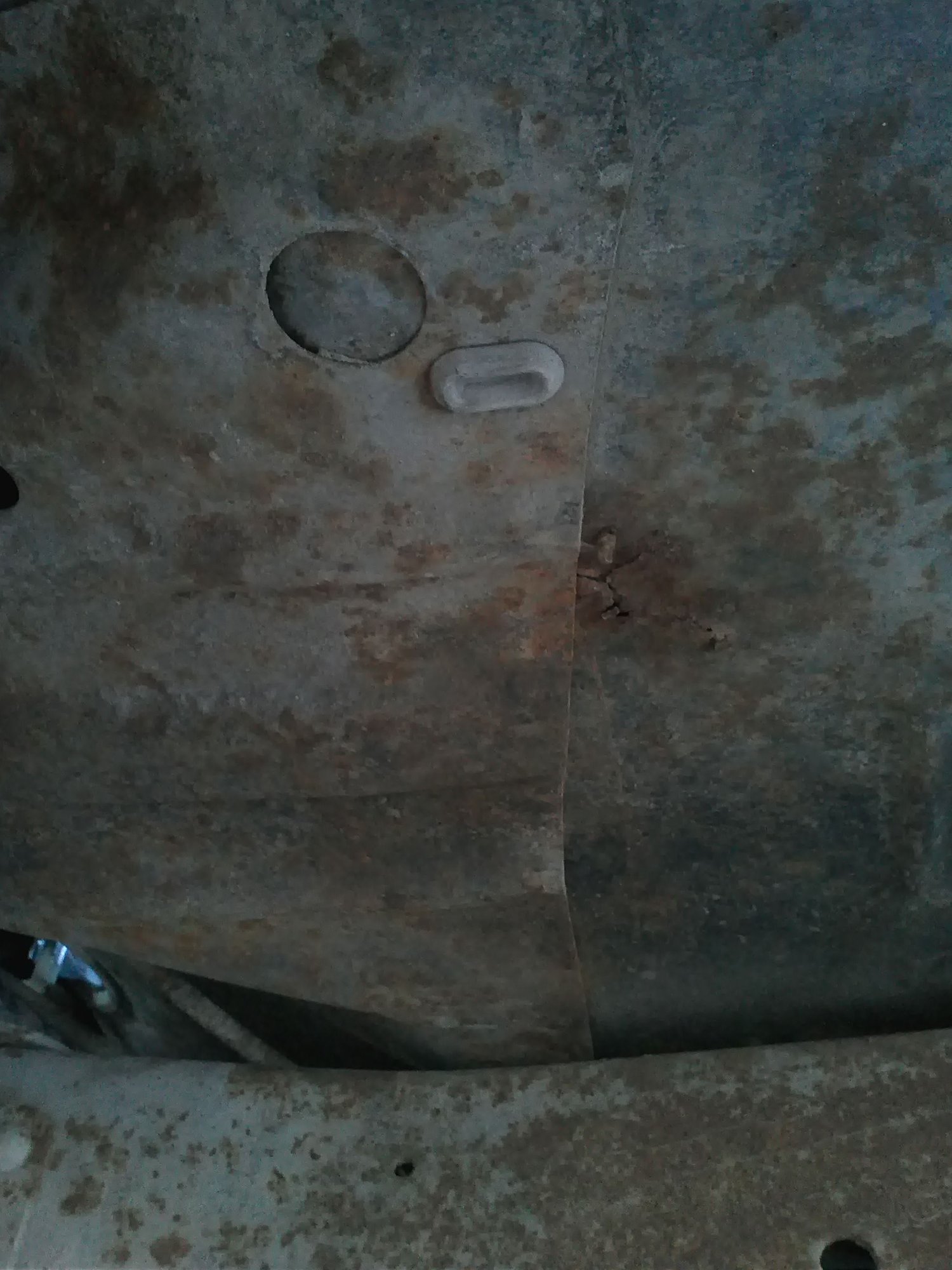

Some shots underneath. You can see the rust in the front floorboards has eaten through in spots. I'll probably tear out the mat in the back to see what's hiding under there if anything.

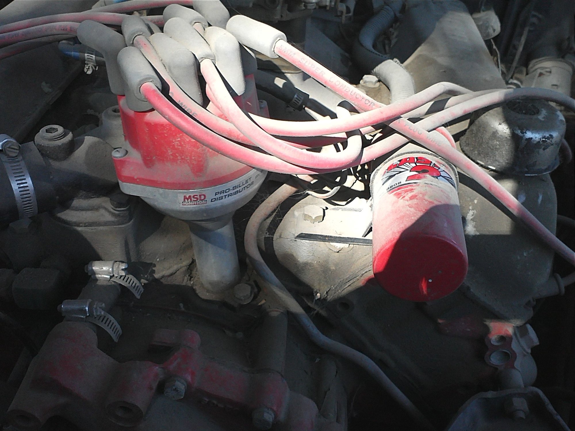

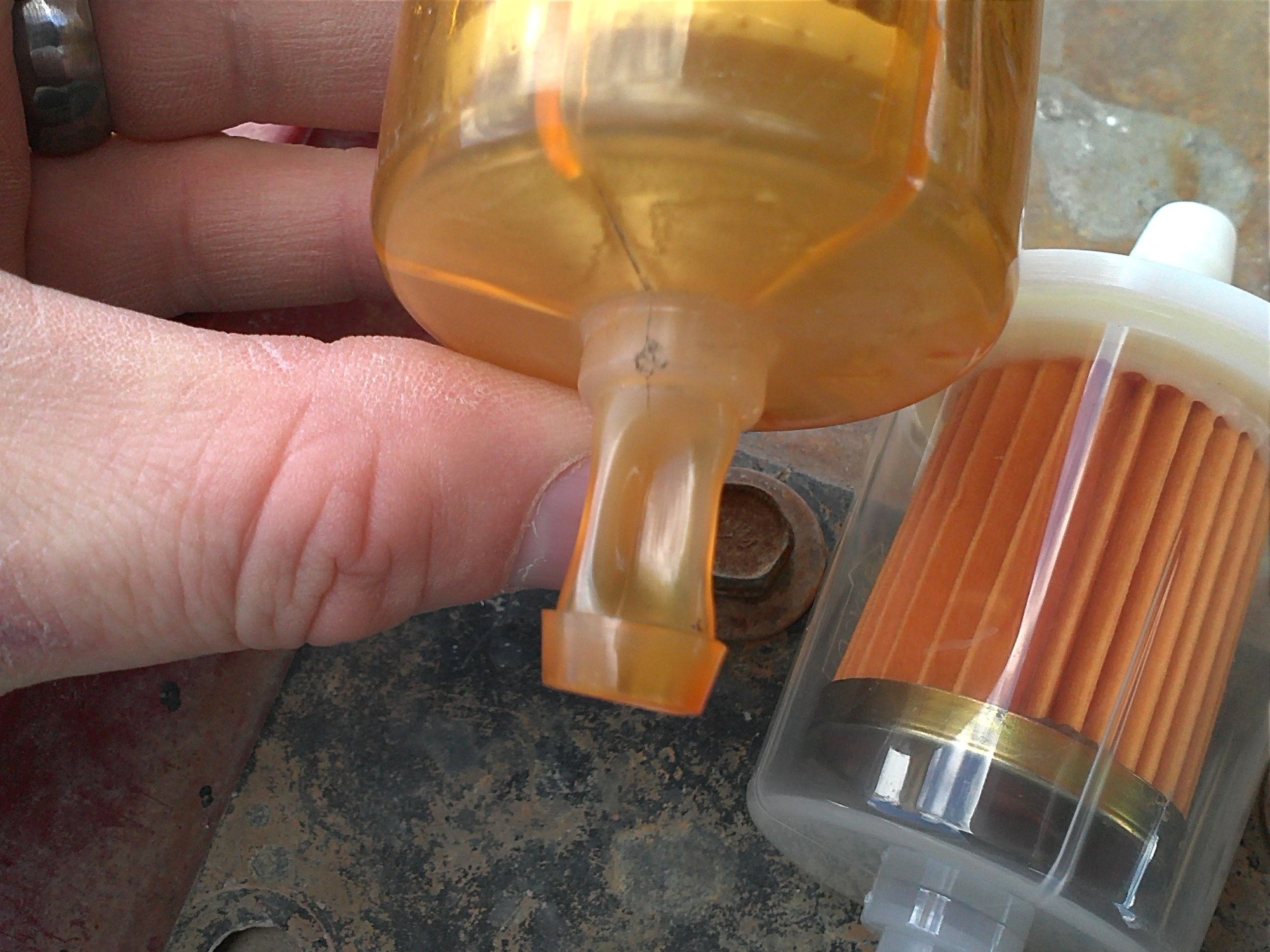

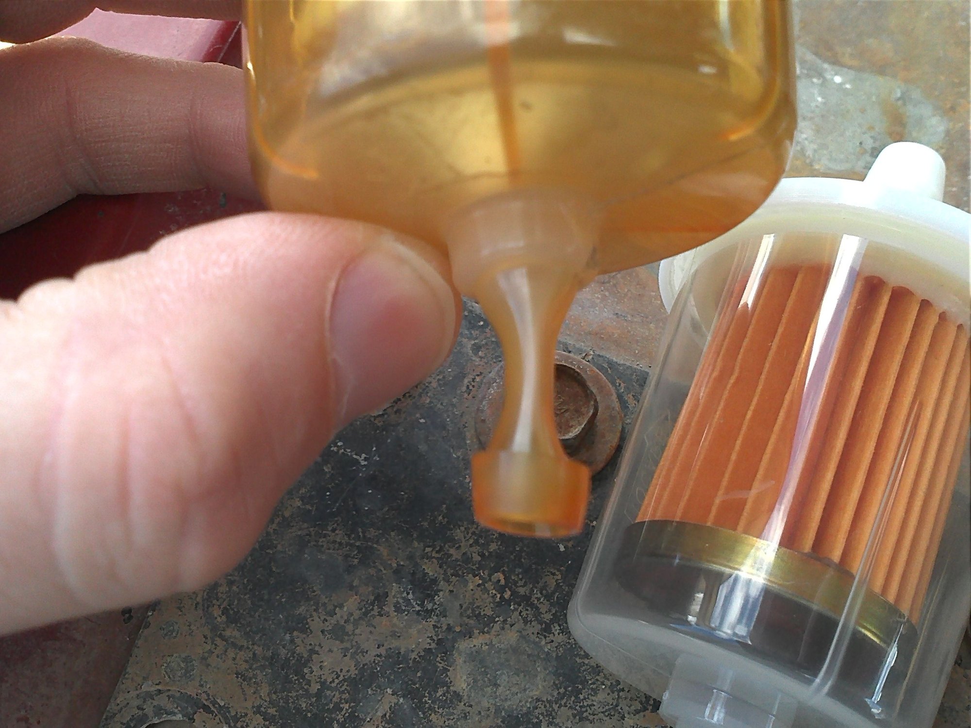

Alright, so the Bronco was acting up a few weeks back. It was bucking like crazy. It felt like it wasn't getting gas. So I started from the top. The carb had gas. The engine started and idled, though it missed a lot at idle and wouldn't hold a steady idle and would eventually die. I checked the fuel filter and this is what I saw.
So, I replaced it with a new filter. No change. The filter never filled more than maybe 1/3 of the way and that's with it laying horizontally. I watched the fuel pump into it as the engine idled and it seemed weak and sporadic like an old man trying to urinate with a swollen prostate. I'm sorry, Bronco, I'll ease that prostate for you! I decided to replace the fuel pump with a new one, I mean, what else do you replace an old fuel pump with? Another old one? Get outta here! Oh yeah, we got good flow. The filter fills up completely, like it popped a little blue pill 30 minutes ago. ARRRGH! YES! Guess what? Still runs the same. The hell is goin' on. Well the last thing I got was gas, so maybe I got bad gas that had water in it... OR maybe there was a lot of condensation in the tank since it's never been over 1/4 full since I got the Bronco. Alright, so I popped in a couple of bottles of HEET and 5 gallons of fresh gas from a different gas station.
It's either that or some 99% isoproply alcohol to help make the water combustible I'm told. I drove down country roads enough to run off at least 5 gallons worth of gas. It felt like it was getting better by the end of things, but I always had to hold the rev high to keep it from bucking. I pulled into town and went home, but it was back to bucking just like it had before. Well, what else makes a vehicle cut out like it has no gas? I thought about how rev limiters work. I'm told most OE rev limiters work by cutting out the injectors so the cylinders get no gas until the rpm drops down. Its also my understanding that most aftermarket ignition systems, like say... an MSD 6AL ignition box, cut out the spark at a given rpm. Well if it isn't a gas shortage, maybe it's not getting spark! I wasn't in the mood at the time to start testing stuff. It was about midnight when I thought of the spark issue, so in order to keep things simple I decided to just swap some known good parts. I looked at the coil on the bronco and it has threaded posts and ring terminals. My F100 has a different style. My F150 that's just sitting there waiting for me to pull parts off it has a complete MSD ignition system. I decided to use the Blaster 2 coil off it because it too has threaded posts for ring terminals. Yes, a Blaster 2 coil on its own works with the OEM Duraspark ignition.
I wired it up and problem solved. I don't know what was going on with the old coil, but whatever it was wasn't able to be seen visibly. Bronco bucks no more. It still has a little misfiring, but that was there before the bucking, so I'll work on that next as far as engine performance goes. I guess in the end that I could have not replaced the fuel filter and fuel pump, but they were both on their last leg, so it didn't hurt to have them replaced.

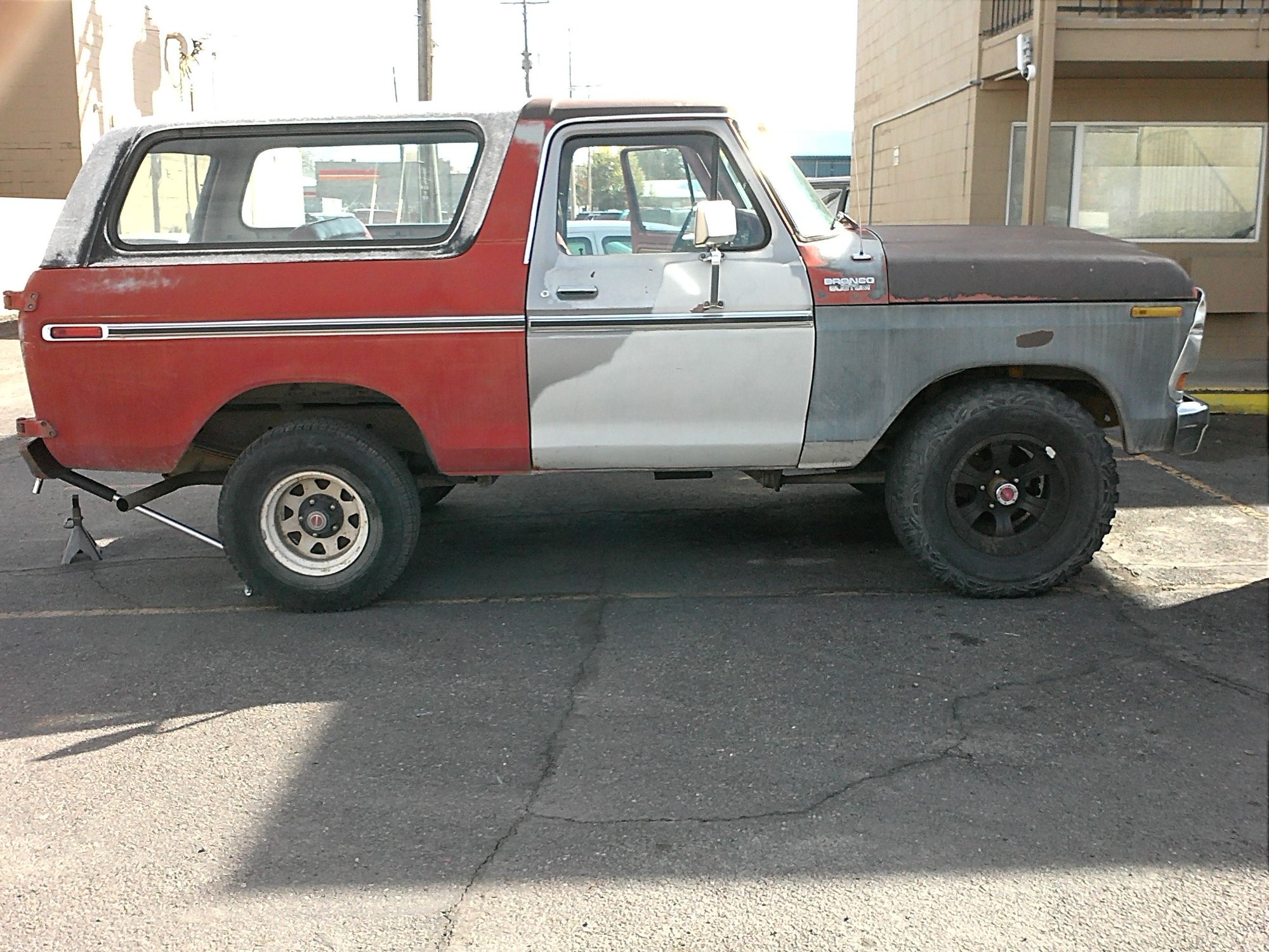

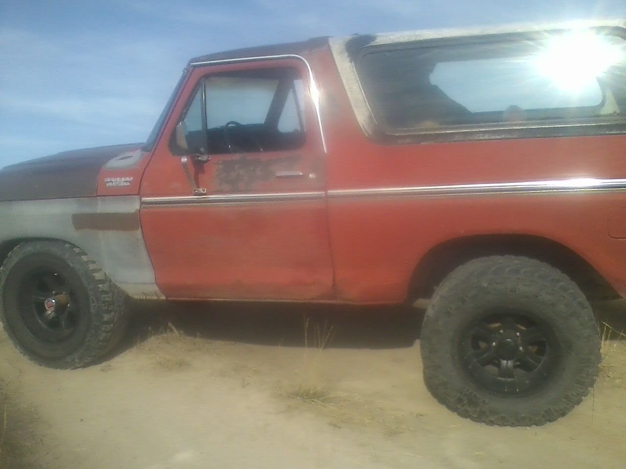

So what does a 78 Bronco look like with one 31" tire and one near bald 35" tire? Why, it looks like this.
Sorry, I didn't bother to snap a pic before I took off the front wheel, so you'll have to imagine what it looks like sitting on the 31" tires it had when I got it. I want 35s on it. I need 35s on it. I love when trucks or SUVs have large tires with no lift, they look more muscly to me for whatever reason, maybe its the filled wheel wells. I was able to get a relatively cheap ($200) set of 17" wheels and worn out non-matching 35" tires the other day. I realize that with full tread they'll be bigger, obviously, but they do fit. The stock rims with 35s might be a different story and I did try to find some used 35s to try it out, but no one had any used 35x12.50r15's. I don't know the width of the rims, I'm guessing maybe 9" but there's a -12 on the back of the rims and I'm assuming that's the offset in millimeters, which would be just under 1/4" of negative offset. The tires DO rub, but only when flexing the suspension and its also due to MT's having thick side lugs compared to your average AT tire, like the 31's that were on it. I think if these rims had been maybe a 1/2" negative offset rather than 1/4" that it would have been perfect without a modded suspension anyway. Here's a look at it with all the 35s on.
I need to hit up ebay and find some front center caps for the 4wd hubs. I have four center caps, but I'd, of course, have to cut the ends off of two of them to make them fit the front hubs, which I don't want to do. I took it "wheeling" the past few days and I use that term loosely. There's an area across the Snake River Canyon from the town I live in that people use for off road fun, mostly of the dirt bike and four wheeler kind. It's high desert and lava rock and at some point over the last few years the state fenced off the best (and in my opinion the only real good spot for using trucks) spot for mudding and climbing, so my options were limited, but it was still fun to get an idea of what this thing can do at the moment and where I might want to make upgrades. It doesn't really flex much with factory suspension, plus the factory sway bars are counter productive since they want to fight what it is that you're trying to do. Here's an idea of how much it currently flexes. Sorry for the pic quality on these, I was using my "dumb" phone when I was messing around out there.
I'll try to make some disconnects for the sway bar end links to get some more flex and see where that puts me. I would just take them off, but I like the way it handles on road, so I don't really want to mess with a good thing.
The guy who sold me the wheels and tires plasti-dipped them black, which I'm not a huge fan of. I peeled some of the black off and revealed what appears to be machined aluminum. I googled the brand name and I think this is what they look like underneath. Not too shabby, I'll have to take all the plasti-dip off.

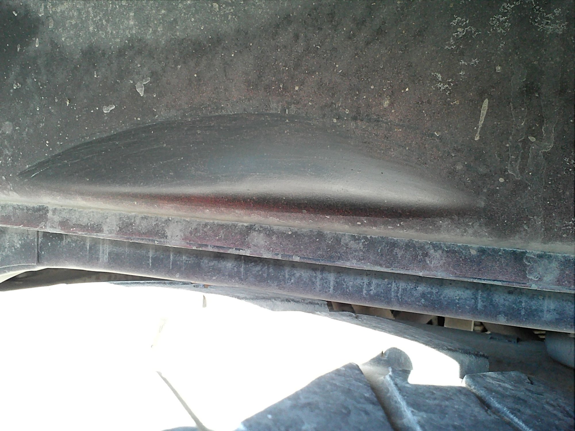

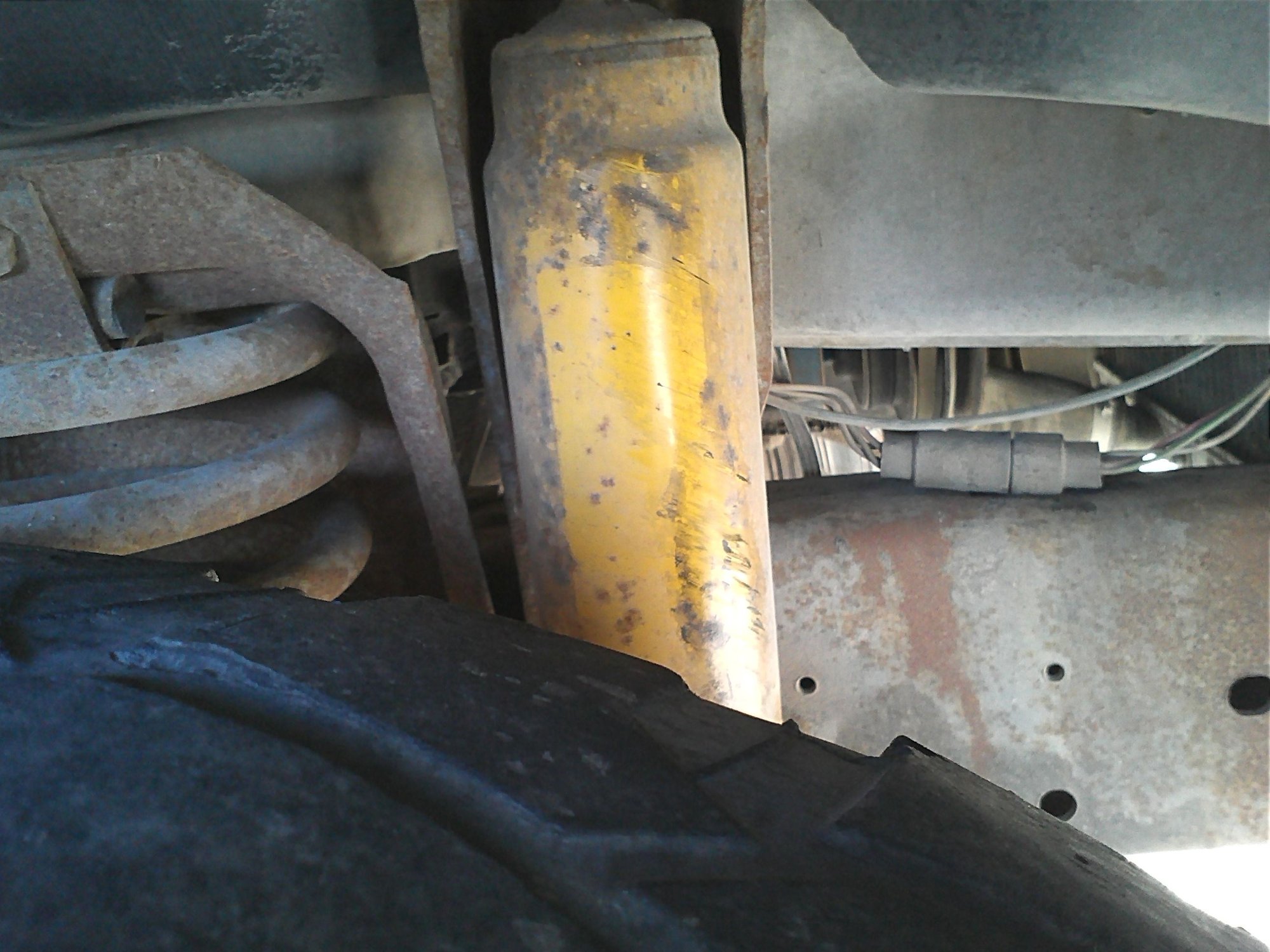

Here are some pics to show where and how much the tires rub under flex. You'll notice that the driver side rubs more than the passenger side and the front rubs more than the rear which, of course, is because the front wheels turn! I only took one pic of the rear since both sides rubbed the same amount, not even enough to take off paint.
Driver side.
Passenger side.
