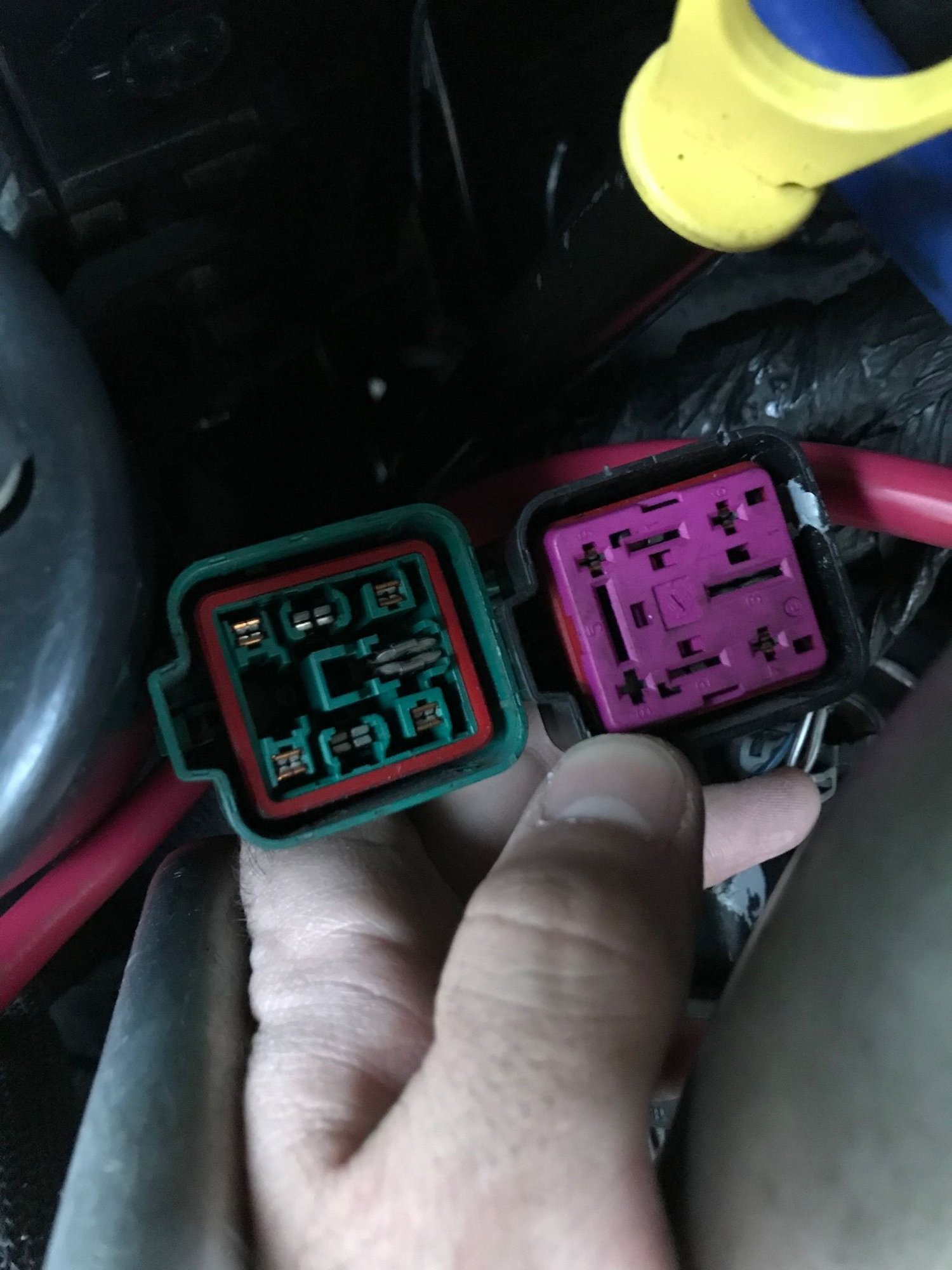

Ok I just tested all 8 plugs via the black and green connectors at the GPCM. Each one checks out 100%. Which is a relief, my harness must be ok and the plugs themselves are ok. Must be the GPCM. Some monkey lost the pink piece on the green connector in the past Looks like I had a two part problem.

We'll I'm happy to report that I am glow plug code free for several days now. I replaced the GPCM and the remaining 2 codes have disappeared
So to sum it up I did have a compound problem. Thanks for the help everyone
