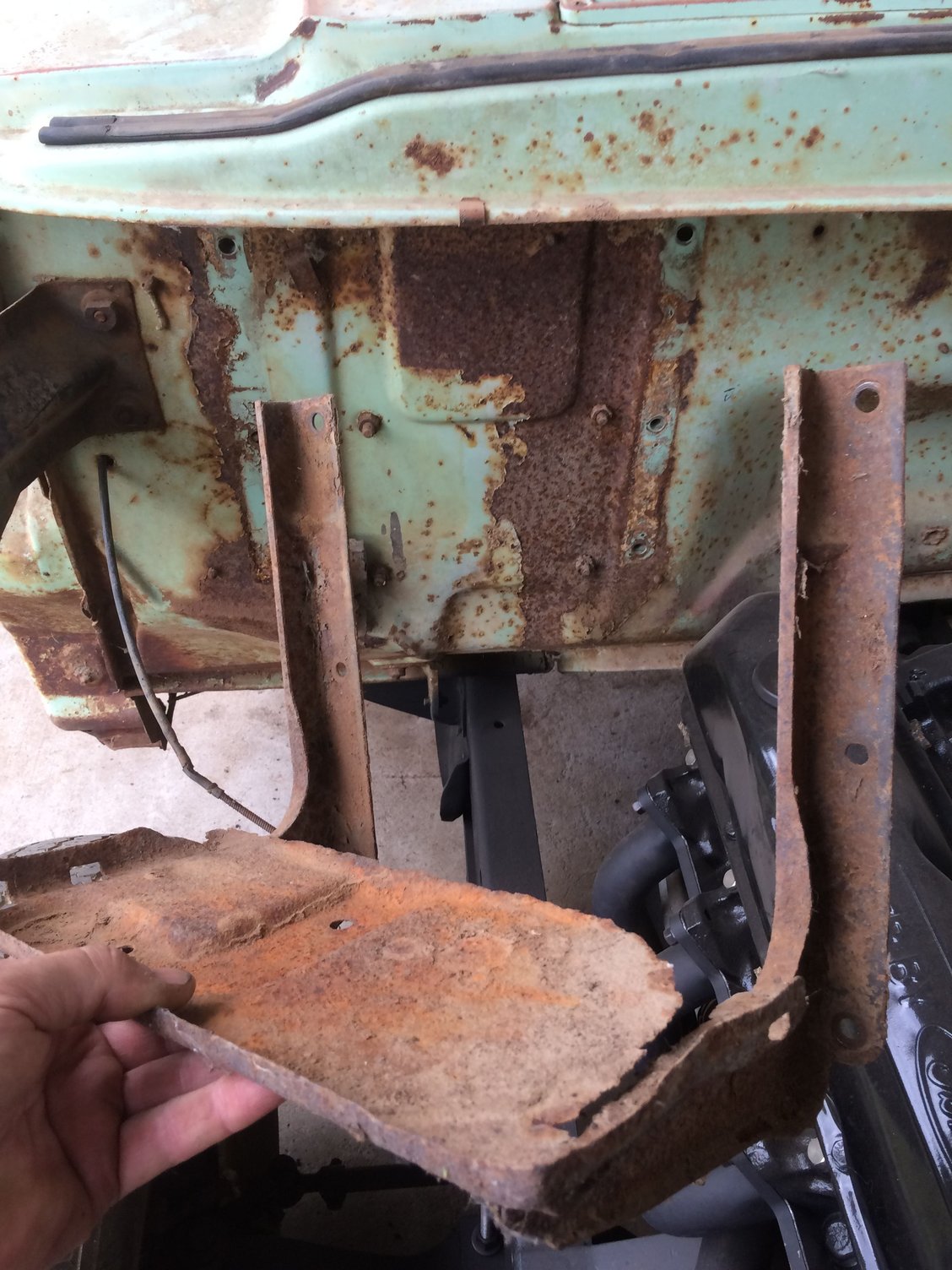

Can anyone tell me if the battery tray I have is the correct one for my '57? I'm checking catalogs, etc and this seems to be one from a later year? Like the '60's?

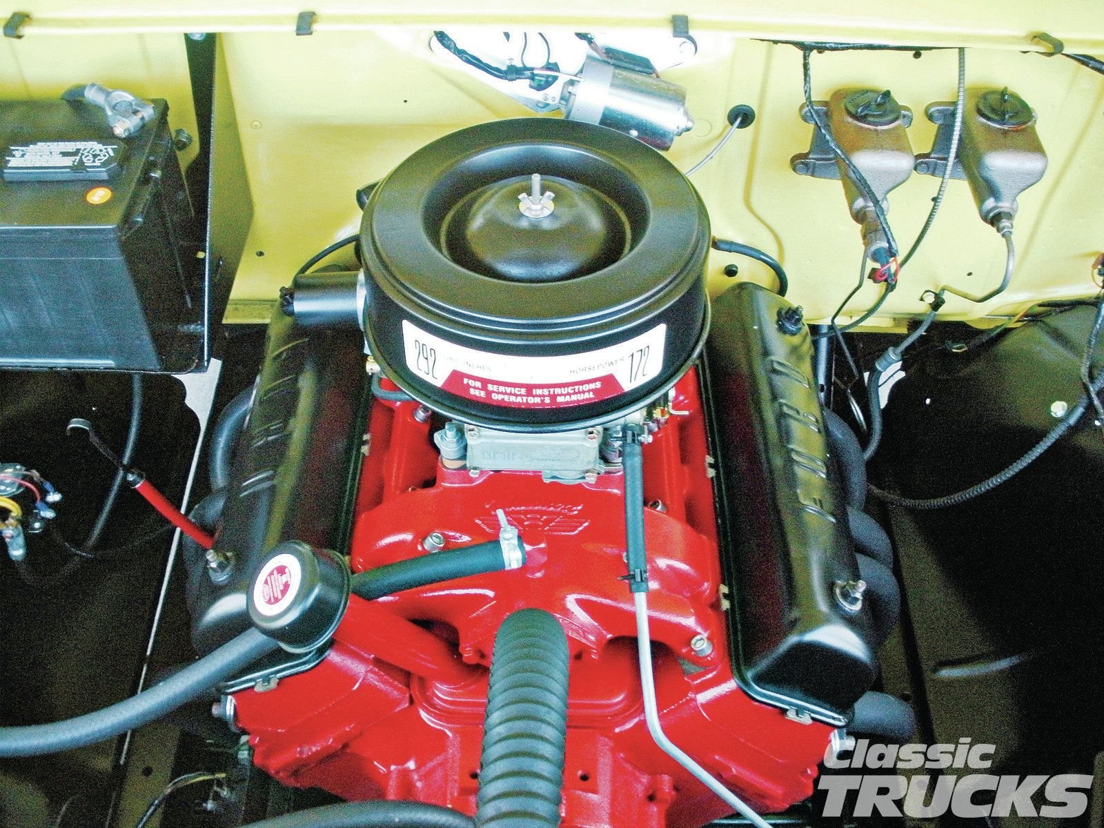

Here is a tray from a '58. Don't know if it would be the same or not.
Old Sep 12, 2017 | 09:04 AM
flhx06's Avatar
flhx06
Joined: Dec 2007
Posts: 276
From: San Rafael, Ca
I would think that '57's and '58's would be the same. I just bought one from LMC that is supposed to be for a '57-60 and it doesnt look like yours OR mine. Confusing!

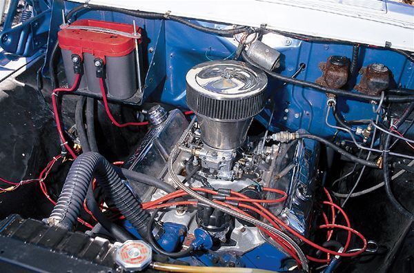

I googled 1960 f100 engine images and found a bunch of photos that show the battery box. All look the same (different than mine...). Here are a few.
Old Sep 12, 2017 | 11:54 AM
flhx06's Avatar
flhx06
Joined: Dec 2007
Posts: 276
They all look pretty similar though. Thanks for the effort!

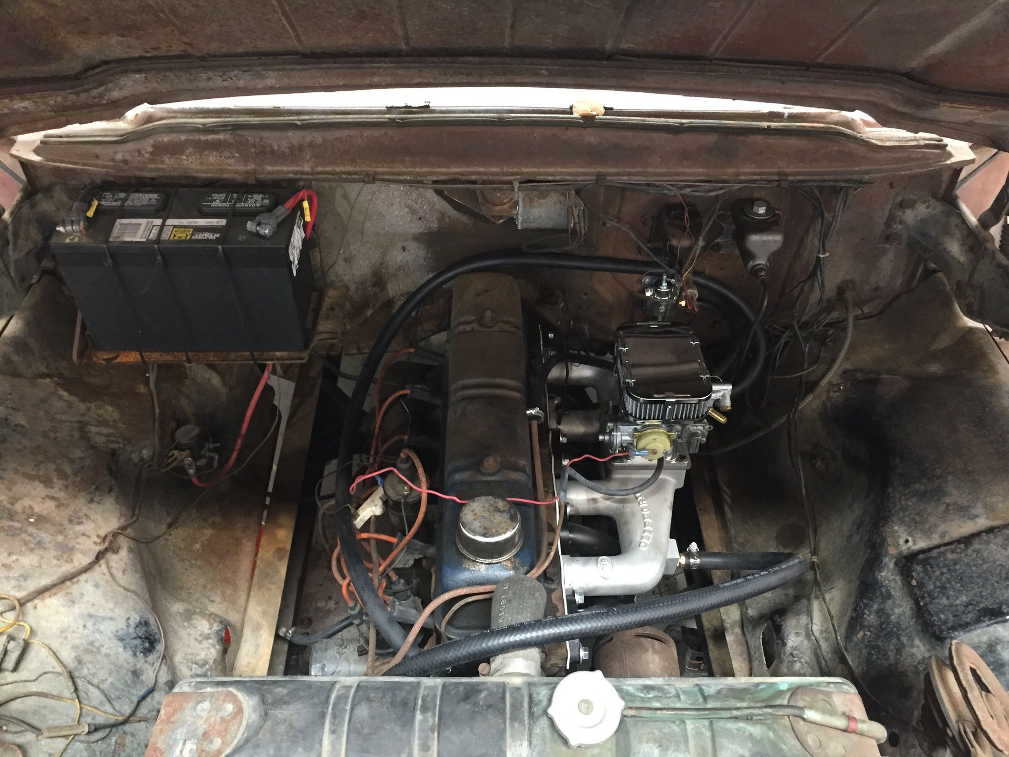

Here is my 60.
Old Sep 12, 2017 | 05:18 PM
flhx06's Avatar
flhx06
Joined: Dec 2007
Posts: 276
I would expect mine to look like yours Walston. Basically like a shelf hanging off of the firewall. But mine has a leg running down the firewall underneath one side as you can see in the photo. I think this is a tray out of a later model truck. Not to mention that the mounting holes on the fender side of the bracket dont line up with the factory mounting holes.
Yup My 57 has the same one.
It appears that the battery carrier (as Ford calls it) was changed for 59 and 60.
In 1957/58 the F100-600 had a part number of B7C-10732-C for the 50 Amp Hrs. battery or B7C-10732-D for the 70 Amp Hrs. Battery
For 50 and 60 in the F100-600 the part/number was changed to COTB-10732-A for all battery's
So the 57-58 could have one of 2 trays and the 59 and 60's should all be the same but different form either of the 57/58 tray's.
It would be nice to pin down which tray was what part number for the 57-58's

OK I think I have this sorted. If any one has comments or needs to correct it speak up.
The OP's (flhx06 ) battery tray (See below) appears to be be from a slick 61-64 the part number is C4TZ-10732-D this tray is reproduced.
Battery Tray Assembly | Dennis Carpenter Ford Restoration Parts
The Hold down Clamp is a top mounted clamp and does not appear to be reproduced.
But the tray does appear to able to use the C5DZ-10718-A side clamp mentioned later on.
The tray is also the same as the trays I have seen on the web in early slicks.
Martin Torres Battery Tray (See Below) Is the same as mine and is either the 70 amp hrs. one, part number B7C-10732-D Or the 55 amp hrs one part number B7C-10732-C .
Both of these battery use a top mounted hold down clamp part number A0A-10718-B. That appears to be reproduced.
https://www.larrystbird.com/product/...ard-battery-2/
My Canadian 1957 MPC lists the B7C-10732-D as "dash mounted battery 5-5/8" wide x 14-3/8" long - excluding 2 bolt holes on diagonal corners".
I believe the one pictured below from Martin is the 55 amp hrs battery tray part number B7C-10732-C.
