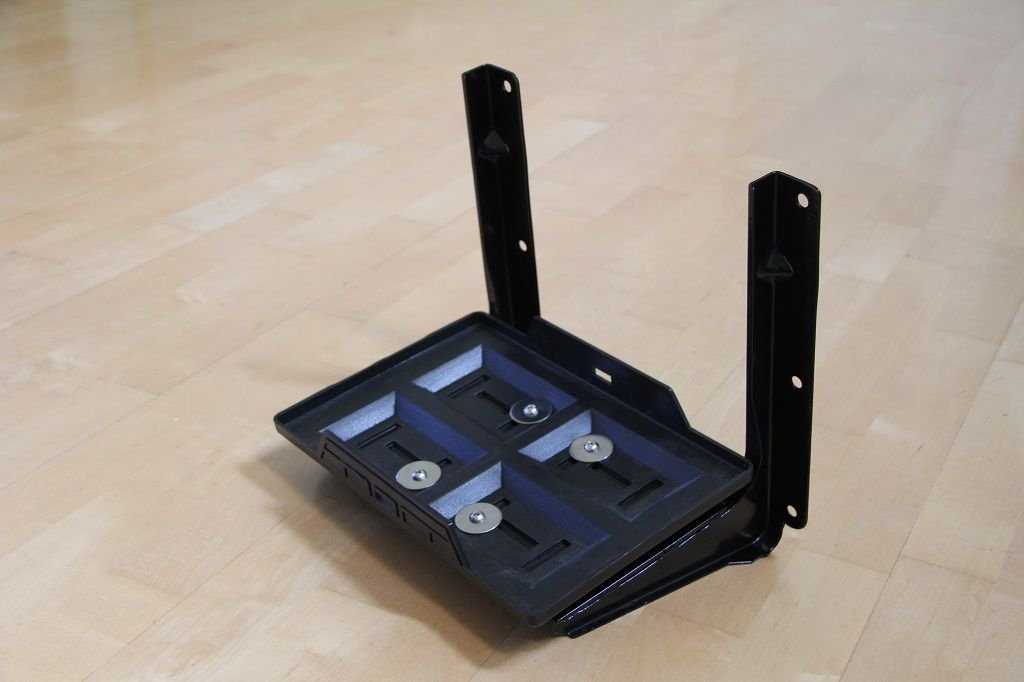

My battery tray was also toast from years of use. I managed to find a couple of used, stock trays and removed the "L" bracket that is closest to the engine. This bracket is nice and flat along the bottom edge. I welded a new, flat plate across the bottom of the two brackets and then had the assembly powdercoated. A new plastic battery tray was then bolted to the new flat plate using stainless fasteners. The plastic tray I chose fits the Group 24 batteries and others of similar dimensions. In a pinch, you can almost always find a Group 24 battery.
During the installation, I added a new set of 5/16 caged nuts on the back side of the firewall and 6 stainless hex bolts.
The install was finished off with a couple of stainless "J" bolts and stainless hold down bracket. Hopefully this tray will out live the stock version that came on the truck.
