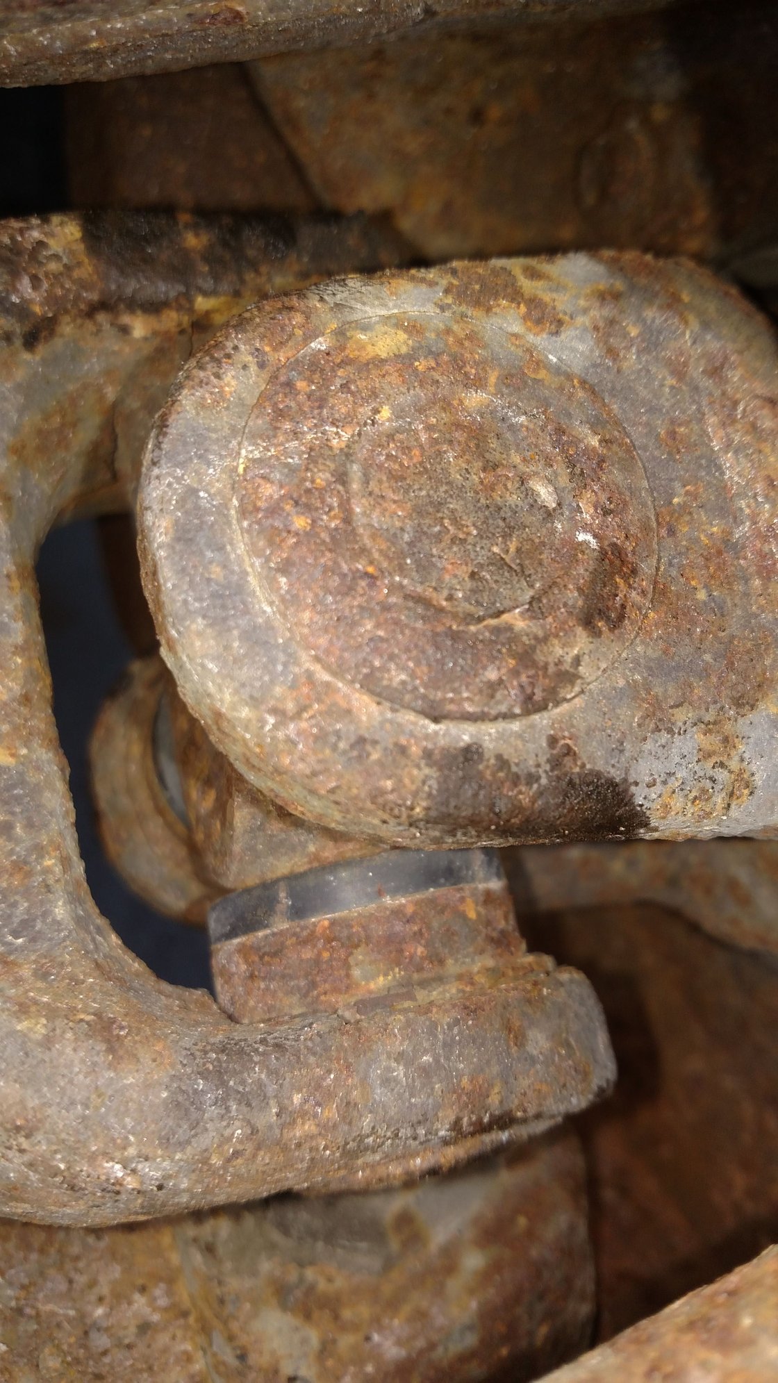

Second question involves chasing a vibration at 70mph. I was looking at the front u joints. What are the caps on the out side of the knuckle? Do they remove?
I had my tires balanced and rotated. Didn't seem to change much. I replaced my drive line u-joints.
If I drop the truck into neutral the vibration does not go away.
So any thoughts?
Thanks.
If you are talking about the caps on the axle yoke then those are the u-joint caps. They have to beaten or pressed out.
The only things I can think of as being a 'cap' on the knuckle would be the inner seal that is pressed onto the stub shaft or the axle tube seal (that usually breaks off and hangs on the axle). In any case you have to start pulling things apart to get anything off.
