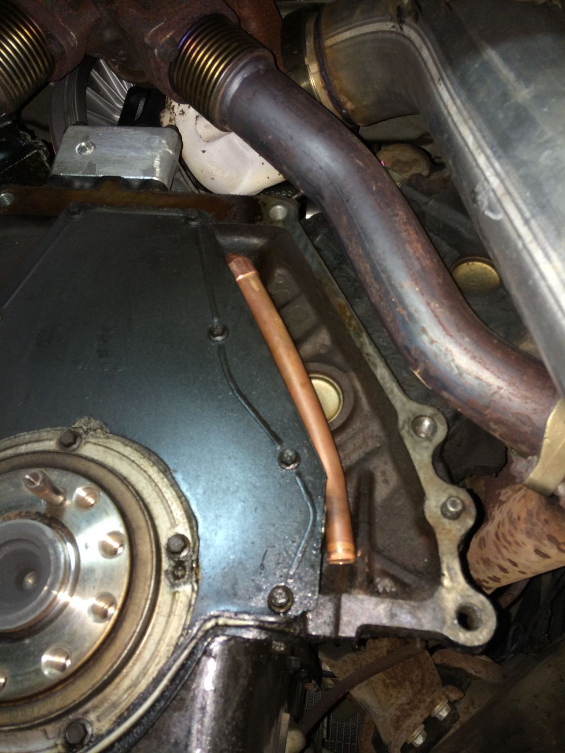

I have an oil leak from the bell housing of the transmission. Do I start with a rear main seal and perhaps go ahead and dive into a clutch kit, or start in the V?

On the steering box there is a lock nut with a screw sticking out of it up top, loosen the nut and try screwing the screw in a little, it can help tighten up the box but be very careful, only make minor adjustments (like 1/4 turn) and check for improvement. Too tight and you'll blow the box.
Rear main seal rarely goes bad, oil leaks up top drain through a hole in the back and down the transmission bell housing. So look up top for your oil leak(s).

Rear main seal leak is unlikely. As Mark mentioned above, you probably have a top side oil leak and it is coming down through the drain in the rear of the valley and out of the housing. You can see in the picture below where a friend of mine installed a drain tube in order to get the leaking oil directly to the bottom of the truck, instead of getting slung up on the flywheel or clutch pack.

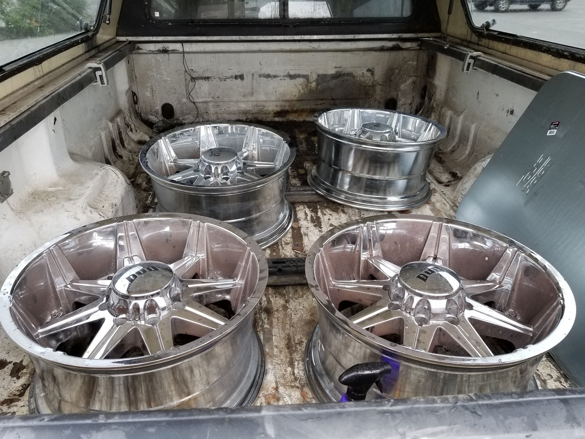

3. Wheels in the bed for sale and recoop a bit of cash or reutilize on another vehicle.
