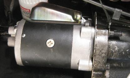

Yes that looks familar....
Hey Rojostar
YES that looks very similar - so my question is, the middle (top) bolt there... I don't see a hex head on that one, on neither the same side as the one below, not on the side of the starter?
So how do I remove it?

It maybe a through-stud, so you just put a deep well socket on the nut and remove it.
That looks different from the one on my 4.0 v6.
