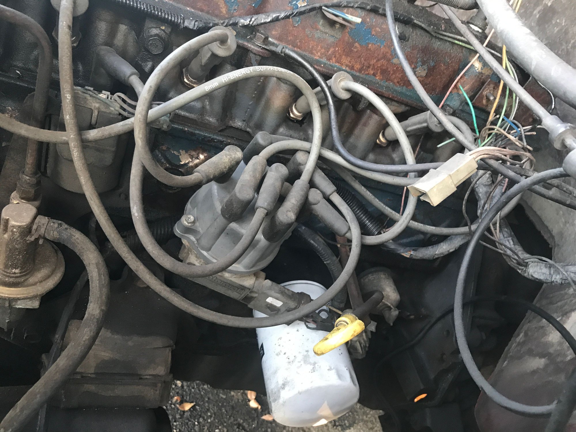

Gentlemen, my sincere apologies! The truck is an '84. The first year of the feedback as I understand. I'll have to snap a picture of the dizzy tomorrow when. I have some light but it is absolutely a TFI system. No vacuum advance here. There is a HACKED TF UP wiring harness coming from the firewall.

If you have the TFI distributor, then you don't have any advance on the distributor aside from mechanical. Your engine will run just fine, but you won't be getting the added benefits that advancing adds, such as gas mileage. Getting a proper DSII distributor in there that operates off of vacuum will still help.

Here's the current ignition and (butchered)wiring setup. I've also got a cold start video if that'd be of any interest, of the truck starting in 50* range after sitting all night. I'm in NC unfortunately, so it doesn't get TOO cold. I believe I might have issues as it gets colder, but I'm just impressed that this truck fires up and runs so well without any of its "essential" feedback.
Question- Id like to purchase the DS2 setup new, and can piece together the Distributor, Coil, ICM, and Plug Wires from RockAuto for about $100ish. I can buy the American Autowire, harness from SR for $103. If this mystery YFA is indeed a non-feedback model, that should be all I need, correct?
