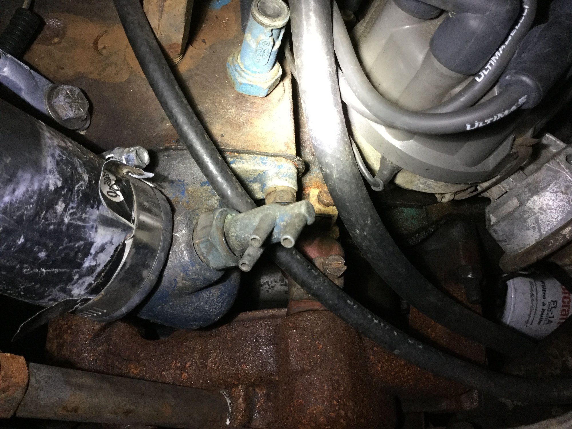

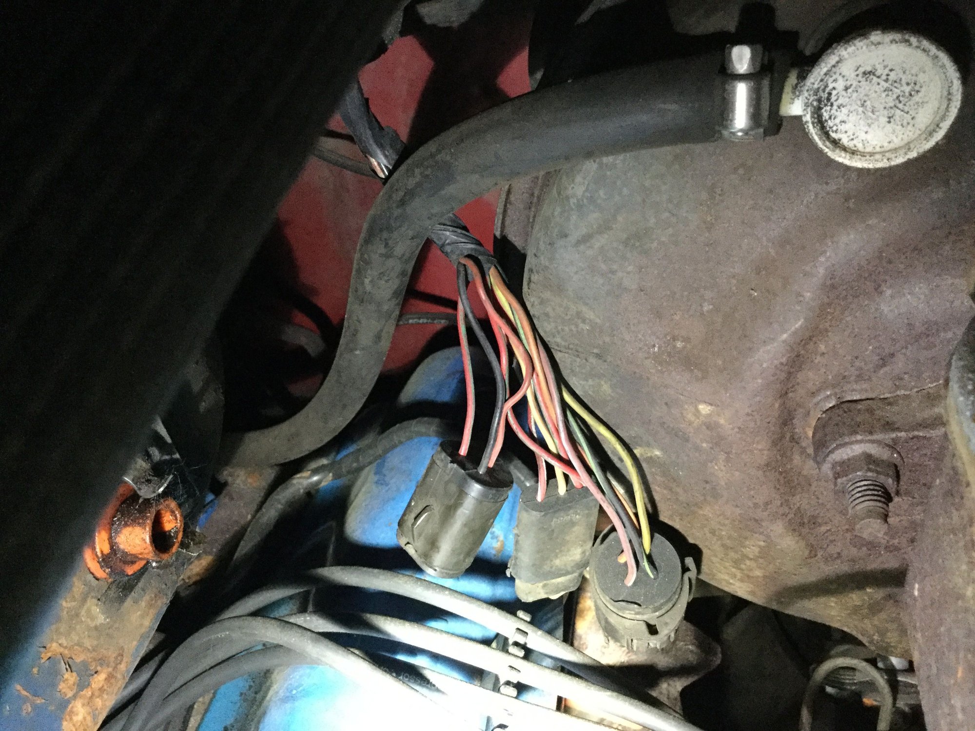

Anybody know what this plug is for?

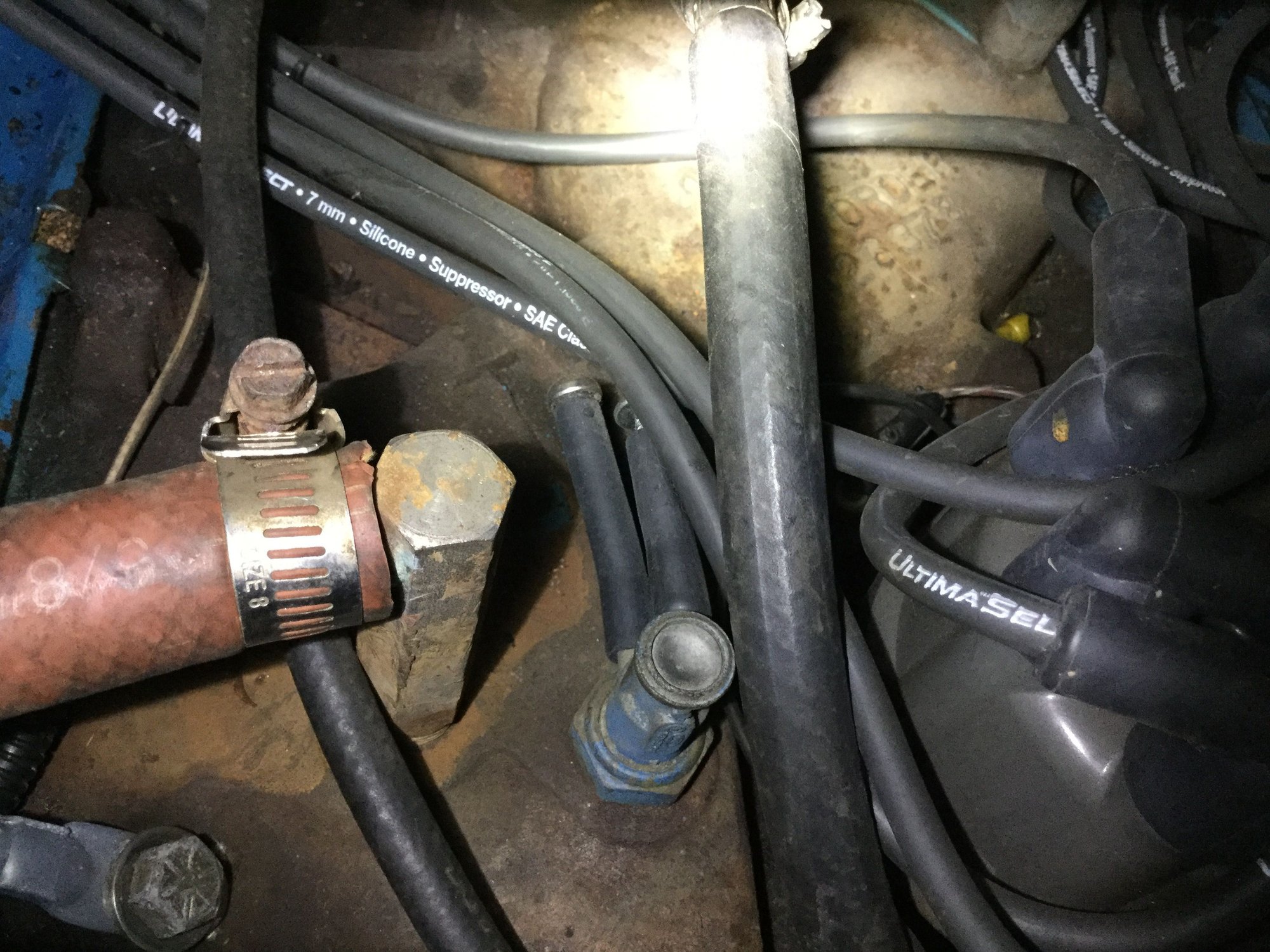

The next 2 pics are vaccum lines. My truck has a small mis and I'm thinking it's a vaccum leak. I would like to get things back to where they go. I'm not sure.

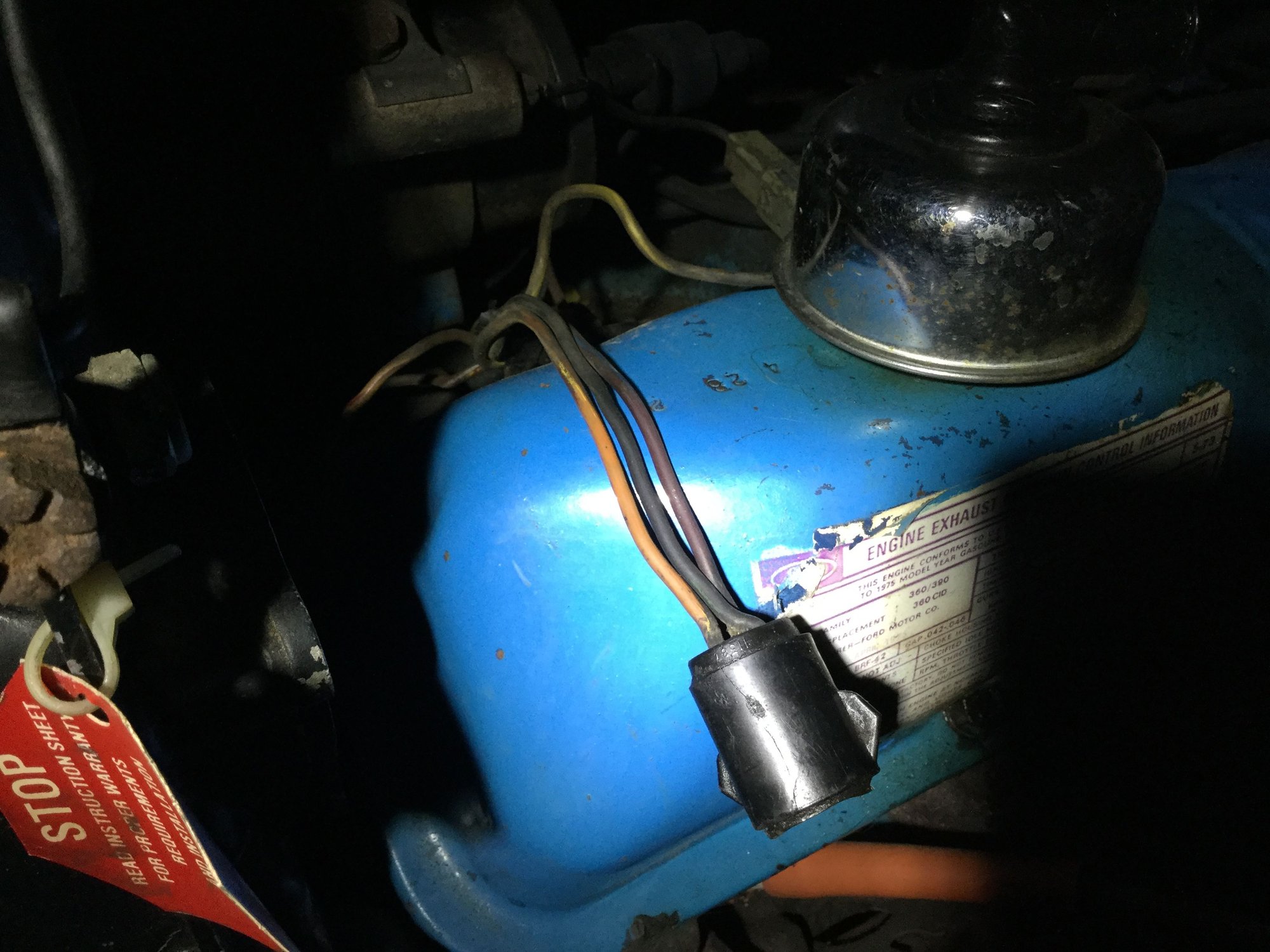

The last one is another plug coming from the firewall. Red/green stripe wire,black and red wires.

The first pic looks like the harness for the distributor.
The vacuum nipples on the thermostat housing are not vacuum sources-they're not a cause of a vacuum leak.
The vacuum hoses with screws in them could be a problem. If you're not using that tree, pull it out and install a plug
Fortification has wiring diagrams that will show you what the other plugs go to.
If it runs as it is, perhaps it's been converted back to a points style ignition. That'd explain those unused wires.

The middle two both look like Temperature Controlled Vacuum Switches. Does the one on the manifold go into a coolant passage?

Get a mirror and take a look at the back of your carb, there is a vacuum port back there that may be open.
