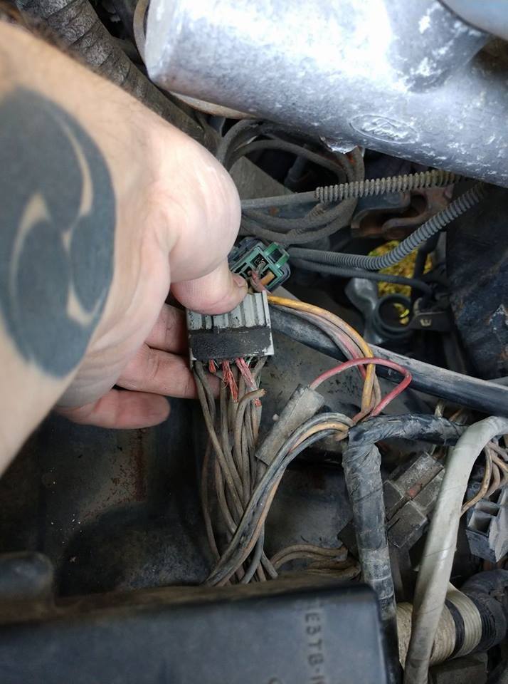

ok while i was waiting for your reply i unhooked the NSS connector and jumped the wires and the starter kicked on. so i am not sure what that says but its a start. So just to clarify i need to unplug the long rectangular harness that plugs into the firewall and try to start it with the brake pedal. correct?

found it.
