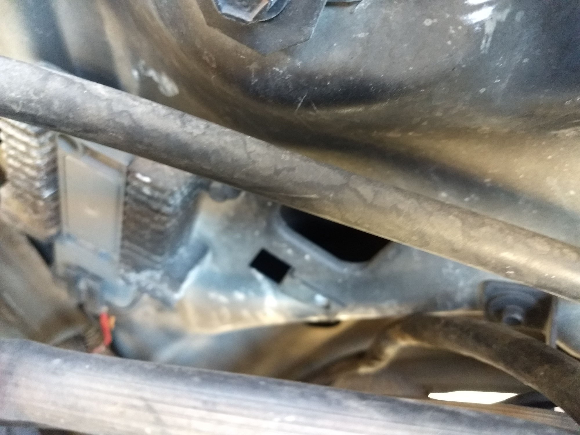

Well.. that is the most *******ized setup I have seen. You have a late model distributor that uses a remote TFI module.. the wiring harness that comes out the front of the distributor body goes to the fender module. But that isn't correct for a '90 it would have come factory with a distributor with a grey module on it's side. So the question is which one of those modules is actually connected? If the distributor has the correct PIP module inside then that black module isn't even connected to it. But if it is then that wiring harness coming out the front of the distributor isn't connected to the PIP module. Can you post a pic of the inside of the distributor?

OK that is what I suspected, the black module on the side of the distributor isn't even connected to the PIP module inside so it isn't doing anything.
So that means is somebody converted this truck to use a remote TFI, nothing wrong with that. And what I suspect is happening is that wire that you have disconnected over near the fender module is actually where the spout plug was, and with that circuit open you aren't getting any timing advance.. which would explain the serious lack of power.
P.S. You removed a couple parts to take those picture right? The plastic rotor button and a round steel rotor wheel?

Yes I removed them to get a better angle to it. So with the module on the distributor did I just was 1k with the shop? They spent 2months on a no start condition and said it was that specific piece. Also this wire was never connected when I bought this truck.
