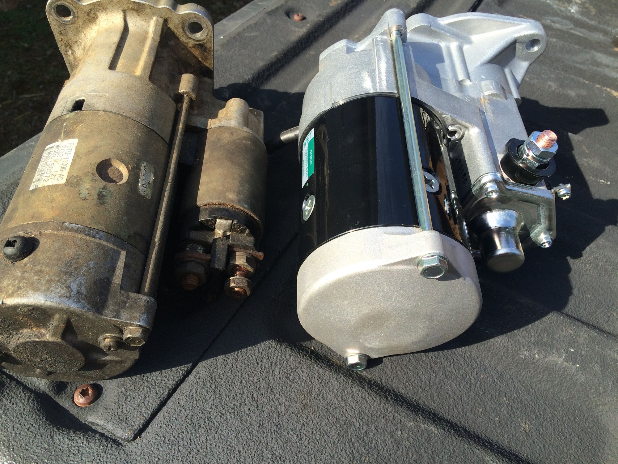

Looking for an education here. What is so much better about the denso? I put a starter in about a year ago and it looks like the design of the one on the right but is a cheap reman.

The DB electric and other cheap knock-off 'Denso-type' starters are JUNK. I tried that and after 3rd one only worked 12 times before crapping the bed - I gave up.
The Denso is a 5.4hp gear reduction starter. It requires less amps and therefore does not heat up as much. It also has superior bushings/bearings and HUGE contacts.
The contacts last 150-200k miles. The bushings will go 250-300k and motor should last 350k +.
You cannot get a 'rebuild' that will do this. This starter is by far the best bang for your buck IMHO.

Originally Posted by dn29626
Who is your source? Does it look like the OEM?
(I have a spare starter, but I no longer like it and do not want to have to reinstall it.)
Ive bought several from CNC Fabrication. Most come in 2-3 days after ordering.
This pic doesn't do it justice. The Denso motor is 2-3x bigger than most of the OEM options. It's a beast.
You know how 6.0's seem to spin really fast when starting? This starter spins 7.3's that fast.
