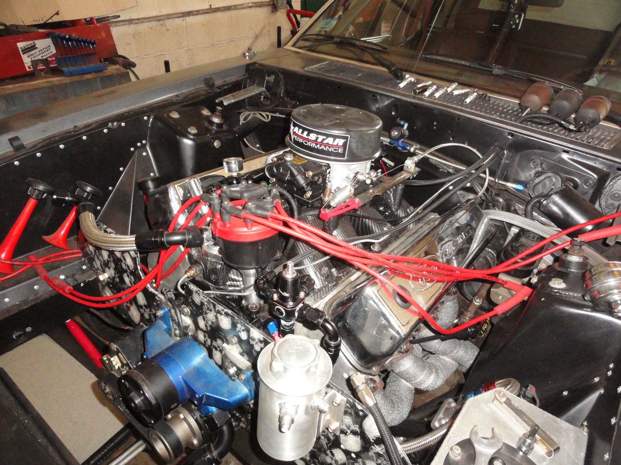

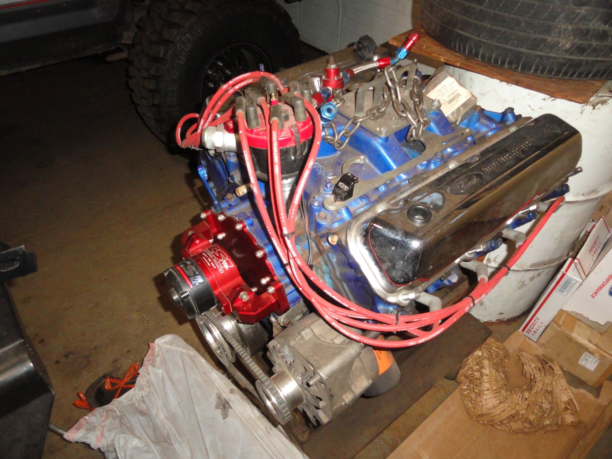

I have been working my *** off / deals / bartering off work for parts and friends looking out for me and i finally got pieces to this puzzle
its stock but its a DOVE block and heads
soon to be all blacked out

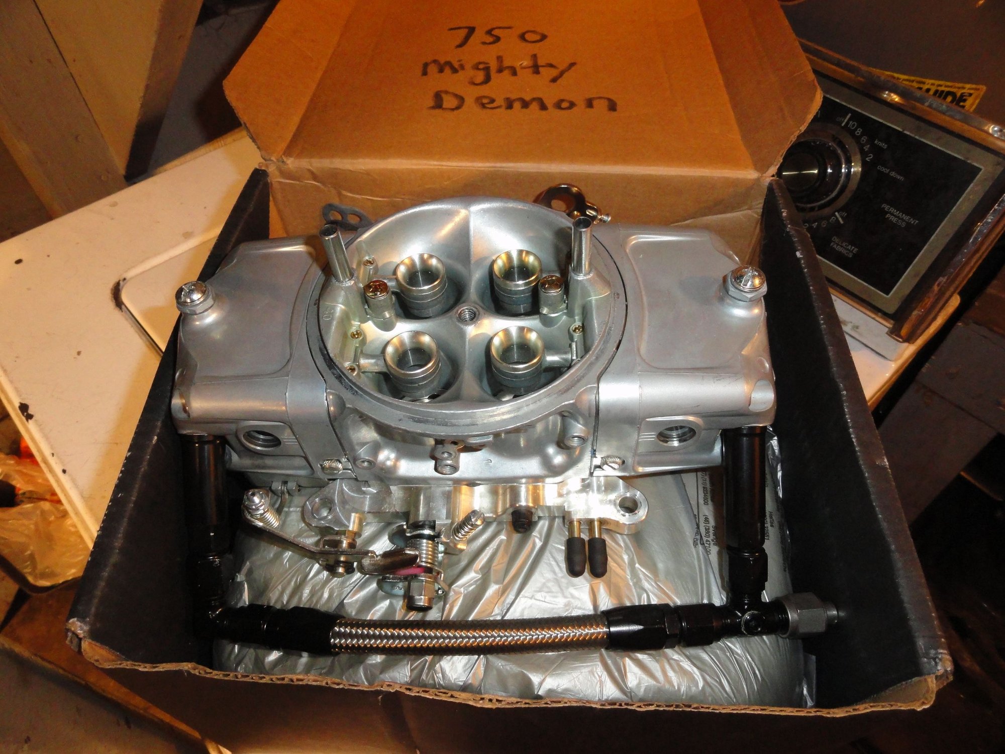

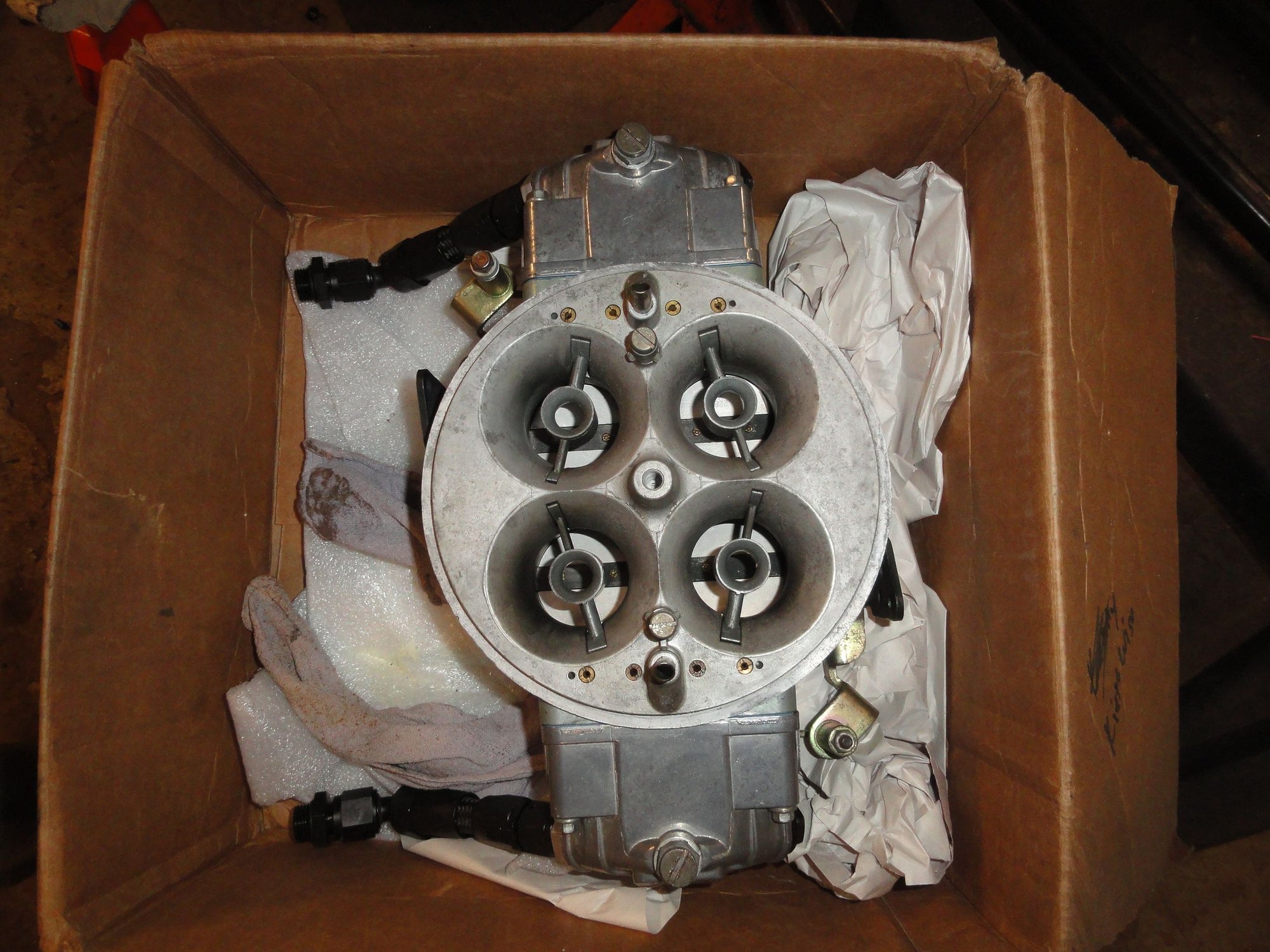

working out a deal for this carb

What size is the motor?
I ask because that 750 might be too large for a stock motor on the street.

yeah its borderline FuzzFace2...its a 460...i might have to buy a bumpstick for it
also you can jet the heck out of these carbs...we will see

It also does not have a choke so cold weather running will be fun....not!
if this is a street motor I would go for a 650. You will have better throttle response and I bet idea a whole lot better too.
Jetting is fine for the high speed side of the cab has nothing to do for idle side or throttle response.
You might be able to change out air bleeds etc but why when a 650 will be better.
Dave - - - -

The motor doesn't look stock (at least on the outside) so maybe a 750 is correct for it - but we can't make a recomendation on what is the correct cfm for the carb without knowing head flow (porting), compression, exhaust system, intended use, etc.
However, I think a 750 cfm is fine for a 460, even stock, if the carb has vacuum secondaries.
If not (if its a double pumper) then matching the carb to the engine is more important.
Also, I'm not a fan of carbs where the choke/choke-horn has been removed if the vehicle is street driven. Even in FL where is 80 degrees at 7AM the choke is needed to start the engine and help it warm up. If you live north of the 30 degrees longitude, you're going to want a choke.

i am getting such a deal on this 750 that i cant pass it up...i could turn this carb into a blow-threw carb...i do have a turbo laying around

Something that I've learned over time is when they say your carburetor is too big, that doesn't mean that it shoots in too much fuel. What they mean is that the holes are too big to make decent vacuum. You gotta have a certain amount of vacuum for the engine to run right.

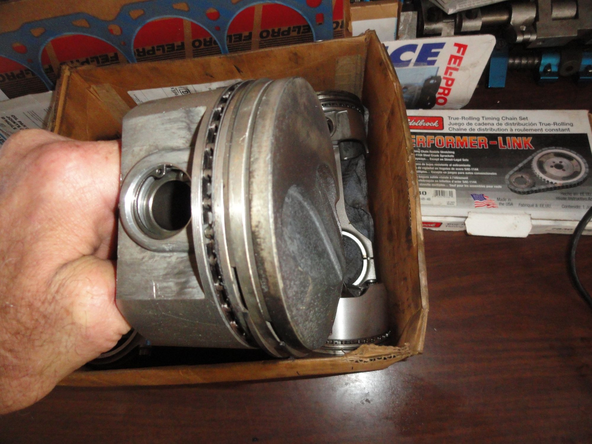

Old Aug 1, 2018 | 09:11 AM
SPL_PIMP's Avatar
SPL_PIMP
Joined: Nov 2013
Posts: 32
From: Monson Mass.

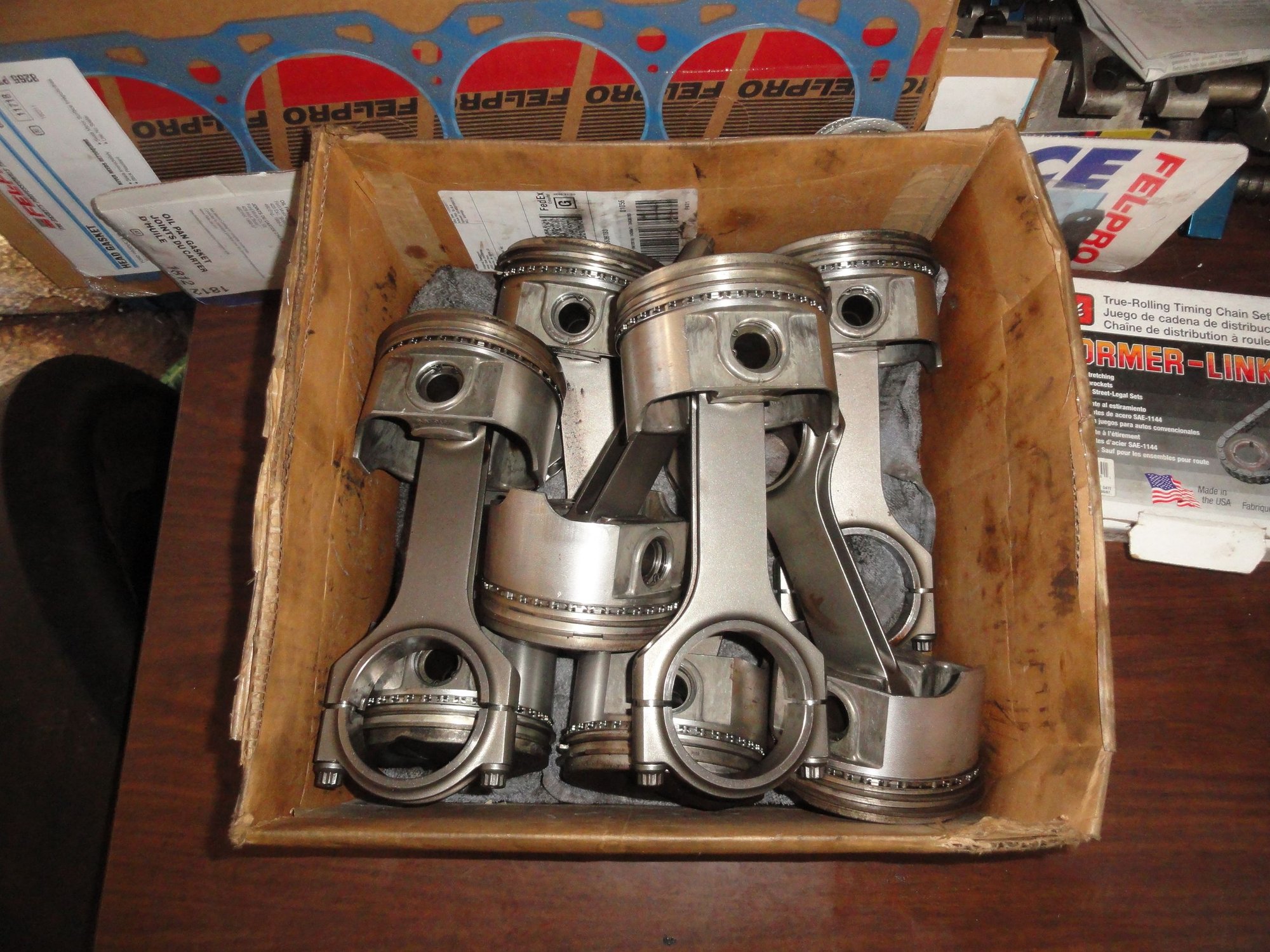

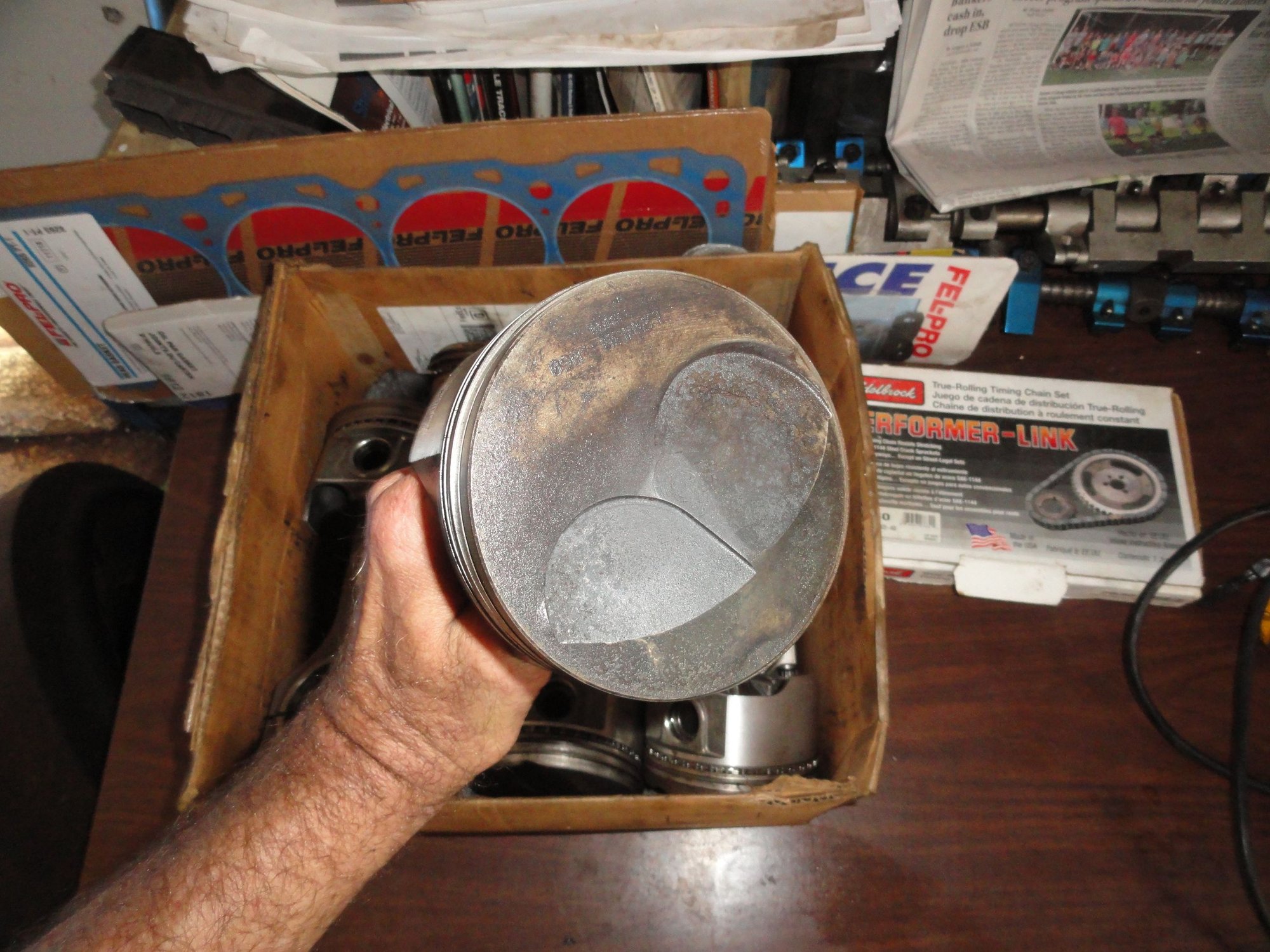

all right so i worked out a deal from this build that i did and got his whole rotating assembly with 12.1 comp pistons and a Dominator Carb...now we are talkin!
