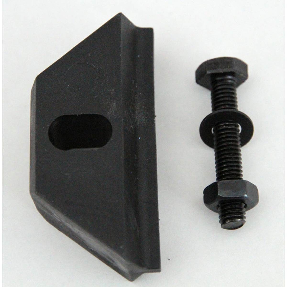

They have these at the parts stores.
That could work, thanks!
That was the type of hold down I was talking about.

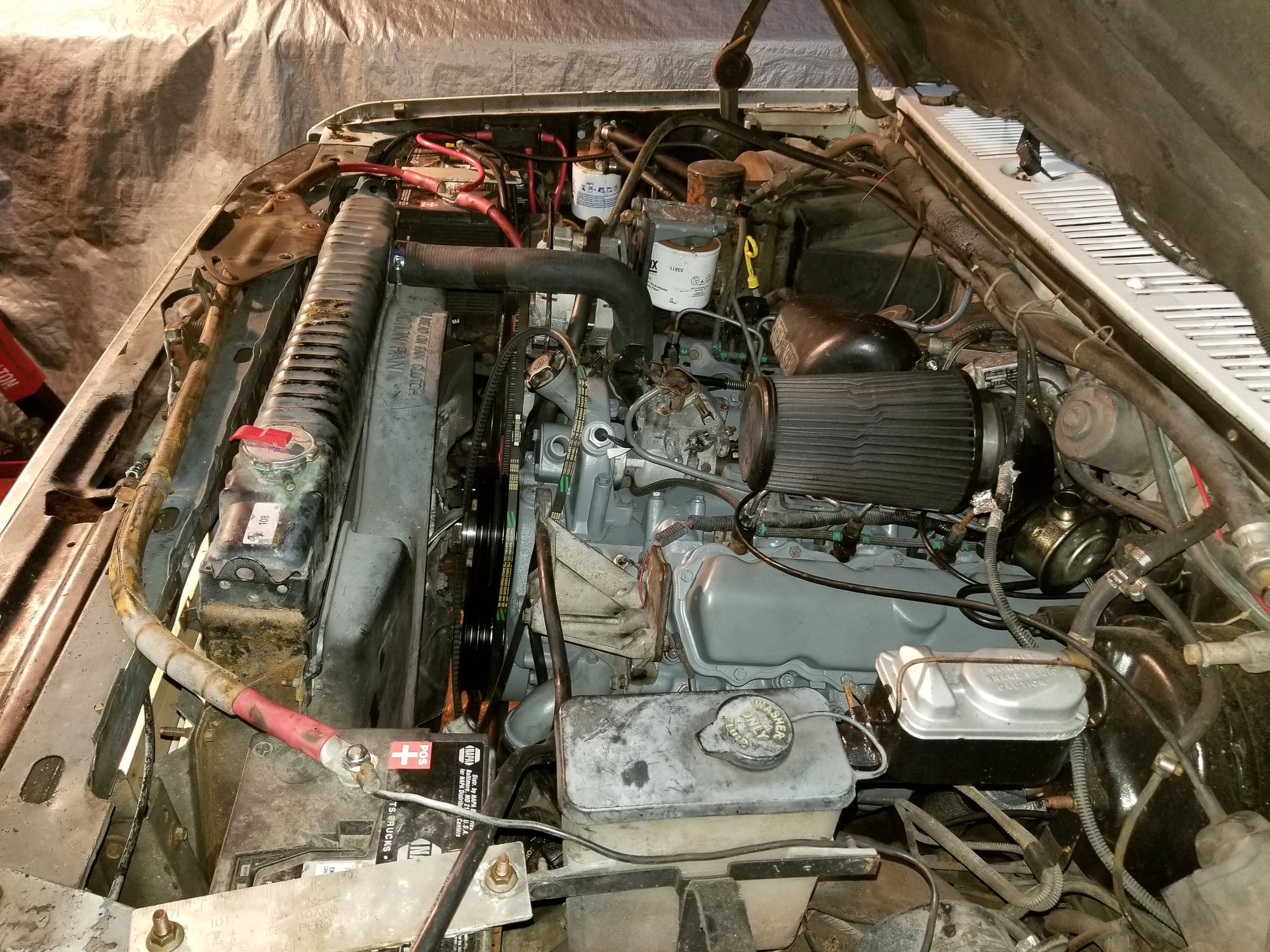

I used 4 wide hook vertical battery hold down rods, I think I got them from Bronco Graveyard (https://shop.broncograveyard.com/Bat...uctinfo/28064/). I see they now also make this style in stainless, nifty. Then flattened the bracket on each side off the radiator support to fit through the J bolt closest to the rad support, and lacking a proper hold down for the top I cut cut length off a crusty aluminum framing square, drilled holes in the appropriate locations, and glued a strip of old motorcycle tire tube onto the underside. Works great, very solid mounting. unfortunately my driver side battery tray has cracked in half and is thin. I'll have to weld it up and reinforce it or make a new one. Nobody makes new driver side trays.
In any event, not a great picture but you can see the hold downs.
