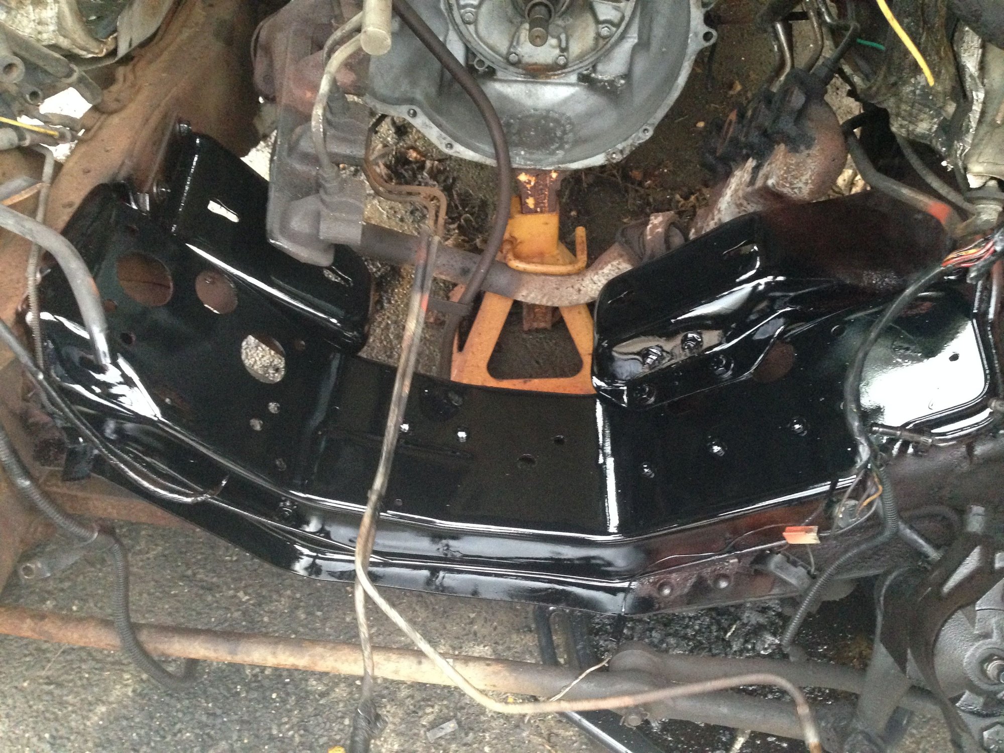

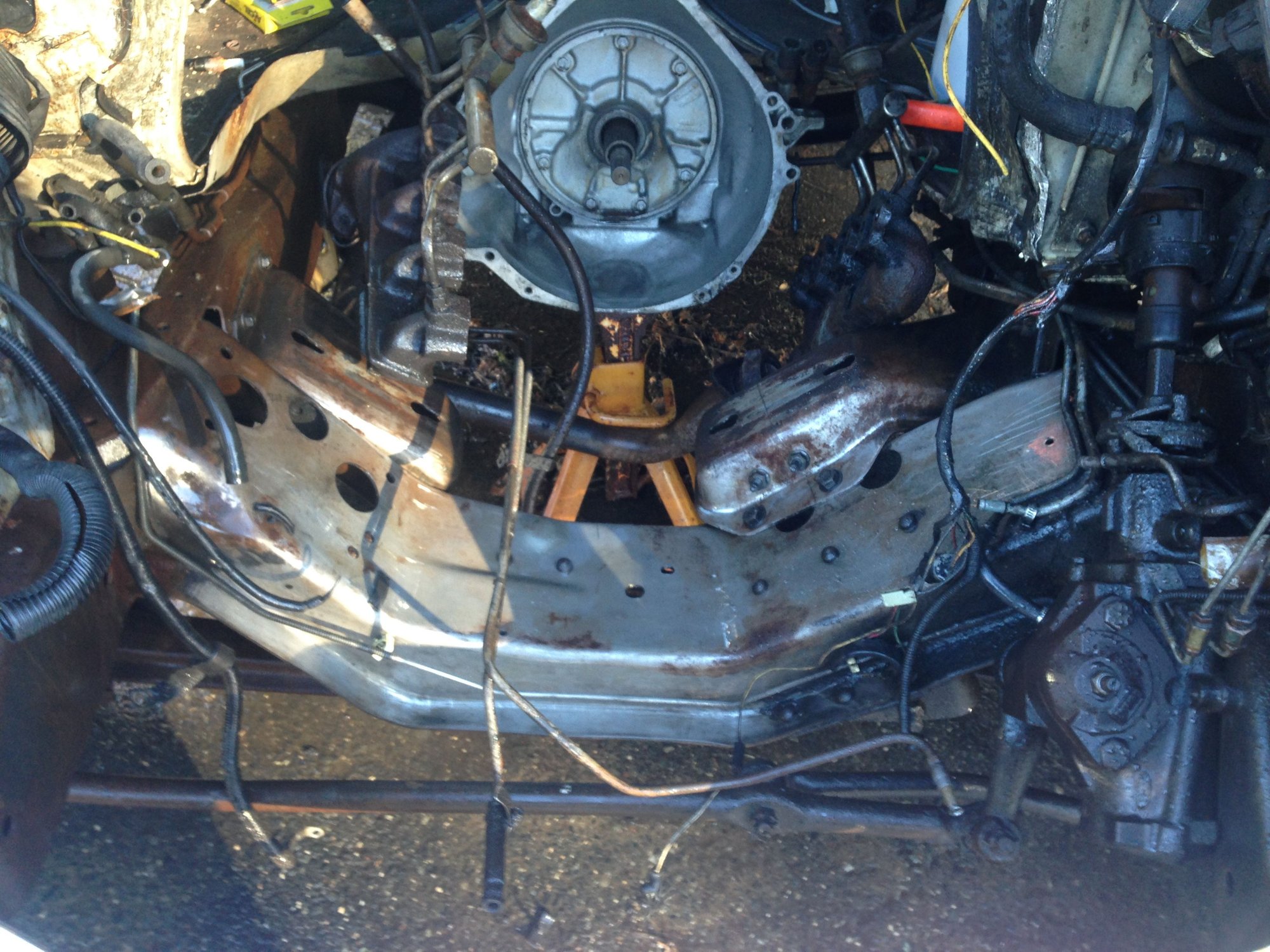

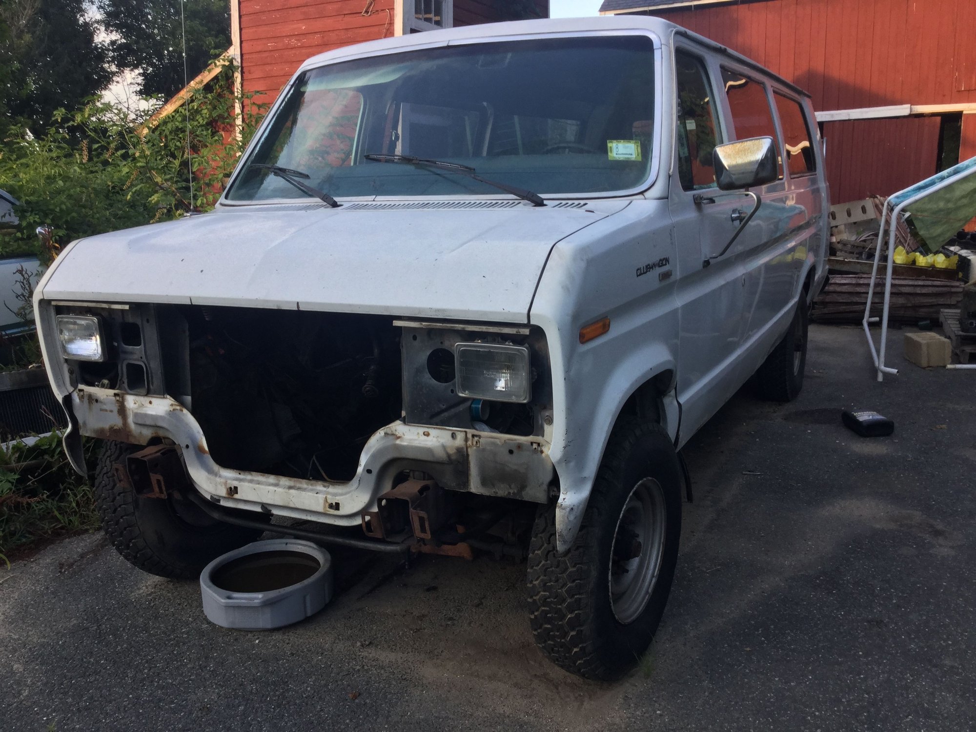

Here is a few pics of the project after I had already taken the motor out:

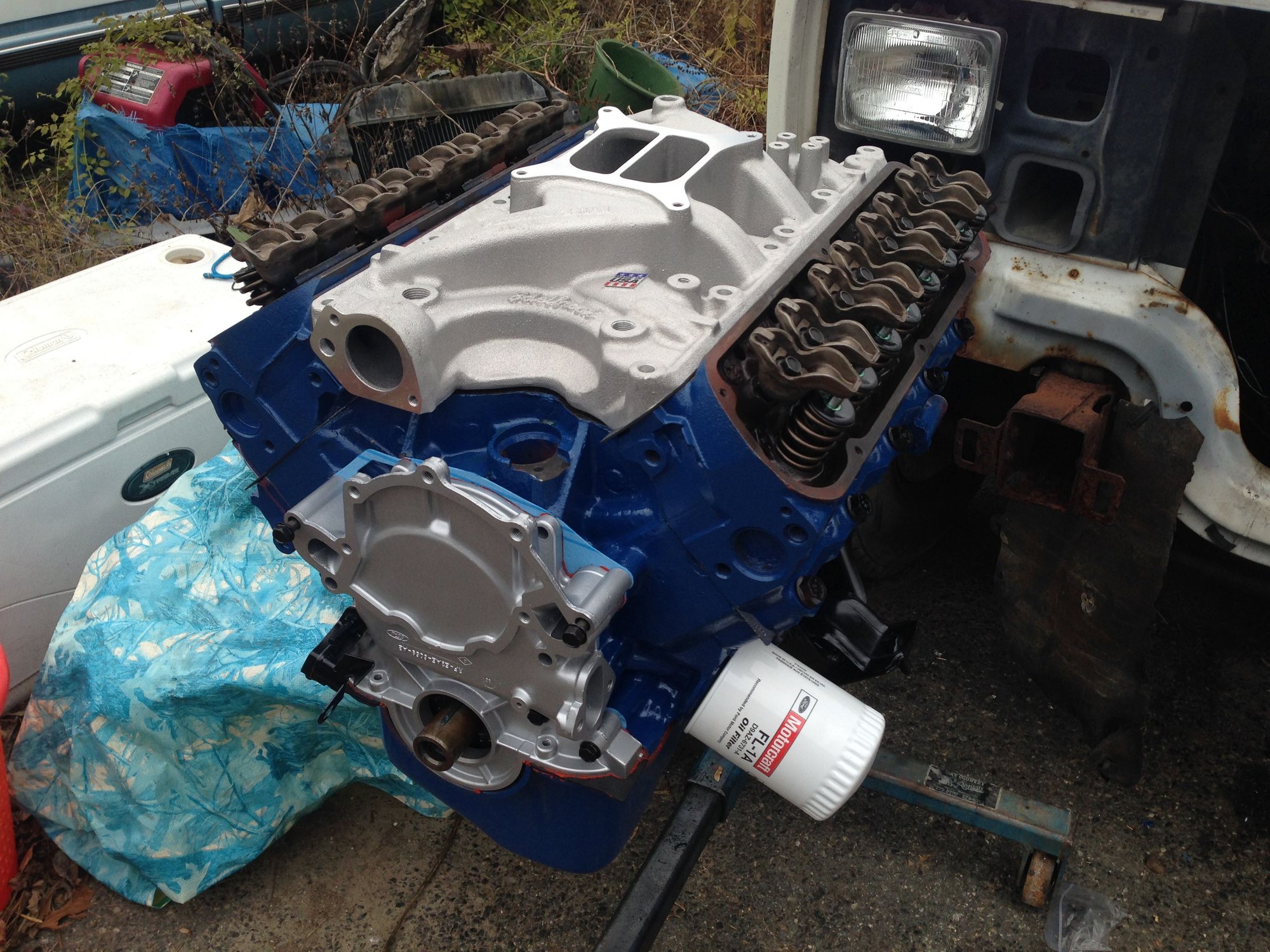

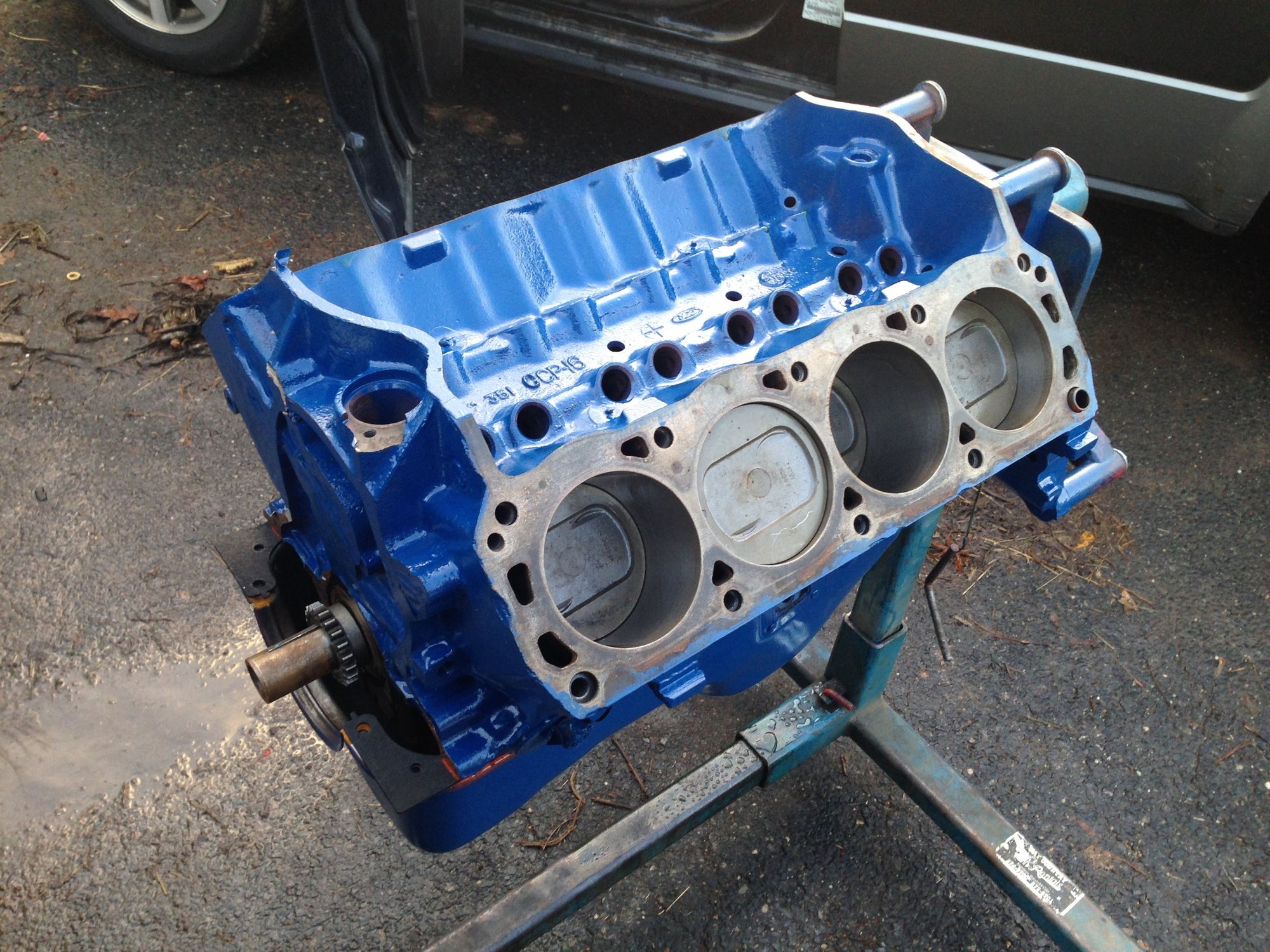

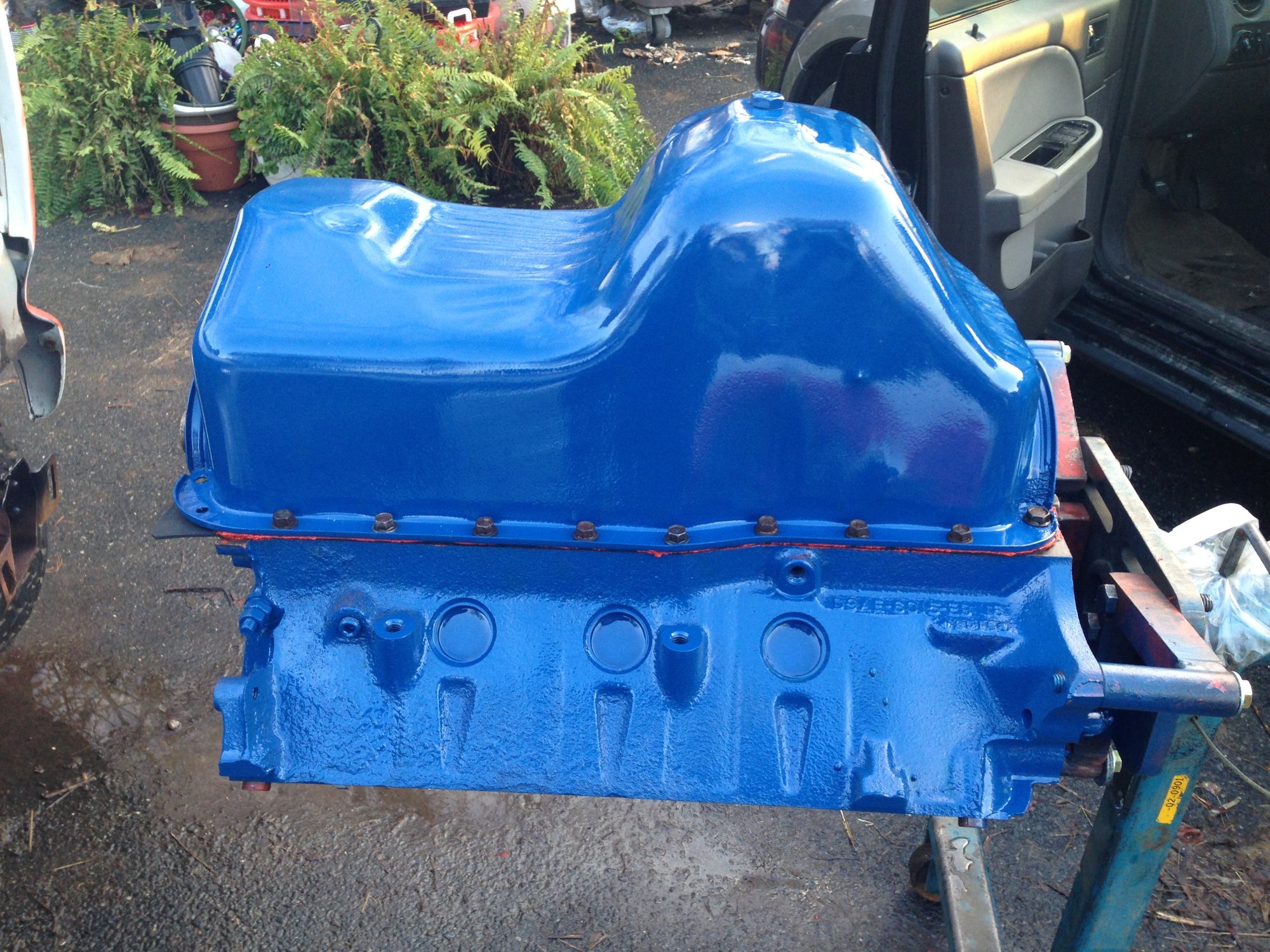

And here is some since rebuilding the motor (of course they aren't in order for some reason):
I managed to get the motor in by myself the other day and finally got the trans mated to it yesterday. All I have left to do (since I didn't take any pictures yesterday) is tighten up the transmission mounts for the frame, linkages and the stuff on the front of the engine.

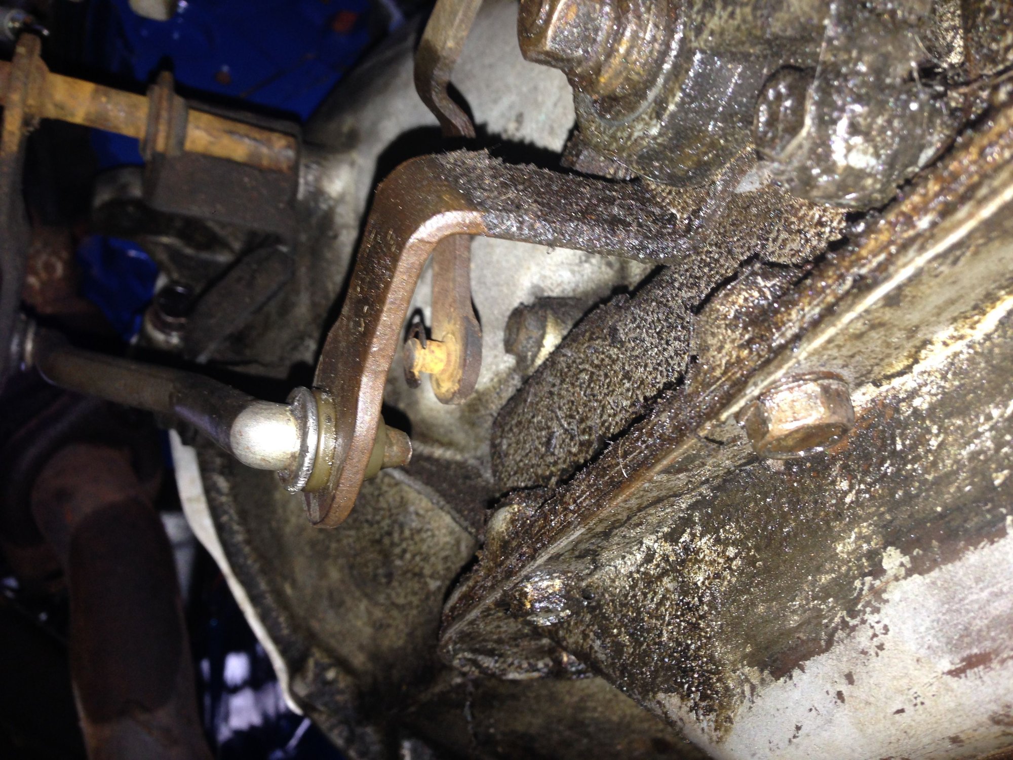

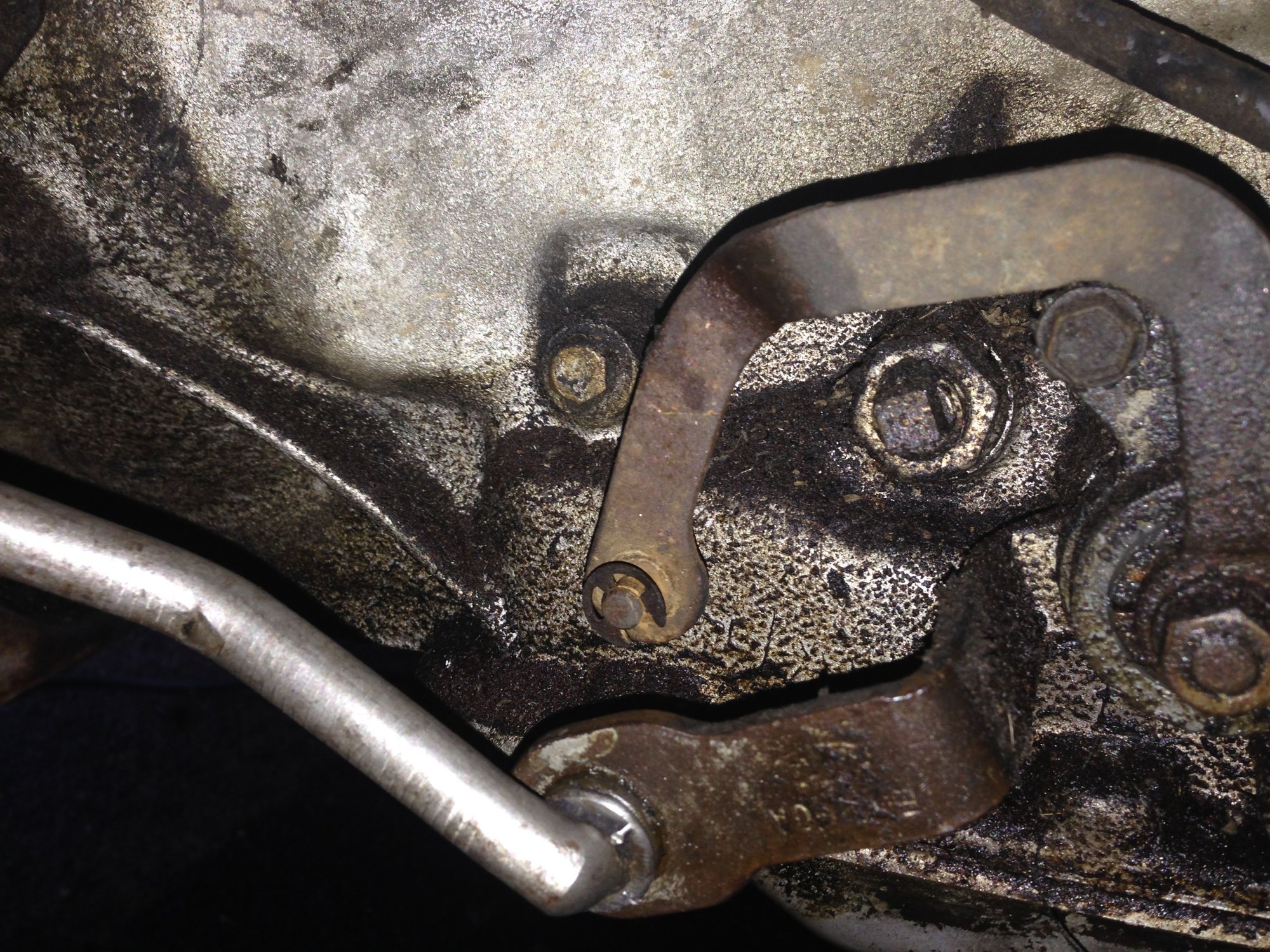

Do have one question for you guys.... Does anyone recognize this E-clip on the side of the trans?
I took it off of the trans when I removed the engine for some reason but for the life of me I can't remember what is suppose to attach to it.
Anyone have any ideas? Did I miss something like a cable that is suppose to attach to the C6 trans other than the shifter linkage?

That is your passing gear kick down. Should be a metal rod that comes from carb down to that linkage. If you did not get a carb set up for the ford kickdown it might not be able to be hooked up unless they sell an add on linkage for the carb. You can drive with out it. Mine has been off for years after I went to 460 and a holley.
Ok, I think I know which Rod you're talking about. I completely forgot about it sitting in the van, I'll see if there is any way I can put it on the new carb today when I go down there. Thanks for info moose
