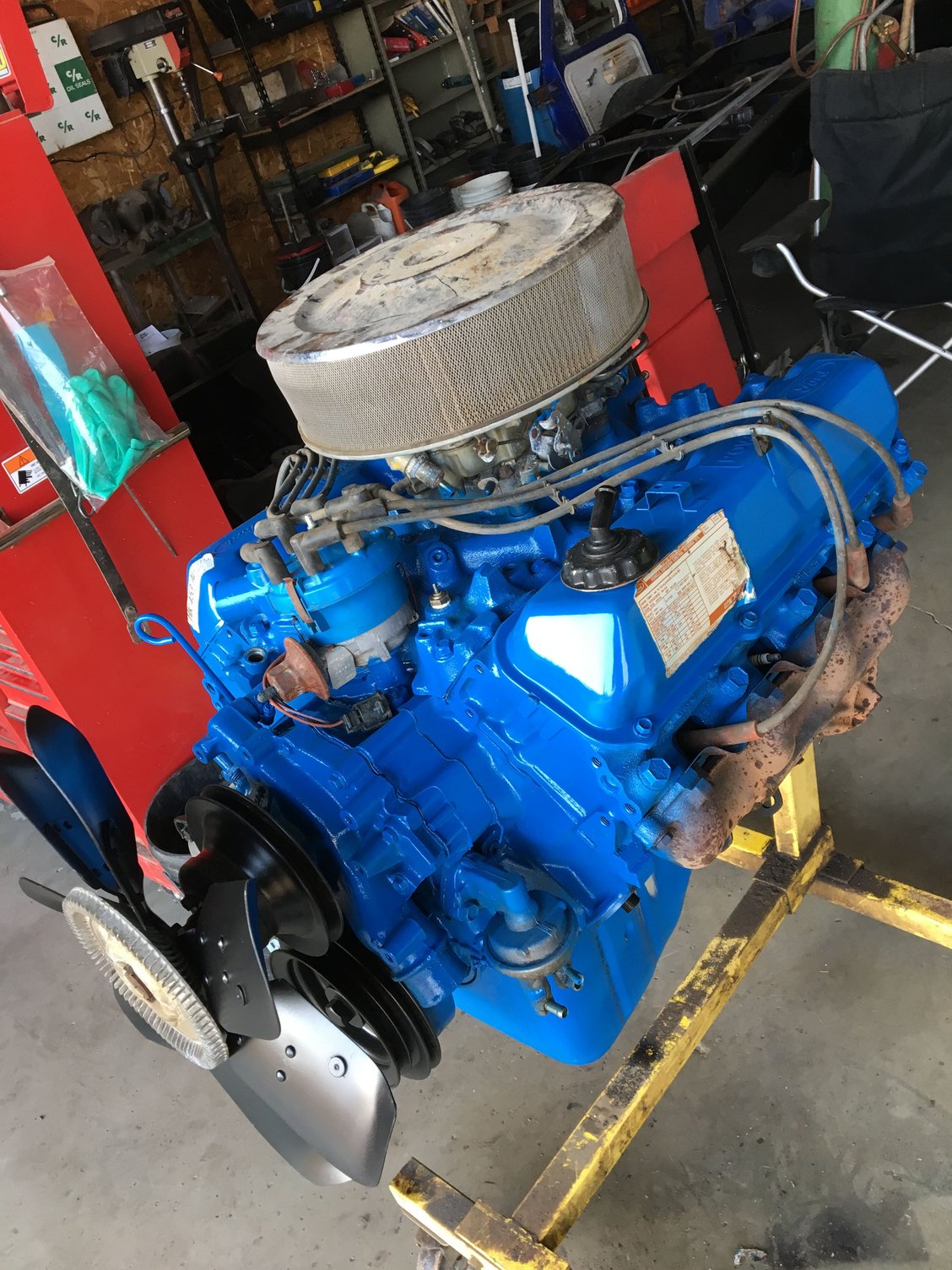

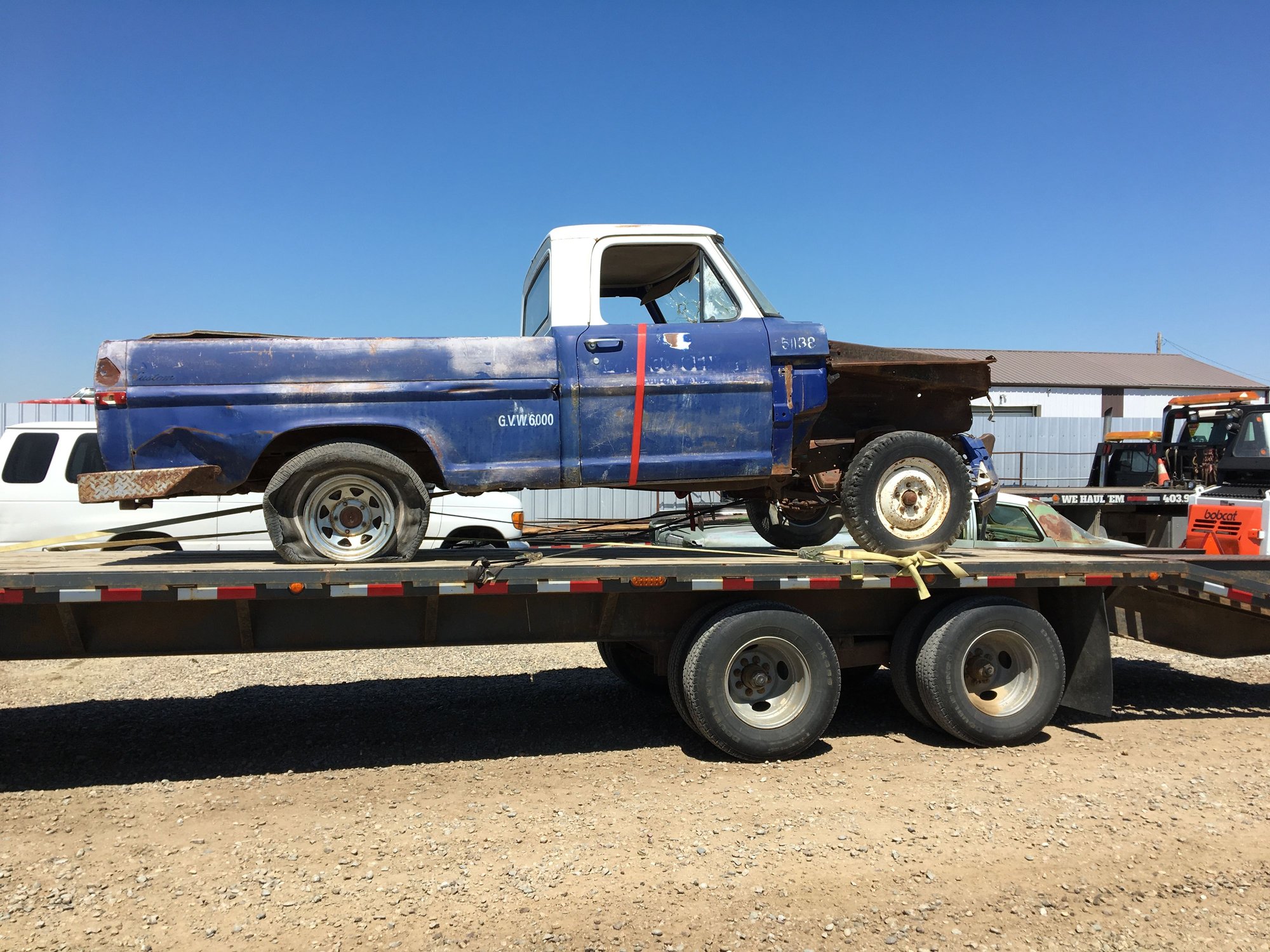

Basically I'm building a 71 f100 from scratch with "spare parts" and I have a 77 460 and it's paired 77 c6 I pulled from a grand marquis. I also have a c6 from a 70 429 Mercury cyclone, which both transmissions have the shift rod in the same location. I have a c6 from a 74 f250 2wd that of the 3 is the least likely to be any good. But the shift rod is in the proper truck location for the column shifter. I believe it's pointed more forward/up as the car ones are forward/straight down. Is the shaft easy to rotate or bracket easy to relocate to the proper truck location? What's the best option here...? as extreme low budget and rebuilds are an option.
